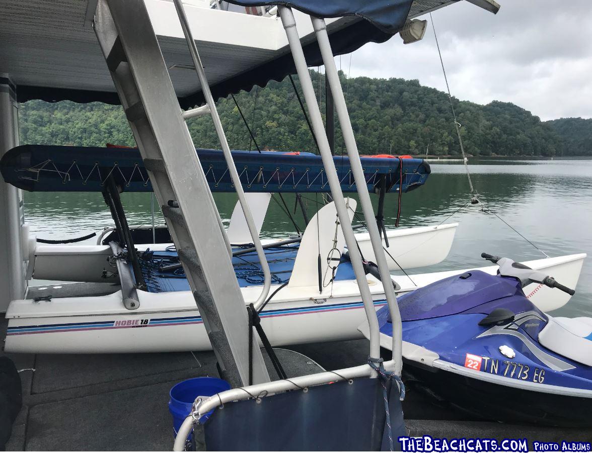

    I have sailed both Barren River Lake (Bowling Green Area) and Dale Hollow Lake (middle of nowhere). Barren is a better sailing lake due to flatter terrain, but we have a houseboat on Dale Hollow, so this year, I added a winch to the houseboat and the H-18 just fits on the back deck, mast up, (with some hanging off). There is one other guy on Dale Hollow sailing a Hobie Getaway from his Houseboat (keeps it on top somehow) and there are about 6-8 small cruisers. Otherwise, seeing a sailboat is rare on this lake; too hilly to get great/consistent wind - but better than not sailing at all!
    https://www.thebeachcats.com/gallery2/main.php?g2_view=core.DownloadItem&g2_itemId=134011&g2_serialNumber=3
