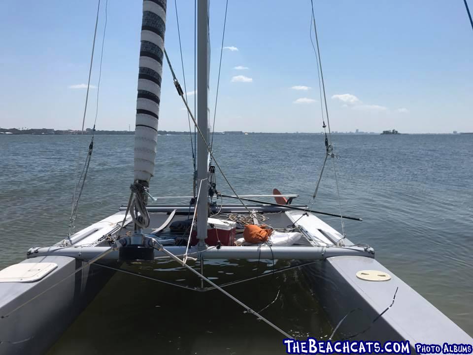

  • Could someone post a photo of what this looks like when completed correctly?

  • tblack88Could someone post a photo of what this looks like when completed correctly?
    Click on the image to enlarge and you can see a jib sheet preventer. So easy a caveman can do it . . .
    https://www.thebeachcats.com/gallery2/main.php?g2_view=core.DownloadItem&g2_itemId=29673&g2_serialNumber=4&g2_GALLERYSID=b44f1a2675043d9239cda95b12da258a
  • here the line (bungee) is attached to my bridal under my furler (i had a shackle there for rigging a spin)
    https://www.thebeachcats.com/gallery2/main.php?g2_view=core.DownloadItem&g2_itemId=134049&g2_serialNumber=3
    here you can see the see a bungee tied to my bridal that then is tied to my mast
    https://www.thebeachcats.com/gallery2/main.php?g2_view=core.DownloadItem&g2_itemId=134053&g2_serialNumber=3

    Thanks! that´s what I had imagined
