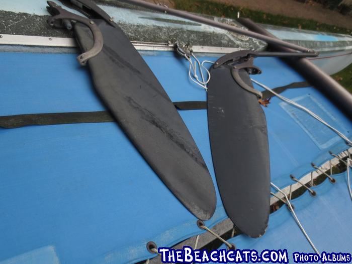

  • 1984 H18 magnum.
    The rudders were upgraded to the new system with EPO blades. It has plastic cams, & definitely the new style castings, using the adjustable aluminum plate in the upper casting.

    OK, so you really shouldn't be having any trouble, that system does work as advertised if everything is "factory" fresh and lubed.
    At this point your cams are probably buggered up, maybe something wrong with the cap/spring/screw in the castings. You've already cleaned and lubed so something aint right.
    Here's what I'd do, (did) to get things right.
    Remove everything from the casting including cams (carefully drill out the pin so as not to damage the casting), plunger, spring, and plastic screw.
    Throw it all away.
    Clean the castings, especially the internal screw threads, with acetone and a brush to remove everything that's not aluminum.
    Run a tap through the threads to make sure they are clean and smooth. This was not done at the factory so most casting threads were bad to start with.
    As you install all new plunger, spring, screw lube each piece with clean white lithium grease.
    Install new cam kit with the provided sister screws. Lube the cams with the lithium.
    It really is just a matter of making things really right, my rudders come up easily with the tiller bar and lock down solidly with a thump. If the cam gets turned the wrong way I can easily flip it back into position with the mainsheet.
    Note: Doesn't apply to you but if anyone a big problem getting the delrin screw out (common problem) I found that it is quite flammable icon_biggrin had one that got so carved up I couldn't get it to turn so laid the casting in a safe place and put a flame to the plastic, it caught fire and melted out, then ran a tap through to clean up the mess.
