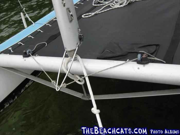

  • QuoteI just threw a boom on my 5.0 to gain better control of the shape of the main, and to give me an easier way to add mast rotation.
    I'm not sure a boom is an "easier" way to add mast rotation. I thought the boomed Nacras used the hardware to REDUCE rotation.
    The boomless boats (5.7 & 5.0) muse the hardware to INDUCE rotation.
    The standard rotation setup for the 5.7 & 5.0 is about as simple as it can get. You have a 2:1 purchase, & can easily crank the mast around for downwind. Just don't forget to undo it as your first step in higher winds, or you risk breaking the mast.
    This photo was the original setup & does not have the lines rigged properly. It should be a continuous line, dead ended at one of the eyestraps, through the end of the rotator wishbone- back through fairlead- through cleat- across tramp to other side-through cleat-fairlead-out to wishbone end-back to eye strap & dead end.
    http://www.thebeachcats.com/gallery2/main.php?g2_view=core.DownloadItem&g2_itemId=74457&g2_serialNumber=7

    That photo is how it is, except run a single line as described. You also need a small bungee, or line, from the end of the wishbone up to an eyestrap on the mast. Otherwise the wishbone tends to fall down. If you want to try it, I have a spare rotator, & I think I have a couple of the curved mounts/cam/fairleads that you see in the photo of my 5.7. The rotator is the one pictured here.
    http://www.thebeachcats.com/gallery2/main.php?g2_view=core.DownloadItem&g2_itemId=83065&g2_serialNumber=6

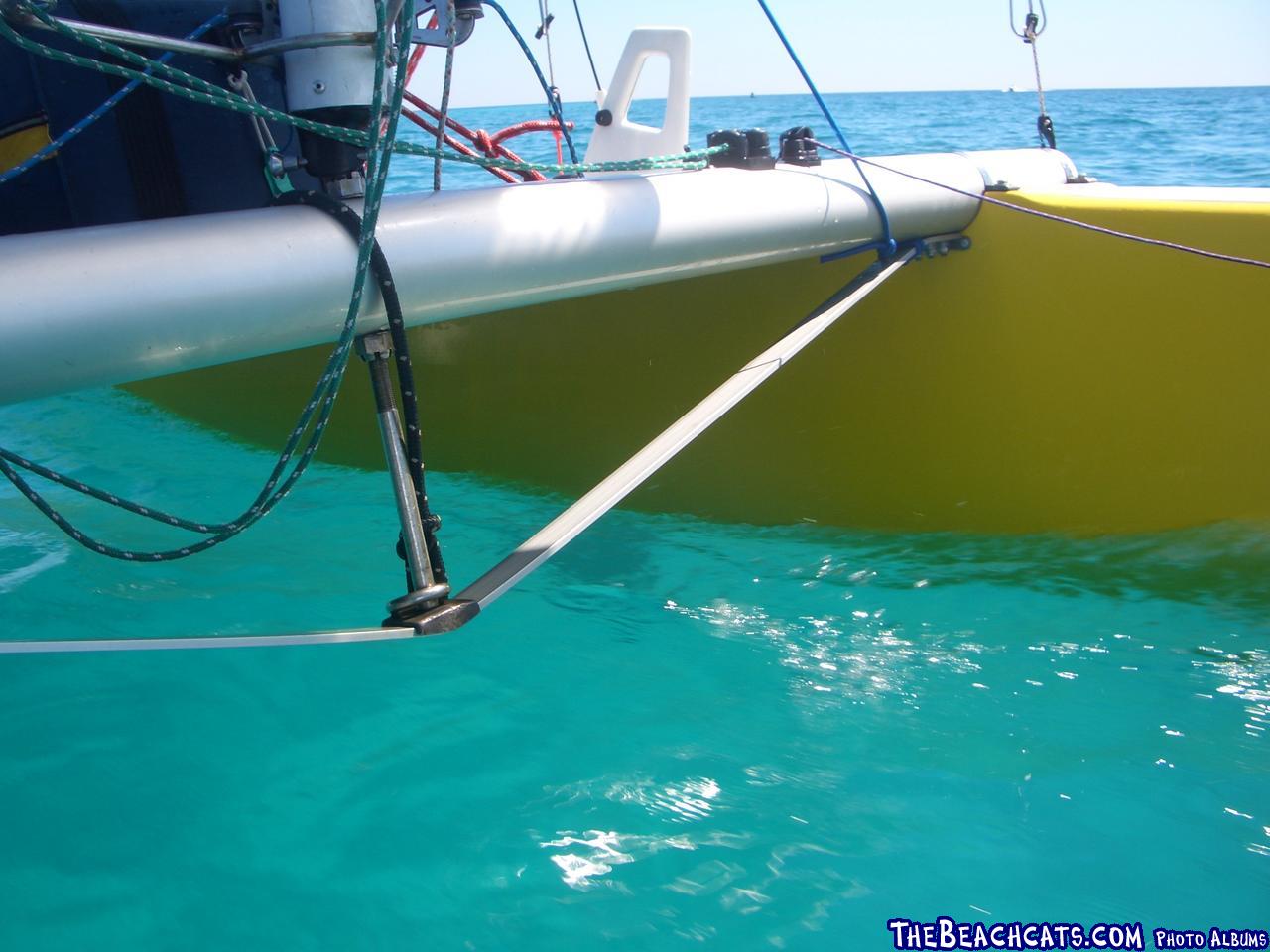

    Here is a 6.0 using it. Note he does not have the lines run in this photo, it rigs the same as I described above.
    http://www.thebeachcats.com/gallery2/main.php?g2_view=core.DownloadItem&g2_itemId=59705&g2_serialNumber=5

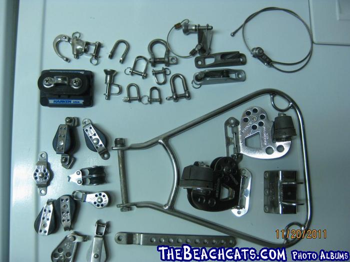

  • Adam,
    Here is a picture with the factory harken hardware.
    http://www.thebeachcats.com/gallery2/main.php?g2_view=core.DownloadItem&g2_itemId=29626&g2_serialNumber=4
