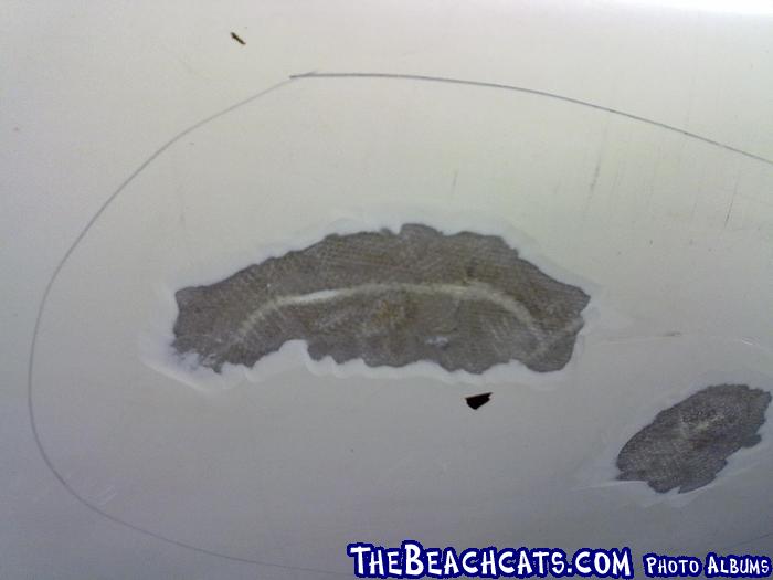

    I did not tie down my Inter and now I'm paying the price... Heavy wind blew her of the trailer and she took some damage on the right side hull. Here is a photo album showing the damages, I will update as the repairs go on: http://www.thebeachcats.c…ictures/?g2_itemId=91098
    I was watching the West System video on youtube for idea, but was wondering if it is really nesseceary to get that invasive? http://www.youtube.com/watch?v=i97TlAdenv4
    I was hoping to get some assurance on how to proceed before I cut the hull open. There are a few spots where the outer skin has turned white http://www.thebeachcats.com/gallery2/main.php?g2_view=core.DownloadItem&g2_itemId=91108&g2_serialNumber=4
    Should I just grind the outer skin away and relaminate new skin? Or should I make a hole, a backing, new core and skin as per video?

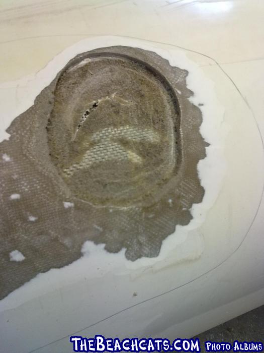

    In the most damaged area the core has allready been ground away, here I was wodering if it would be possible to laminate on the existing inner skin? From top to bottom the ground area is 10 cm/ 4 inches long
    http://www.thebeachcats.com/gallery2/main.php?g2_view=core.DownloadItem&g2_itemId=91117&g2_serialNumber=4

  • Hey Christian,
    It's hard to tell from the photos the location of the damage, which look fairly common. First thing you might want to do is locate your bulkheads. I have a document/file that maps the location of all the bulkhead on the Inter 20. If you will PM me I will send it to you.
  • I fixed a similar ding on a 5.7, without cutting an access port. By cutting away the damaged material I ended up with an opening about 2". I used a piece of plastic juice jug, with 2 layers of wetted cloth. If you are really evil, use a laminated photo of your ex, or your boss,(if you really dislike them), there might be some satisfaction of having them cooped up in a dark, damp, sweaty stinky hull!
    Fold it like a Taco shell & insert. The juice jug plastic will pop back to its original shape once inside the hull. A piece of nylon cord, or fishline was attached to the middle of the plastic backing. This could be pulled to force the patch against the inside of the hull til it sets up. You now have backing, add a layer of cloth to the outside, & you are ready for gelcoat. Be sure the outside layer finishes below the original gelcoat,(squeegee excess resin off) so as to leave 1 mm or so to blend the patch gelcoat even with the original.

  • ch_kurkio,
    i am making the very same kind of repairs on an Inter20 myself right now. on the advice of a professional fiberglass boat repairman, i left the core material in place and did not cut large holes. he does this and uses the core material as the base for his resin & fiberglass mat & cloth build-up. on another boat i have, i cut out the damaged core material and i was sorry i did. it's not always necessary and i doubt if it's stronger than leaving the core attached.
    what i have done is saturate the core material with resin, working it into any cracks. on top of that i started laying up cloth, then mat to build up thickness, then i finished with cloth which doesn't leave those fibers sticking out all over. after it hardened, it's as stiff and hard as the surrounding hull and sounds just the same when i tap on it with my fingers.
    on those shallow scratches, it would be best to get in at least one layer of fiberglass cloth before you gelcoat.

  • Thank you everybody for your help, especially Philip for sending the info on bulkheads.
    I uploaded more photos in the album showing how the repair is coming along.
    I did cut a hole in the location where I had allready cut the material away, and made a backup piece. The backup was a 4 layer piece, laminated on the hull. Should have made it 2 or max 3 layers, the 4 layer piece was less than 1 mm thick and supringly stiff and durable.
    In other areas the top skin was sanded away and new glass layers laminated and now sanded as well. I also put some gelcoat filler on some smaller scratches.
