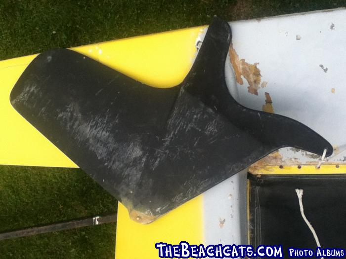

    Put a 15" crack atop one hull which I'll need to reinforce. Jammed 2 liter bottles into the 4" inspection ports (waiting for new ones to be delivered) which worked pretty well, but we still took on a couple gallons of water. Need to create a way to keep the rudders down.
    Worst news of all? One dagger board thing came untied, dropped through the hull and was gone long before we noticed.

    I *might* know where we lost the center board - we sailed to the Provo River mouth to pick someone up off a kayak and when coming about, I felt some slight resistance while passing near some reeds. But with the current and a 100,000 acre lake...I doubt it's worth going back to look (though I will anyway just to get the thought out of my head).
    In the mean time, we'll get another manufactured. Is there a best place to buy epoxy and tint for new gelcoat?

  • halliske...see it one of the "regular" cats dagger board is the same. IMO.. In those days parts were often "lifted" from other boats.
    I posted a few photos & descriptions of rudders and center board at http://www.thebeachcats.c…ictures/?g2_itemId=87625.
    http://www.thebeachcats.com/gallery2/main.php?g2_view=core.DownloadItem&g2_itemId=87837&g2_serialNumber=4
    http://www.thebeachcats.com/gallery2/main.php?g2_view=core.DownloadItem&g2_itemId=87846&g2_serialNumber=4
    Anything look familiar to you guys?

  • I think is more of a centerboard than a Dagger board. Probably rotates to the up position and maybe even kicks up if it hits something. Never seen one like that though.
  • QuarathI think is more of a centerboard than a Dagger board. Probably rotates to the up position and maybe even kicks up if it hits something.
    That's right. And we successfully built a new one this afternoon! Oh, it's good to have friends with great power tools. It's all cut out, planed, routed, and sanded. Tomorrow I'll pick up some tint for the epoxy and we'll glass it.
    Many other great fixes on the way as well!!! I'm pumped. We may get it finished up tomorrow and looking much better than ever!

  • I would consider making 2 new ones while I was at it and save the original for a template.
    bananaboat
  • I agree with HULLFLYER if you have the tools to make a new one that quick you might as well make 2 and get all the glassing done at the same time and save the original.

  • QuoteThat's right. And we successfully built a new one this afternoon! Oh, it's good to have friends with great power tools. It's all cut out, planed, routed, and sanded. Tomorrow I'll pick up some tint for the epoxy and we'll glass it.
    Glad to hear it. someone did that with plywood on my old cat before i bought it. They just painted it white and left it. It worked great i never bothered to modify it. Must have been marine plywood.
