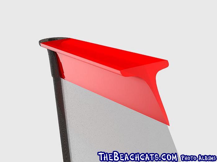

    Take the autoinflate mechaism from a pfd and package it in a tight hardshell package (maybe auto airbag material) shaped to match the contour of the front of a mast tip. Then just adjust the depth required to inflate to like 10 feet to avoid accidental deployment.
    For square-top sails I always thought a float like this could be developed.
    http://www.thebeachcats.c…ictures/?g2_itemId=12206
    http://www.thebeachcats.com/gallery2/main.php?g2_view=core.DownloadItem&g2_itemId=12219&g2_serialNumber=7
