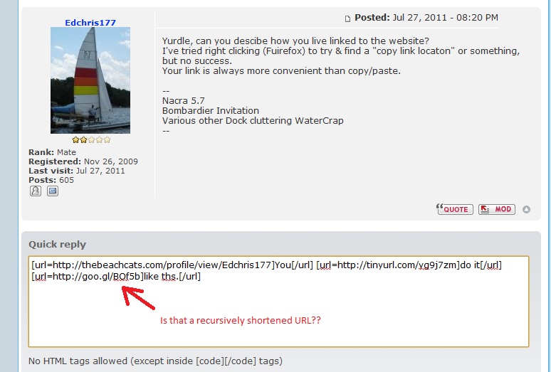

  • Yurdle, can you descibe how you live linked to the website?
    I've tried right clicking (Fuirefox) to try & find a "copy link locaton" or something, but no success.
    Your link is always more convenient than copy/paste.
  • You do it like ths.
    Rob
    OKC
    Pile of Nacra parts..
  • In FF just highlight the entire address bar, copy/past into the reply window and use the URL button below.
