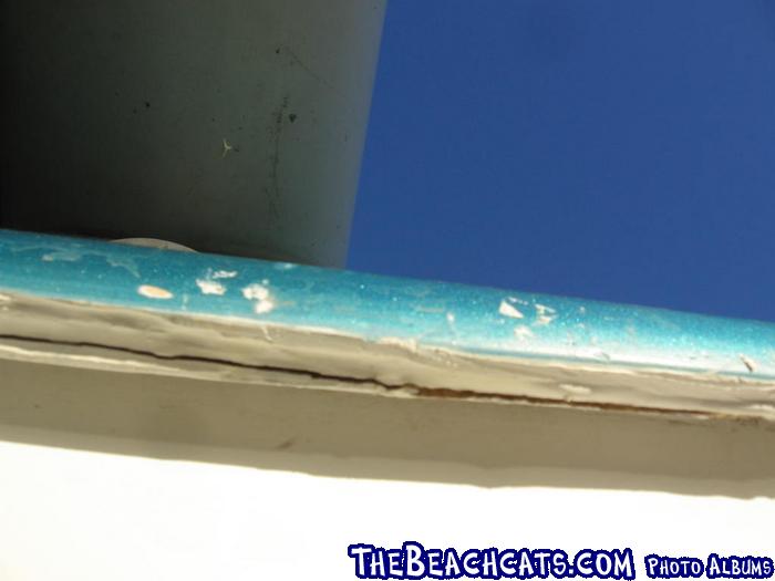

  • Last Fall my newly aquired Prindle 18 took on water in both hulls and I barely made it back to the boat ramp. After finally getting the boat loaded up on the trailer I discovered the starboard hull was separating between the upper deck and the lower hull in the seam behind the rear crossbar on the inboard side. I never did find any place the port hull could have leaked.
    Last month I finally had time to do some repair work. I rebedded all the gungeons and replaced both drain plug assemblies. I used a dremel tool and cleaned out the seam and filled in the gap with Marine-Tex and used clamps to hold it together until it dried. Afterwards I pushed around on the repaired and area and I was sure it was fixed.
    Today I found out I was wrong, very wrong. I took the boat out in 10-13mph winds and everything was going well for around thirty minutes. The boat was fast and responding well and life was good. Then I realized the dolphin striker was splashing up water more than earlier. After looking around I realized the boat was sinking..yet again. I was around half a mile upwind of the boat ramp. Sitting all the way to the forward crossbar of the port hull I managed to get the boat back to the ramp. By that time the starboard hull was all but under water. I dropped the sails as my friend went to back the trailer so we could load up the boat. She was having a tough time backing so I went to help guide them down the ramp. With the trailer finally in position I turned around and the boat had rolled over with the port hull in the air, all the starboard hull but the very tip of the bow was under water and the boat was trying to slide into deeper water. It took everything I had to get the boat righted then back on the trailer. Sure enough the same seam had split open and allowed water in the hull. It took around 20 minutes for the water to completely drain out once it was on the trailer. The port hull had taken on some water but not nearly as bad. Now I'm looking for some good advice on to make strong solid repairs. What kind of materials will I need? I'm suppose to take the boat to the Texas coast in two weeks but now I'm afraid the waves and wind will be too hard on the boat. I've been fortunate so far but I'm not willing to press my luck. I took pictures of the seperated seam but not sure how to load them in this post?

  • Thanks everyone for your help and info. I created an album in Beachcat members photos: Steve's Prindle http://www.thebeachcats.c…pictures&g2_itemId=73203
    It shows pictures of the splitting seam.
    coastrat I checked out your album. Your finished Prindle looks great!! After viewing you album I have a much better idea on how to make an injection repair. Do you think I would need to reinforce the area on the upper edge (curved area) of the bottom hull with a couple of layers of 2" fiberglass tape (on the outside) since it seems to be that area that is separating/flexing? Should I consider adding some type of SS fastners through the seam (deck to hull) to prevent the hull from separating under load? Or do you think the injected epoxy would be enough to stiffen the area?

  • use a combination approach: drill the resin holes only deep enough to get to separated area(not through bottom layer) about every 2 inches. hole size just slightly larger than syringe spout. inject resin til it flows out adjoining holes and cracks. use a course threaded drywall screw with a small pilot hole to tighten upper to lower. let cure to hardened. remove screws and fill screw holes with epoxy/sillica mix, also top off drill holes with epoxy/sillica mix. you can/should use epoxy/sillica mix but its pricey and you need access to west marine. i used regular resin on deck lid repair for shortage of epoxy. you can tap on area to hear loose spots, make sure you get it all filled in. that should do it. notice blue tape around all repair areas, this keeps resin off of hulls and makes for a clean repair. i'm going to post some pics of the west systm epoxy and syringes. i'm not the best teck manual writer so if you have ?'s i'll send you my cell no. and i can walk you through it. i love the smell of resin in the mourning!

  • I've done two repairs of hull/deck separation. A P-16 last summer and another this Spring. Last summers repair was tested for full day & boat had no further failure. 2nd one has not been tested. I flipped boat upside down, injected West epoxy with no colloidal particles with large (35 cc) syringe into all seperated area. Webbing tie-down straps were then tightened every 10" of separated area. Next day another coating of epoxy on entire crack area to seal it. Repair area was about 4-5' and boat was hard sailed a week later with no problems. 2nd one of more extensive separation has not been tested yet. Pete
