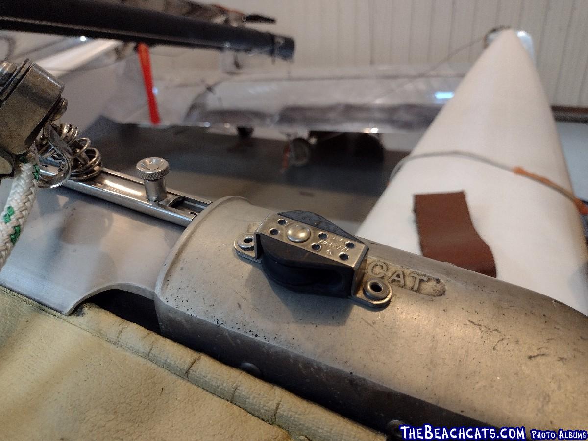

  • Both of my old Hobies have the old style traveler, where you have to pull a pin and slide it in the rail, and then lock it down again. I went through my junk collection and with the exception of the traveler cars and one swivel cam cleat mount, I have everything I need. Here are my pulleys riveted on to turn the traveler control lines 180 degrees from the jib car:

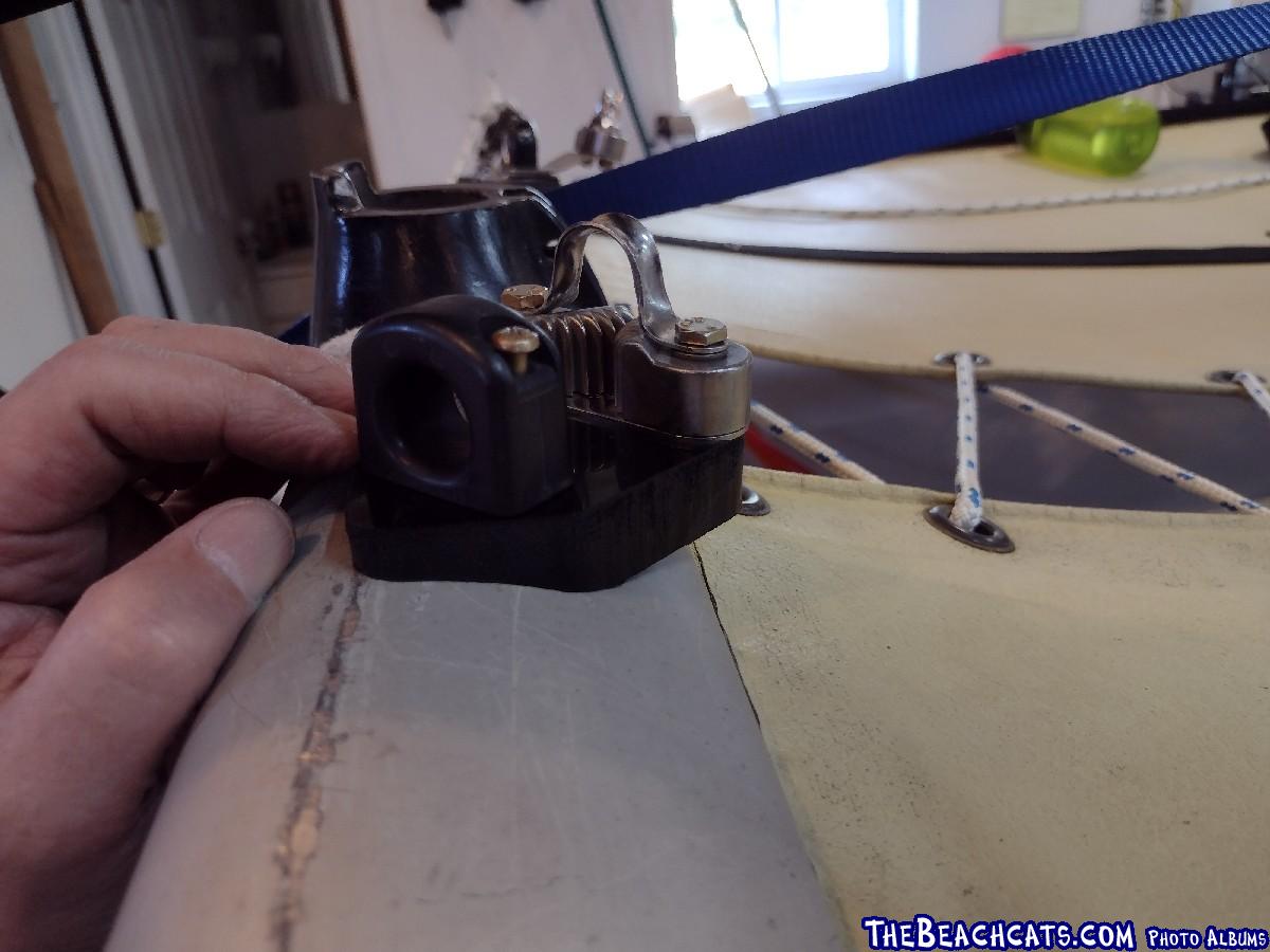

  • Here is the port swivel cam cleat for the jib sheet:
    https://www.thebeachcats.com/gallery2/main.php?g2_view=core.DownloadItem&g2_itemId=136754&g2_serialNumber=3
    And the starboard side:
    https://www.thebeachcats.com/gallery2/main.php?g2_view=core.DownloadItem&g2_itemId=136755&g2_serialNumber=3
    For those who want to try this at home, the center of the swivel mount is 24" from the casting. The front of the swivel mount is in line with the forward side of the traveler track.

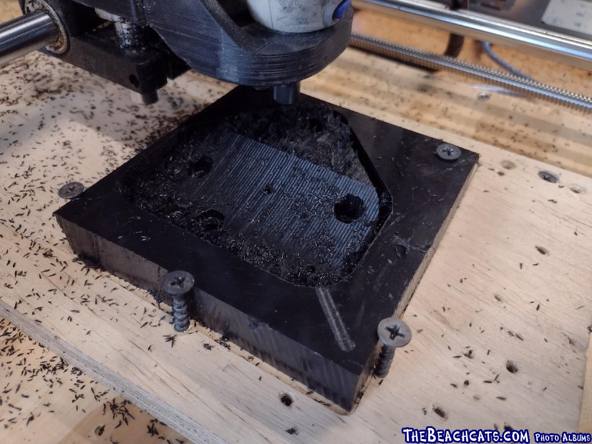

  • My kid designed a fixed bullseye and cam cleat mount for me. Here is the first one on his little CNC router that he built.

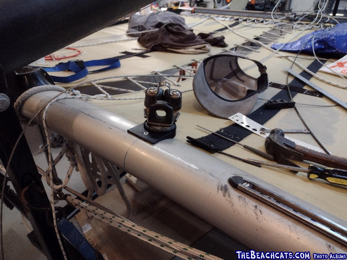

    https://www.thebeachcats.com/gallery2/main.php?g2_view=core.DownloadItem&g2_itemId=136762&g2_serialNumber=3
    Fit check - looks good. The cam cleat was from the old style traveler.

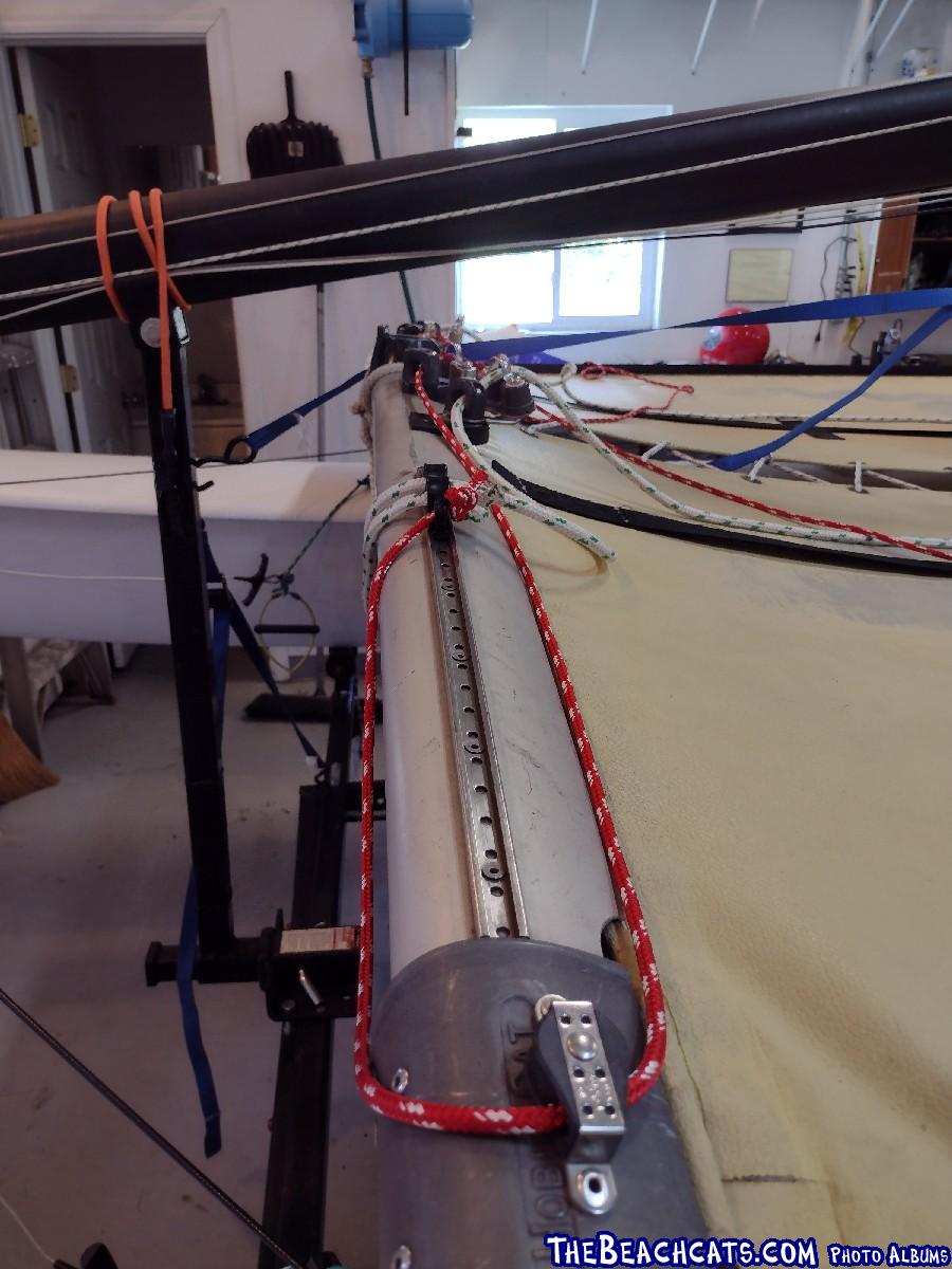

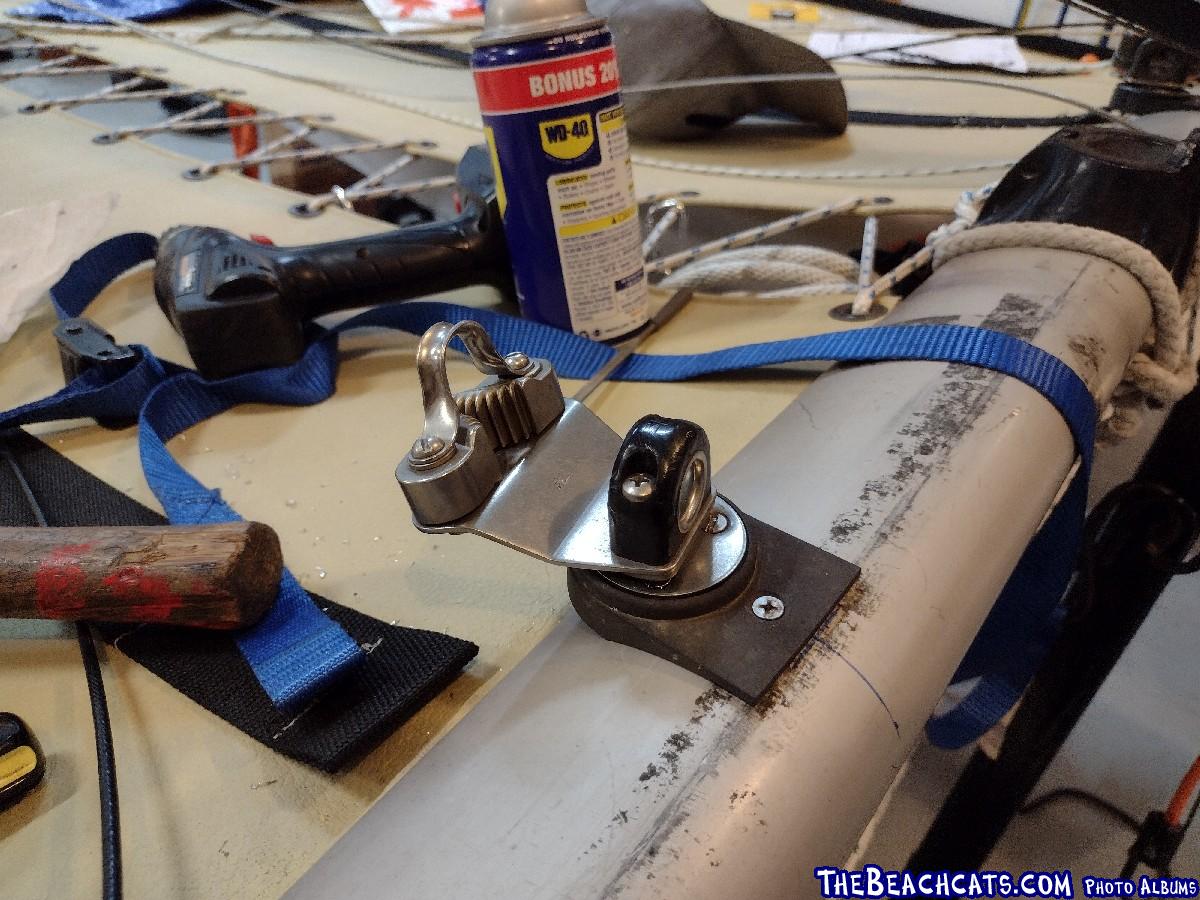

  • Ok guys, this project is done for the moment. I find that sitting in the hangar with the mast down, I can't get the lines to cleat in. Is that because we need sails pulling on them? Or do I need a better angle between my stationary bullseye & cleat? Note that I put the bungee on after I took this picture.
