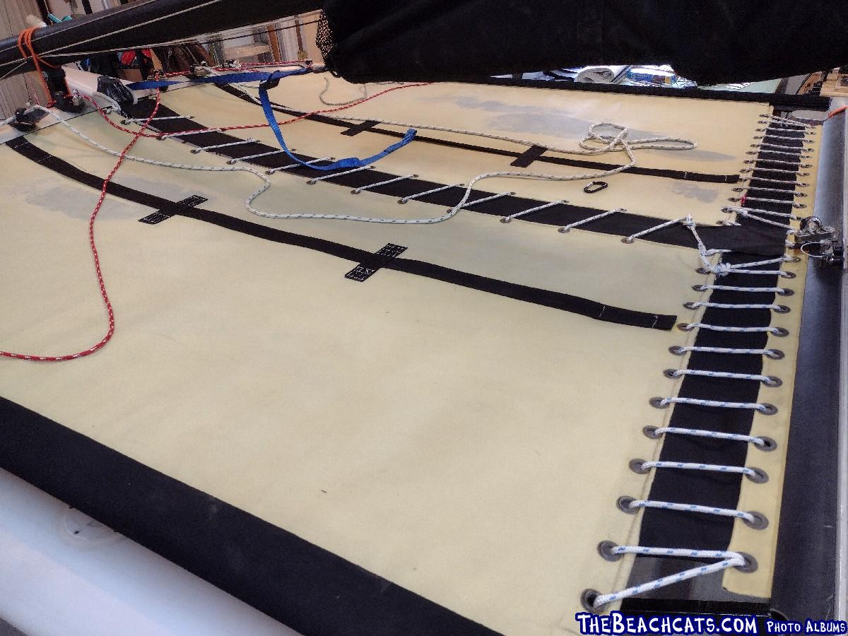

  • We always seem to be losing the main and jib sheets through the lacing on our trampoline. I had seen this idea somewhere so I implemented it. Had some leftover Sunbrella from the sail bag. There is velcro holding it at the front, and at the sides for the aft piece. The middle and aft piece velcro together as well. Came out pretty good.

  • I have done this on a Hobie 18. Works great to keep water from spraying in colder conditions too.
  • Standard fair on my Hobie, but only held on at front and back with lacing and woven through the tramp lacing. I made a copy out of sunbrella, but it didn't stay in place well. Yours should do better. Its annoying fishing the sheet back in...
    My new, homemade one piece tramp came out well, but is a hair short, so I have to do the same, only at the front. Thinking its a good time to add some cooler anchor points onto it, then weave it into that front lacing.
