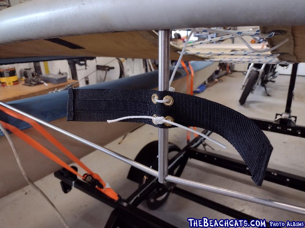

    Some more new catamaran sailor questions here. First, I made up some webbing to hold my righting line to the dolphin striker. A few grommets to tie it to the dolphin striker, and some velcro to hold the loops of rope.

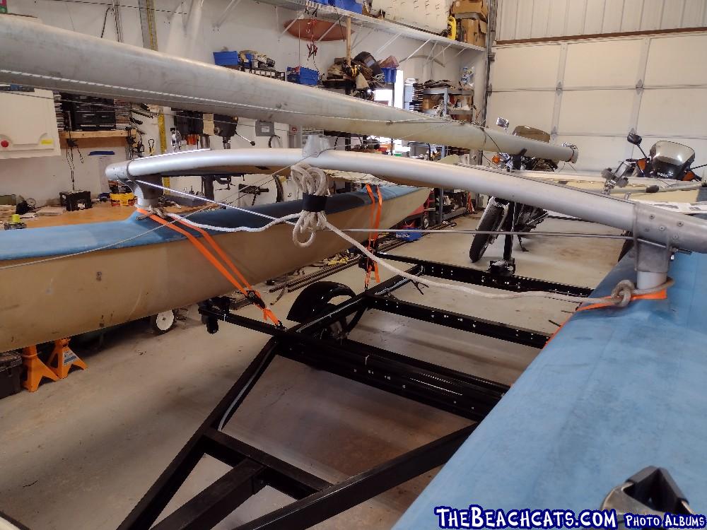

    As I've been looking around the web, I initially thought the righting line should be tied to a front corner and then routed over the up hull. But then I've seen some references to tying the righting line to the dolphin striker. Is the dolphin striker strong enough for that? It would give me more effective rope length. This is what I currently have:
    https://www.thebeachcats.com/gallery2/main.php?g2_view=core.DownloadItem&g2_itemId=134945&g2_serialNumber=3
    With this setup I'd have to untie the bowline on the up hull and then pull it through. If I was tied to the dolphin striker I'd just have to undo the velcro and pull it through.

    I'm concluding that I don't like having the line secured with that velcro strap. I'm more worried about it coming loose while trailering than while sailing.

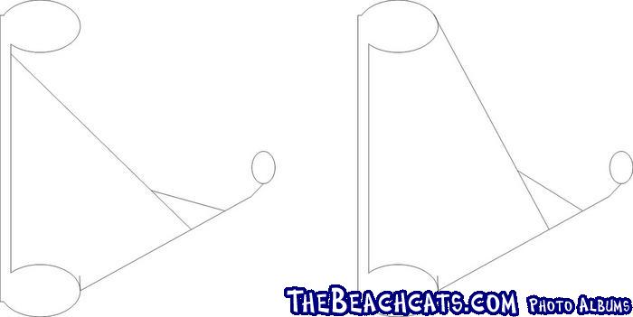

  • QuoteTossing the line over the hull makes it easier on your arms, but it doesn't _actually_ give you mechanical / leverage advantage.
    I don't quite understand the geometry of this, goes against conventional thinking. I once had two righting lines on an 18 ft cat, each one was secured under the tramp at the corners and standing on the hull when we did capsize the line was right there. I did not throw it over the hull but with 2 of us the boat righted with ease.

  • QuoteI don't quite understand the geometry of this,
    https://www.thebeachcats.com/gallery2/main.php?g2_view=core.DownloadItem&g2_itemId=134961&g2_serialNumber=4
    https://www.catsailor.com…eads.php/topics/239287/1
  • From the perspective of bringing the boat upright from the capsized position, the only thing the boat “cares” about is the position of the crew’s center of gravity. Quite simply, the farther you get your weight outboard from the lower hull, the more readily the boat will rotate about the hull and turn upright. Where the righting line is attached to the boat makes zero difference - the only thing that matters is the location of the CG.
    From the perspective of crew comfort while hanging on the righting line, the attachment point makes a difference. The tension on the line equals the crew weight divided by the cosine of the angle that the line deviates from vertical. The greater the angle (i.e. the lower it is attached to the boat), the greater the tension on the line and the greater load you will feel on your arms, hands, and legs.

  • You sliced and diced my post and missed the point.
    From the perspective of the boat rotating ~90 degrees from capsized to upright, it makes no difference where the line is connected. The CG is all that matters.
    From the perspective of the person(s) hanging on the line, it makes a difference. The higher up/farther outboard the line is mounted, the easier it will be on your body.
    Over the hull for sure.

  • There’s something else to that equation: the righting moment is not affected if the line goes over or under the hull, as long as you are standing on the other hull. That is because the line tension is an internal force of the system boat + yourself. But as soon as your feet leave the boat and your body starts hanging from the line, it does make a difference, because now the line tension is a force external to the boat and with a changing angle. Perhaps at that point it doesn’t matter because you already passed the hardest part, but anyway. If you are pulling the line from another boat, for instance, it also makes a difference.
