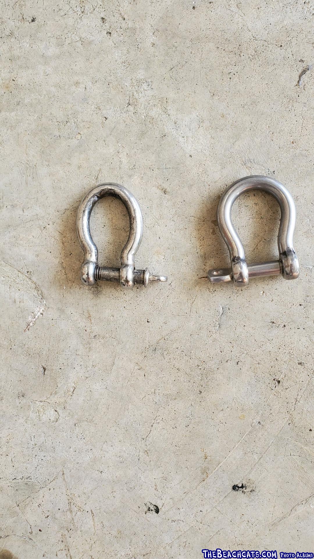

  • For me, the gin pole makes setting my mast as fast as the 16's I see done by hand, but I think mine's more stable/predictable/easier. But that's my 2c, and after inflation is worthless...
    Mine is stabilized like the EZ-step from start to finish. What I HAVE noticed is that I have replaced two 5/16, forged bow shackles that have warped, which is dang scary when you consider what they're rated for. Only thing I could think is that the gin pole may not be tall enough at first, so I'm going to start using an 8 foot ladder to improve that first angle. The initial loads on the forestay are pretty high until you improve the angle when the mast raises past about 10-12 feet in the air. At least on mine. I'm assuming that's how the shackle warped and not from tensioning shrouds...

  • Here's a picture of the last one - comparison with a new shackle:
    - Bent two of them that way; Harkens, both.
    https://www.thebeachcats.com/gallery2/main.php?g2_view=core.DownloadItem&g2_itemId=135167&g2_serialNumber=3
