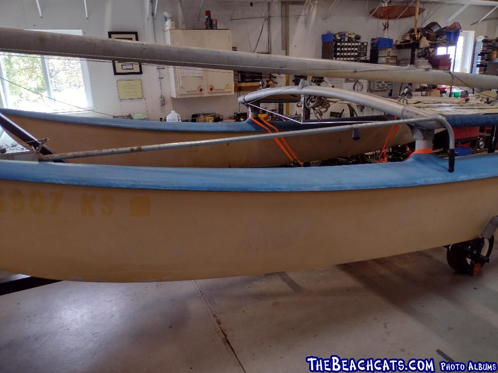

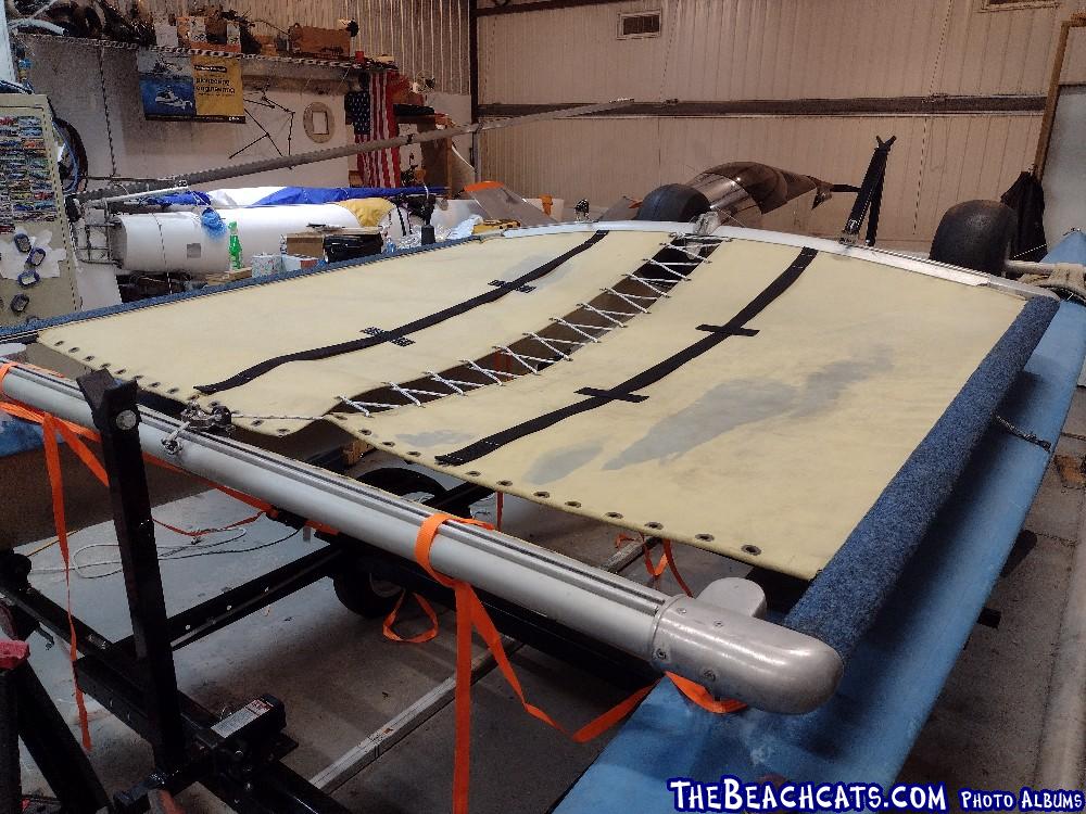

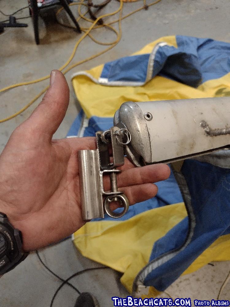

  • Just bought a cheap ($400) Hobie 16. It's mostly complete but missing some parts on the traveller and needs some new lines. The tops of the hulls are a little soft. I plan to sail this while I get my SC17 going.

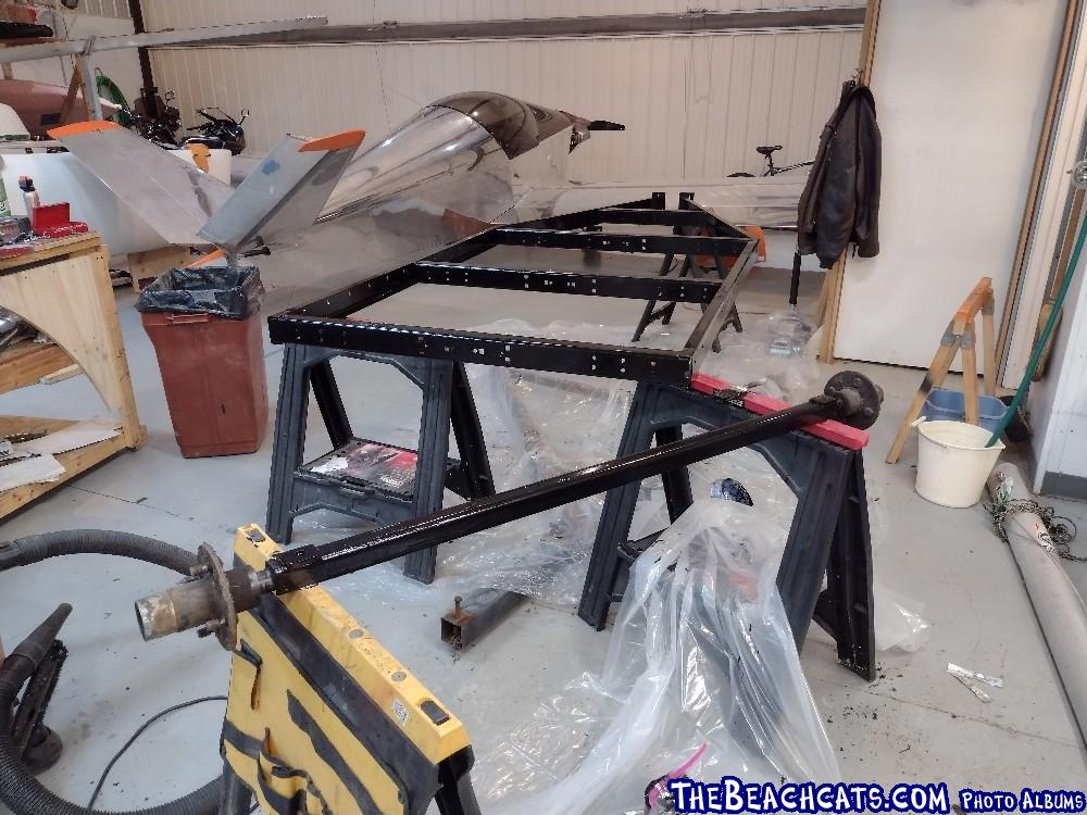

  • We got our trailer registered. It has a few issues:
    1) the crossmembers that hold up the hulls are bent. The story was that some kids were using the trampoline as a trampoline and bent them. We need to straighten those, de-rust them, and paint them.
    2) One of the leaf springs was busted. Two new ones are on the way. It seems that leaf springs are all about 25" these days, but the old ones were 32". We'll need to modify the spring mount a bit.
    3) all the electrical stuff was trashed, but the trailer came with a new set of LED lights and harness we can install. We had to buy marker lights.
    4) The trailer was a little rusty. We have cleaned up the main part of the trailer and the axle so far. Here is the paint job drying:
    https://www.thebeachcats.com/gallery2/main.php?g2_view=core.DownloadItem&g2_itemId=134690&g2_serialNumber=3
    The boat has a few issues. We are missing the downhaul. The cheek block for the jib halyard is trashed - the plastic disintegrated. The traveler car seems to be missing some parts. The bullseye fairlead for the traveler cleat is missing - probably disintegrated. The lines are somewhat fossilized. There are a couple of soft spots on the tops of the hulls.

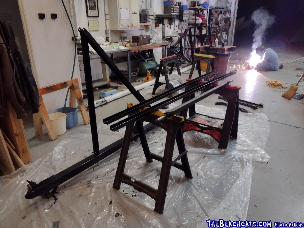

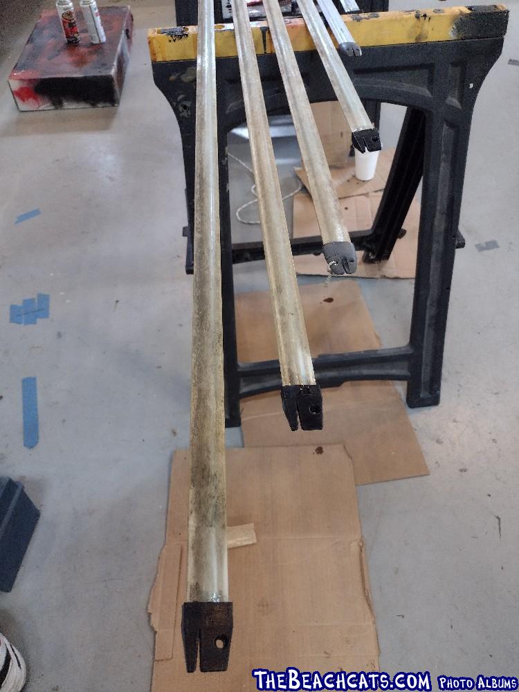

  • I often hear that "there is nothing more expensive than a free sailboat" and other advice to spend the money to get something good out of the gate. I think there is a lot of truth there. Our trailer project has spiraled out of control a bit. The new studs were spinning in the old hubs. We welded them on but I elected to buy new hubs anyway, especially when some weld spatter landed on the races. Whoops. We have moved the leaf spring brackets and located new holes in the spring mounts. I've ordered all the lines except for batten ties. I need to make a parts list for the boat and get that stuff on order. Summer is coming.
    Here is the welding of the cracked roller brackets happening. You can see we have straightened, cleaned, and primed the spreaders. Also the front of the trailer has been cleaned and painted. We are probably about $170 extra into the trailer so far.

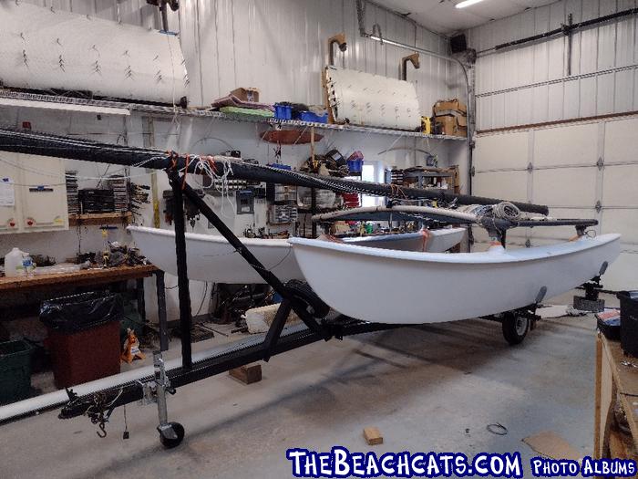

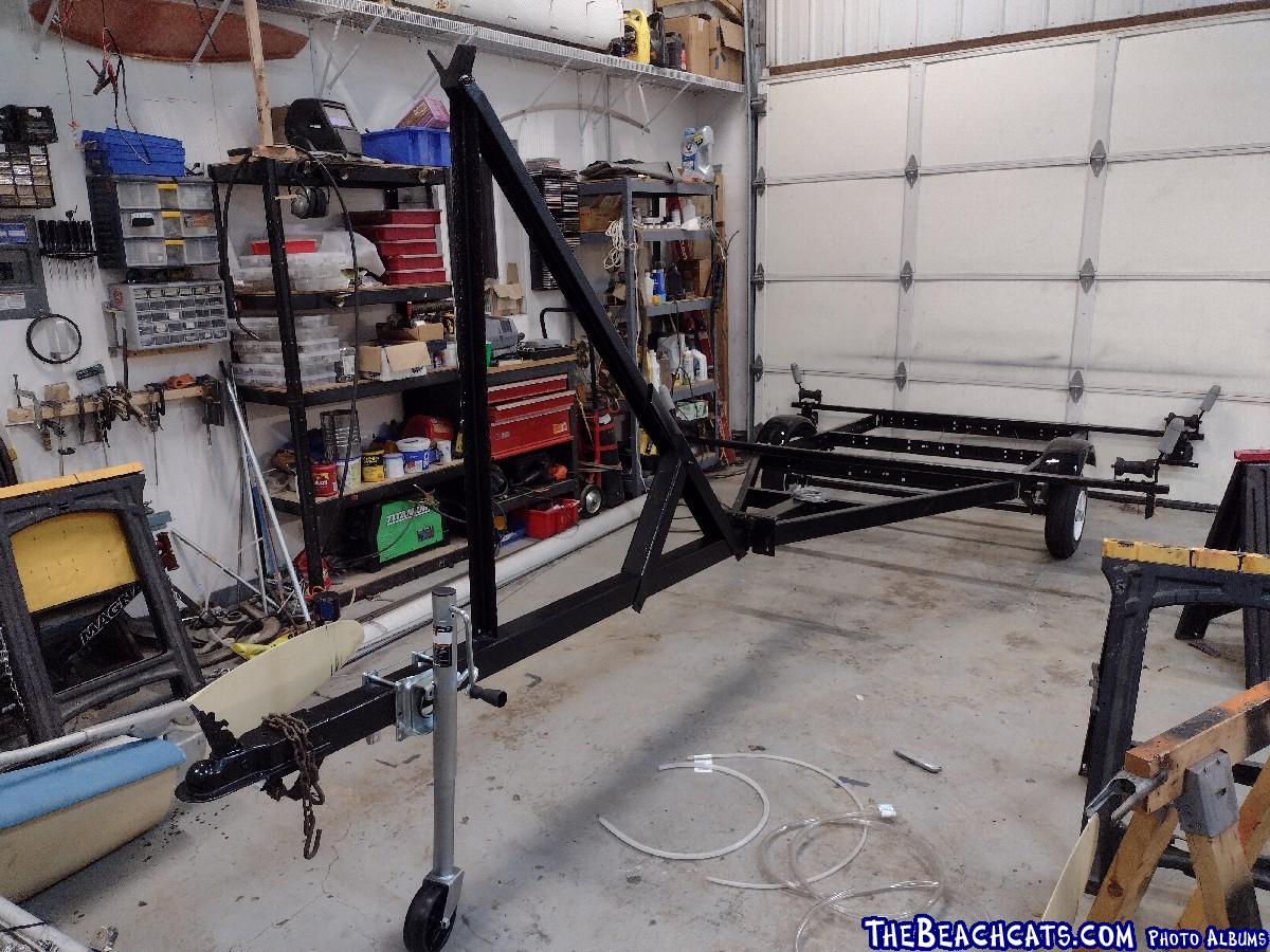

  • Thanks Chuck. We finished our trailer over the weekend. New springs, hubs, lights, wiring, and of course paint. With the shorter springs and moving the axle all the way forward we have positive tongue weight, but it is not excessive like it was before. We did a test run to 70 mph with the boat on and it was good.
    https://www.thebeachcats.com/gallery2/main.php?g2_view=core.DownloadItem&g2_itemId=134834&g2_serialNumber=3
    New lines and new parts from Murrays are on the way. Hope to have this on the water for Father's day.

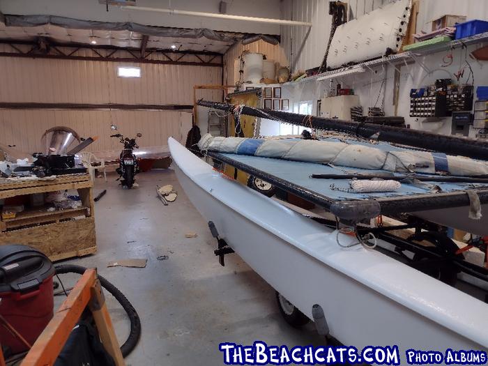

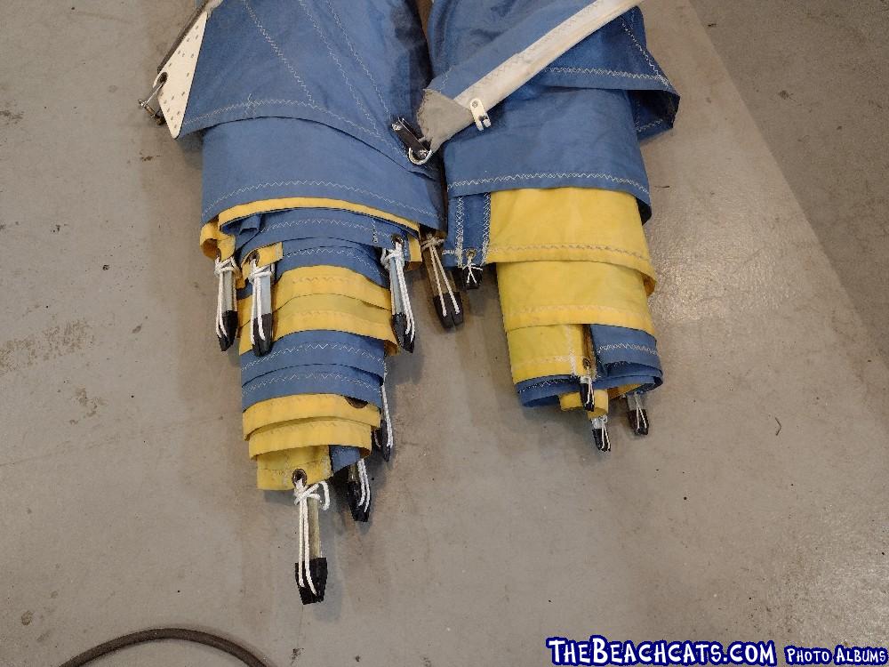

  • I'm putting the igloo beer coolers aside for a bit and trying to get the H16 lakeworthy by Father's day. My lines from Cajun Rope came today. They look good. Hoping the trampoline will last for this season anyway. It's not great. We took off the Home Depot lacing that was on it.
    https://www.thebeachcats.com/gallery2/main.php?g2_view=core.DownloadItem&g2_itemId=134849&g2_serialNumber=4
    Also you can see in the picture I bought a $20 harbor freight bumper mount 2" receiver. I'm going to put in a rear mast support that plugs into the receiver. I'll show more pictures later when that is done.

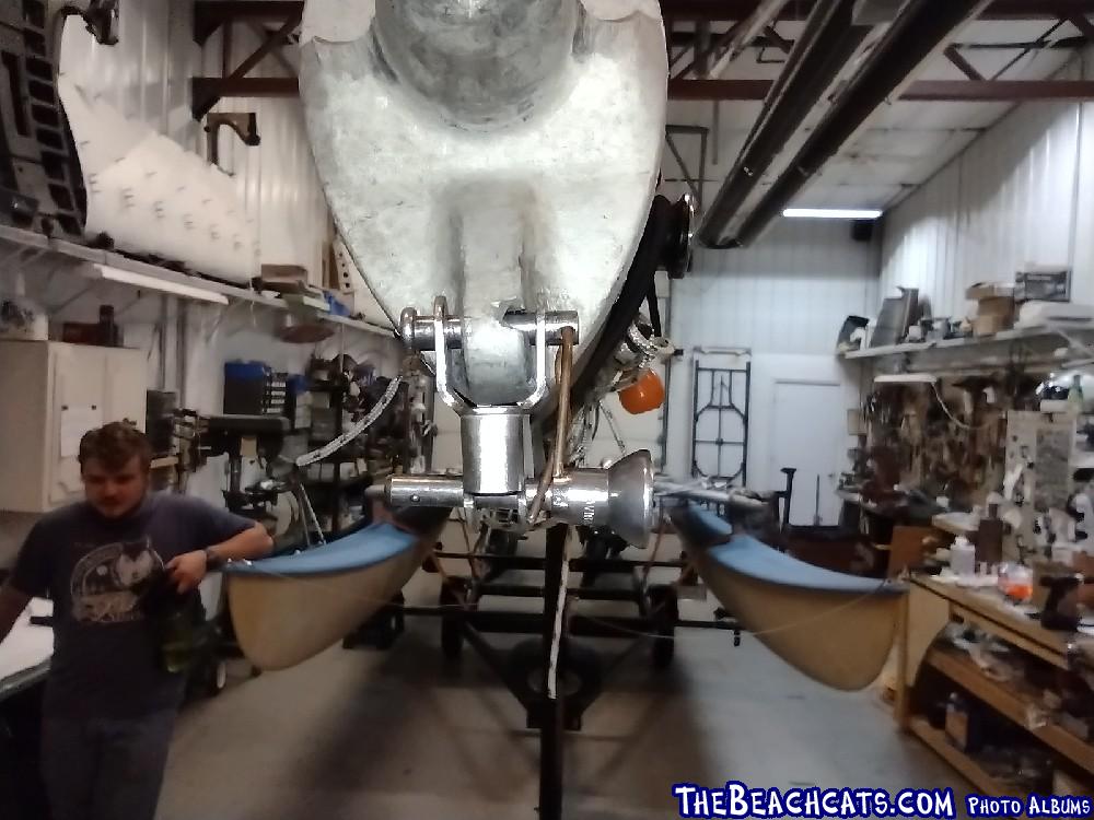

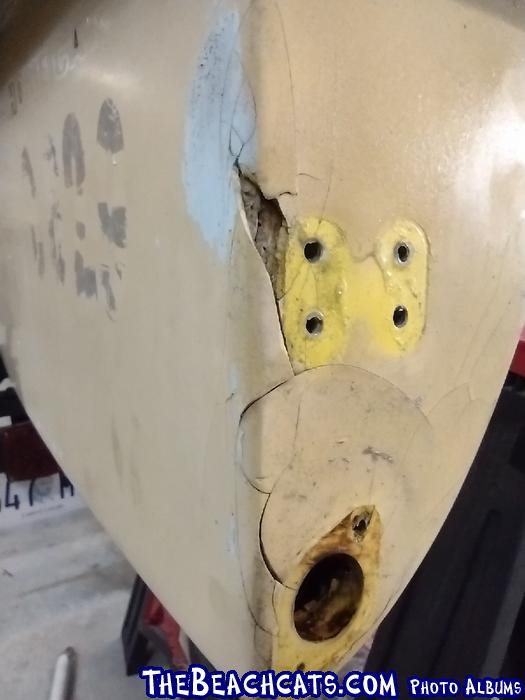

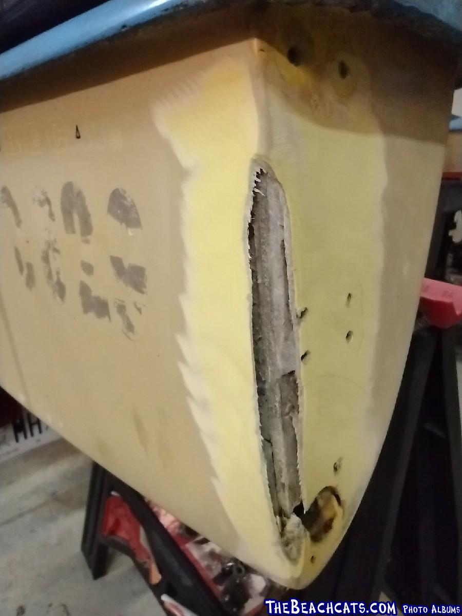

    We pulled off the rudders and it looks like I need at least one rudder cam. I'm going to buy the 2 pack from Murray's and just refresh them both, even though only one is broken. We also pulled out the drain plug and the gudgeon. Here is probably the most serious problem with the boat:
    https://www.thebeachcats.com/gallery2/main.php?g2_view=core.DownloadItem&g2_itemId=134852&g2_serialNumber=4
    There is some fiberglassing in my near future.

  • Tonight Adam put new tires on the spare rims for the trailer. I did a bunch of welding and fabricating for the aft mast support, and we sanded out the cracks in the transom:
    https://www.thebeachcats.com/gallery2/main.php?g2_view=core.DownloadItem&g2_itemId=134859&g2_serialNumber=3
    Looks pretty ugly. The wood behind the transom has been wet. At some point this will need a bigger restoration than I'm currently doing.

  • We did a couple of layups in there, then I made flox by mixing resin with chopped glass and sawdust. Jammed it in, sanded down when it was cured.
    https://www.thebeachcats.com/gallery2/main.php?g2_view=core.DownloadItem&g2_itemId=134881&g2_serialNumber=3

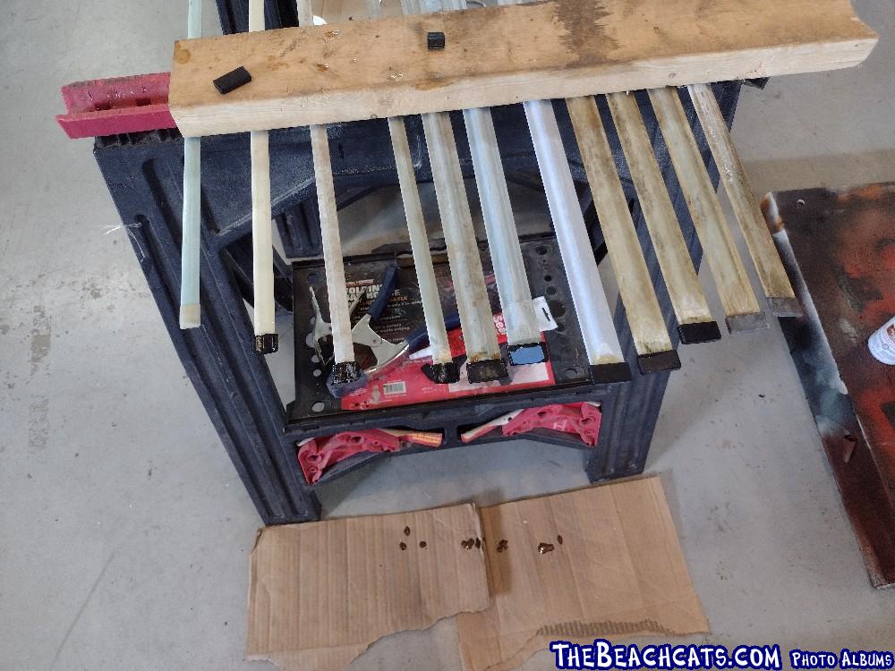

    Unfortunately I'm missing some battens - two for the main and two for the jib. That's the #5 & #6 I need for the main, and the #3 and #4 for the jib.
