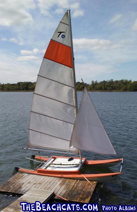

What is your process now? Where do you step the mast?
For anyone not familiar with the Taft, check this photo album.
https://www.thebeachcats.…ictures?g2_itemId=125326

Like in the video. You may want to test lowering the mast the first time and check how much looser are the trap
lines when the mast is down. On the picture I see that you might not be able to attach a line to the beam easily, maybe a loop around the hull will work.
