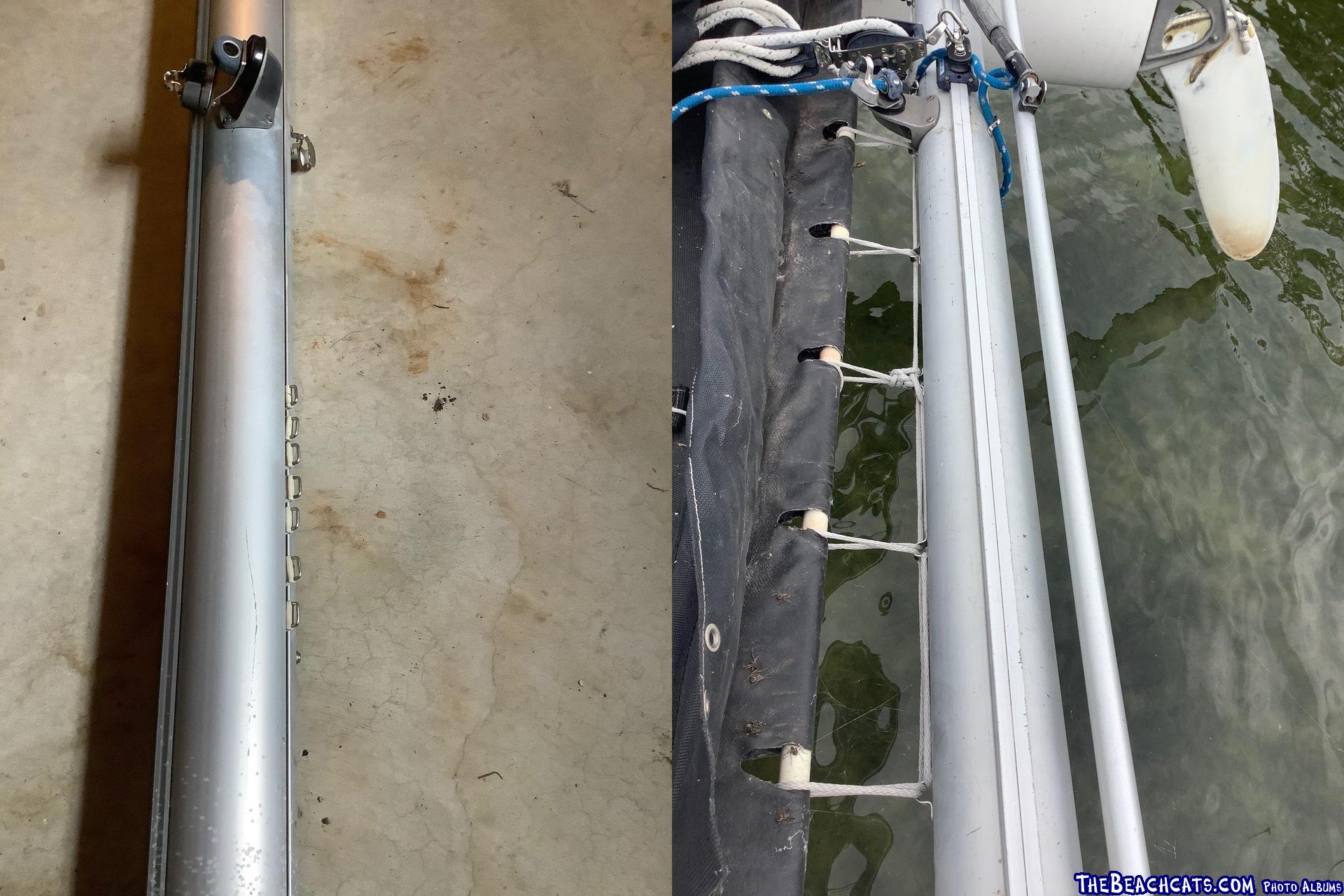

    The tube on our 1988 5.0 measures 72", however, don't get too hung up on that, its not a critical measurement. Just measure between the hulls, right at the rear end of the tramp tracks on the hull, subtract an inch from that measurement. As long as the tube fits between the hulls you're good.
    As for slugs, look at the new tramp you purchased. You need one slug for each cutout in the tramp. The photo of our '88 5.0 uses eyes riveted onto the beam. They are easier to work with, as there is much more room for lacing the tramp. (Make sure you buy very low stretch line). If you use slugs like on the spare beam for the '84 5.7 (pictured), you need a fairly thin line in order for it to go through each slug twice. You might want a couple of extras, placing one at each end of the beam as an anchor point for the lacing.

  • I should have shown the end of the beam with the slugs. There is an eye strap riveted on at each end, to dead end the lacing. That means I only have 7 slugs on the beam.

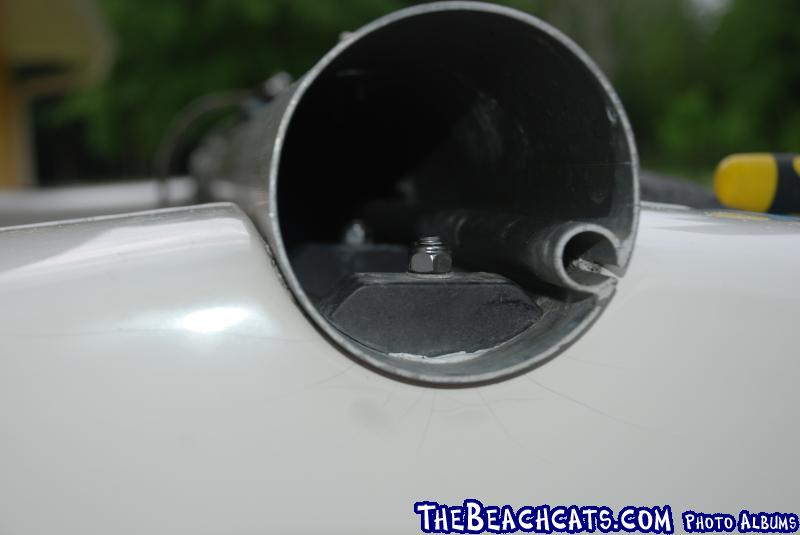

  • Here is an end view of my 1983 Nacra 5.0 front beam. The boat only had 1 beam chock per side when I got it. I added a second per side just because...
    https://www.thebeachcats.com/gallery2/main.php?g2_view=core.DownloadItem&g2_itemId=130202&g2_serialNumber=3
    Also, there are two different types of chocks, with boss and without boss. You need at least one with the boss at each corner to prevent rotation.
