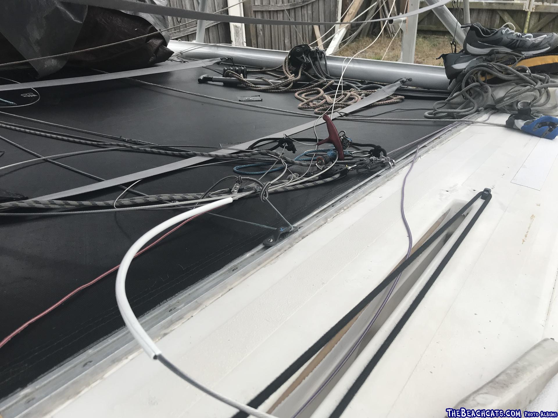

  • Quoteit is just about saving time in rolling, unrolling and untangling the wires,
    I don't disconnect any wires. I just wrap them into a circle and tie it off to a line that is on my deck already (jib car adjuster line)
    there is nothing to untangle .... untie the small knot that holds the loop of wires, slide the mast into stepping position and the wires have fallen inline and are ready for stepping
    https://www.thebeachcats.com/gallery2/main.php?g2_view=core.DownloadItem&g2_itemId=132805&g2_serialNumber=3

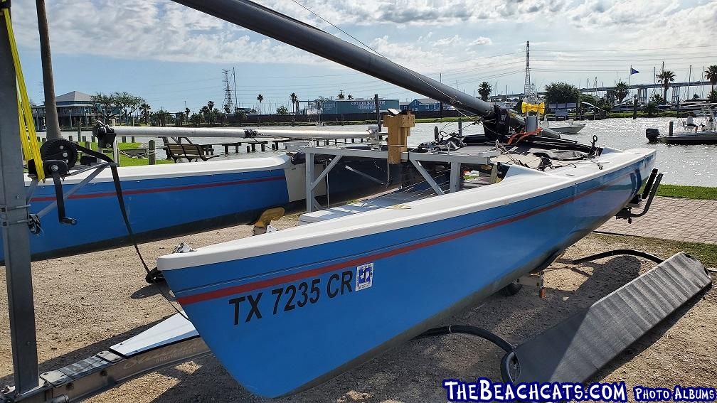

    I use a gin pole permanently attached to my trailer, which makes set-up a breeze and I CAN do it by myself, however 2 people are more comfortable. The trick was making it so that all hinge points are in-line so no loosening/tightening of lines is needed and is largely a one person affair. I also use a winch with an auto-brake ($75) - which makes it a LOT safer/more comfortable. If I slip or need to stop and adjust something, it is rated to hold the load in-place. I don't trust that it will, but it does.
    Here's a pic at the dock; you can see most of it and how I made it so that the trap wires hinge in line with the mast/dolphin striker ball and joint.
    https://www.thebeachcats.com/gallery2/main.php?g2_view=core.DownloadItem&g2_itemId=132915&g2_serialNumber=3

  • I'll get more pics this evening. That one doesn't show much...
