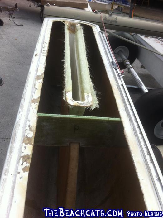

  • Has anyone ever popped the deck on the middle Deck? One hull worked fine the other deck I am worried about. I am having problems getting the center board well separated. That we'll has damage where it attaches to the bottom of hull. I want to get in there to repair the well from the inside and outside also that centerboards is stuck in the well. The tear in the well is about 2 inches long. I know the previous owner had a leak. Note I got the deck separated from the Thule excepted I ant separate it from the well.This is a prindle 18.2 same structure as the prindle 19.Thanks
    Tom Bainbridge, Ga. Hobie16, prindle 18.2
  • QuoteHas anyone ever popped the deck on the middle Deck
    I haven't but have seen a mystere with all the decks off
    https://www.thebeachcats.com/gallery2/main.php?g2_view=core.DownloadItem&g2_itemId=129599&g2_serialNumber=4
    Edited by MN3 on Feb 17, 2018 - 10:03 AM.
  • Yep looks like my mess. Thank for the photo mn3. That well is tough to seperate.any thoughts?
  • no thoughts sorry
  • Gosh this project has wore me out. Mn3 was correct and yes countless hours. I finally finished the top decks and have them sealed good. Sanding on the hulls now and correcting blemishes. I have already put 80 hours in the hulls. The rate I am going another 250 hrs. The last phase will be repairing the slightly damage rudders and centerboards. Super video about repairing and molding the boards by mn3. Thanks. I got the centerboard out of the 18.2 just jerk it good. I guess they are designed that way and seems to just lock in where the pic is snug at the very bottom.Wow we hat have I gotten into. I never dream this project would take so much time and money. I figured about 500.00 on epoxy and cloth and poly resin,sand paper acetone, mask tape and many other supplies.also will have to buy a new tarp. New lines,some fittings. Overhaul the trailer. I hope those nacra 5.5 sails work.I think I'll make the work. But I believe the boat will look ok when done. I am a perfectionist but the question is did I do it properly. Advice if you find a boat well taken care of and everything looks up to snuff the buy that boat. I will have a small fortune in mine when done.
