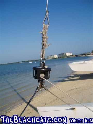

    A Portuguese turnbuckle looks like this, (I think this is MN3's setup)
    http://www.thebeachcats.com/gallery2/main.php?g2_view=core.DownloadItem&g2_itemId=80823&g2_serialNumber=3
    It gives you a strong purchase, rig it so you are pulling own on the final turn, using hi-tech slippery line, it slides fairly easily.
    This is what I used on my Nacra 5.7, similiar boat to your G-Cat
    http://www.thebeachcats.com/gallery2/main.php?g2_view=core.DownloadItem&g2_itemId=88328&g2_serialNumber=4
    It is a doubled PTB. I also leave my cat in the back yard, mast up. Here is the explanation of how it works.
    http://www.thebeachcats.c…pictures?g2_itemId=88327

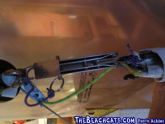

    As noted, I eventually went to one of these;
    http://www.westmarine.com…_065_008_509?recordNum=9
    I was advised to use the large one, 1000lb working load.
    I pull it to the closed position to sail, then once back at the dock, simply pull the safety pin, & open th lever. That de tensions the rig in a couple of seconds.

    What is that mechanism you show in your photo Edchris177?
    You use that in place of the Portuguese turnbuckle now?

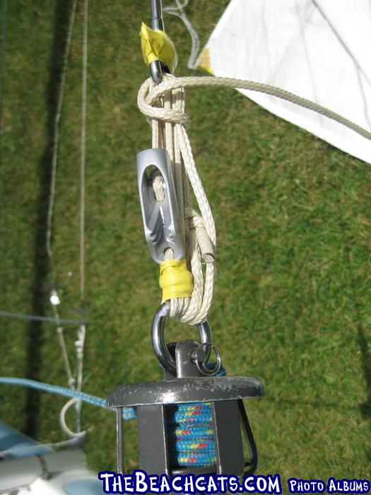

  • QuoteWhat did you use to connect the furler and forestay?
    http://www.thebeachcats.com/gallery2/main.php?g2_view=core.DownloadItem&g2_itemId=126363&g2_serialNumber=4
    Go to my Furling Album, then scroll down to the last few items to see the explanation.
    http://www.thebeachcats.c…pictures?g2_itemId=88268
    I decided to use the lever on the forestay as I had just had new shrouds made, & needed to cut the forestay to accommodate the furler anyway. It also means I tension the jib & the rig from the same spot. Makes it a 10 second exercise to tension & de-tension both.
    An Olympic gold medal Tornado sailor advised me to use the large,(1000lb working load) lever.
    I fully get that most people would say, "why not just use the PTB?"
    My Cats sit fully rigged,(except for mainsail), on modified Seadoo lifts. It was difficult to stand in waist deep water & try to tie/untie knots that were well over my head.
