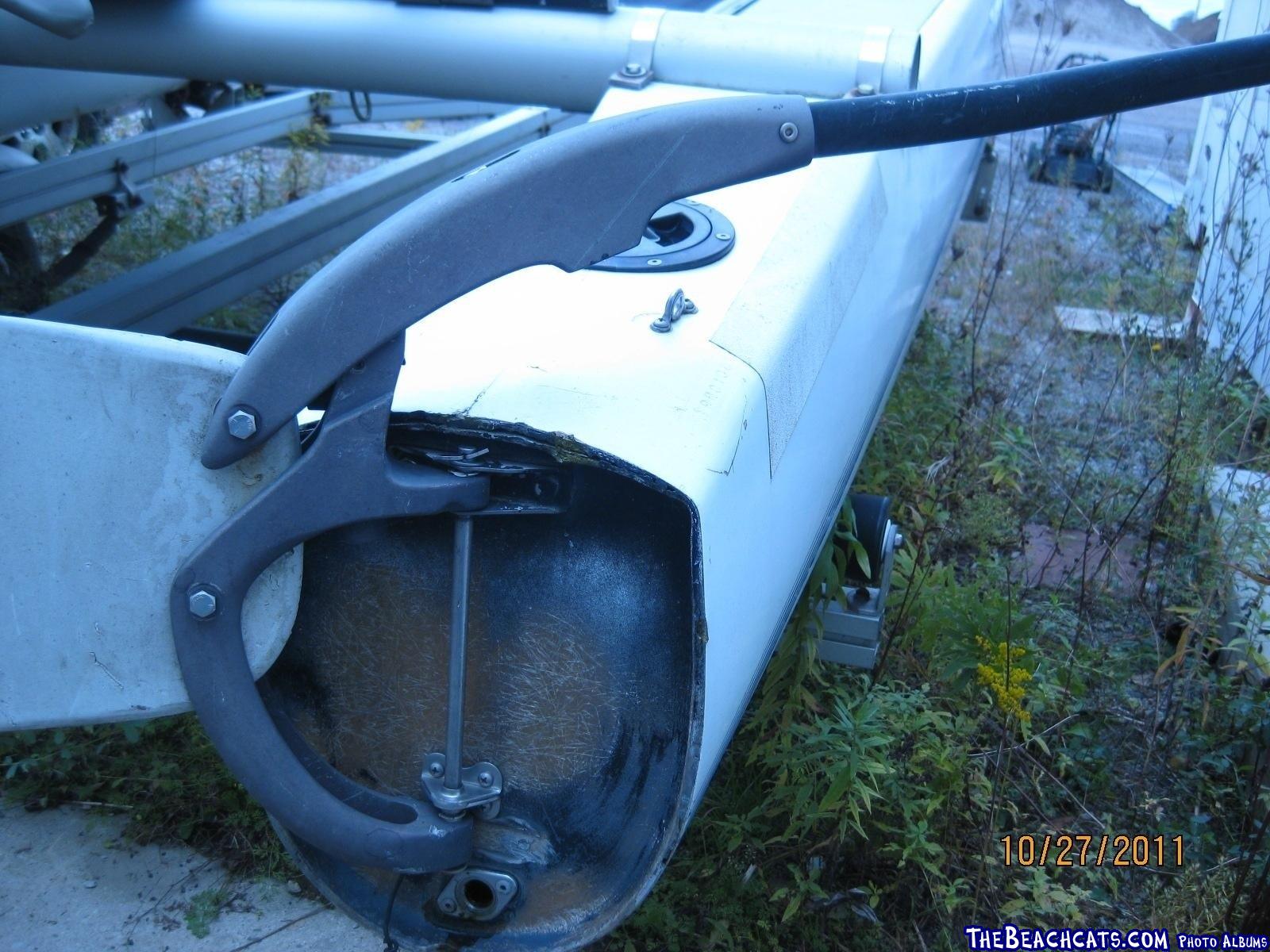

So I went over and snapped a few pics. After a little more looking I noticed a little bit of damage to the front cross beam as well as a small area of spider cracking in gel coat. Hull didn't seam too soft in that area and could easily get in there and reinforce with a bit of glass. The cross beam is what I'm not sure about! Also took a measurement which is just over 19 ft so I believe that confirms it to be a 5.8...
Below is the album of the pics I took:
https://www.thebeachcats.…ictures?g2_itemId=129039 -

The beam needs to be replaced, not a big job, the DS seems to be OK. Check with Dan Berger, or Pete Begle, both have ads here, both are reputable vendors, for a beam. Here's how to change out the DS;
https://www.thebeachcats.…a702a206fd7bf99a6410a6e1
The daggers might be hard to find, Mummp here has an album of his 5.8. Look through Personal & Tech Tips for a yellow hulled N5.8
The older Nacras are prone to gelcoat cracking, (especially around the shroud anchors & sterns), as long as the area is not soft, it's only cosmetic.
The tramp & tracks look OK. Jib blocks are there, as is rudder assembly.
Does it have sails, & mast, main blocks? These are big $ items.
You will also need lines, bungee, standing rigging.
It could be a fun project, for a fast boat, but if the big ticket items are missing, it's not worth much.

If you are looking to sail this boat . . . PASS! If you have storage space, buy it for parts. By the time you replace the front beam, get sails, buy daggerboards $$, new standing rigging, running rigging, etc., you could have bought a boat ready to sail cheaper.
I have new daggerboards for the 5.8 and the 6.0. They ain't cheap!
Now that boat parked next to it has by interests. What is it?

It does have a mast with the standing rigging. It's coated and looks on the thin side but seems to be in decent shape. There's a local sail shop that has some nacras laying around, they may have sails, daggerboards, and the main blocks that I need. The trailer is another issue... -

Let me add that those are not gelcoat spider cracks, that is damage. This is a foam core boat, which means possible water intrusion in the foam and more experienced repairs. Ports added aft of front beam just about guarantees previous repairs/damage.
The rear beam, if the track is not nicked or beat up, would be a nice find or upgrade for someone. It is the extruded track full length. A rather rare item.

I don't have any use for a parts boat seeing that I don't currently own 1 that I would need parts for! Even if getting this boat for a $100, still not worth fixing up? The boat next to it is a hobie getaway.
