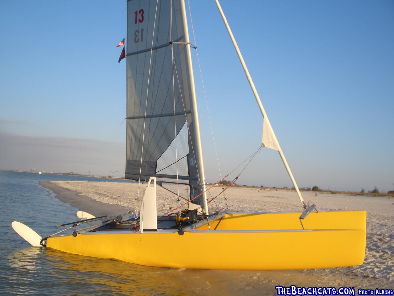

  • We tie all our righting lines to the DS, the loose loop slides to the top. I've never seen it sit at the bottom while righting, & I have some experience with righting, in all kinds of conditions!
    With friction over the hull, if my DS bends from righting, I wouldn't trust it to support the beam.
    https://www.thebeachcats.com/gallery2/main.php?g2_view=core.DownloadItem&g2_itemId=74457&g2_serialNumber=7
    Phillips boat looks like the beam has rotated within the straps vs bending the rod.(Or maybe he was raking the mast, & so purposefully rotated the beam a bit so that the mast was in line with the DS). You can see the end of the V brace strap is not at the bottom of the curve where the beam sits. I have done this on the 5.7 after some really hard bashing. The beam is prevented from rotating by the 1/2 moon chocks inside the front beam, like so;
    https://www.thebeachcats.com/gallery2/main.php?g2_view=core.DownloadItem&g2_itemId=80923&g2_serialNumber=6
    If the beam slips, it will travel until the bolt hits the edge of the hole,(possibly enlarged due corrosion), or until it hits the tramp track.
    Who knows, he may have just set the boat up, I see the mast is still pinned to the ball. He would remove that pin before sailing.

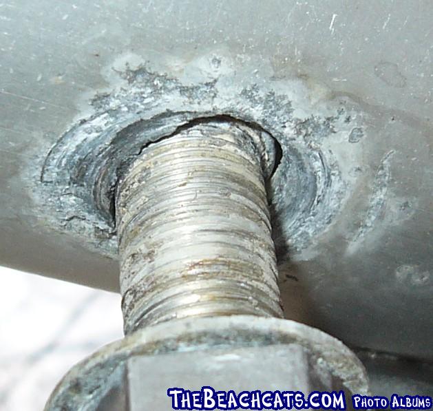

  • https://www.thebeachcats.com/gallery2/main.php?g2_view=core.DownloadItem&g2_itemId=29626&g2_serialNumber=4&g2_GALLERYSID=993ec7557da6dffa1218ede134d1a46c
    That pic was before the main beam was replaced.
    The reason for the replacement? Corrosion. See the pics below. They are in his album.
    The post and compression tube were wobbling around in the whole.
    Sheet the main and the post tilted back, loosen the main and it went back forward.
    It has nothing to do with the righting line and the post was not bent.
    This was years ago and the boat is still sailed, raced and is competitive today.

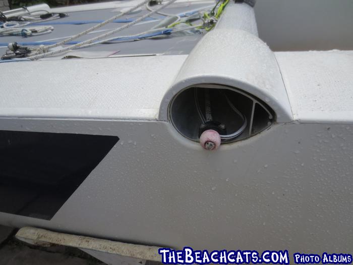

  • I like the righting system on my Dart. It is wholly contained within the front beam, retracted by bungee cord. When required, just pull the red ball. When you let it go it retracts out of the way.
    https://www.thebeachcats.com/gallery2/main.php?g2_view=core.DownloadItem&g2_itemId=128504&g2_serialNumber=4
