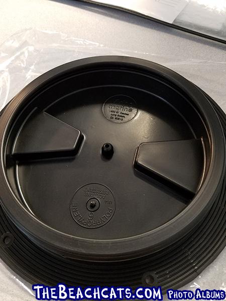

  • So ports came in. Bags apparently were not in stock but coming. Not much on the inside to hook a tether to. I guess I can try to drill a hole horizontally in that center bit and tie something. Or epoxy something in the hole or somewhere else on the bottom. or maybe even fine a short screw the right diameter that can go in the hole to hold something. Just Dunno yet.
    https://www.thebeachcats.com/gallery2/main.php?g2_view=core.DownloadItem&g2_itemId=128033&g2_serialNumber=3
  • The SS screws that currently hold my ports in are screws not bolts they have no nylock nuts I can feel the points sticking out inside the hull. Seems to just be tapped into the fiberglass. But they also seem to be doing good job just not sure they will after I remove the old ports and clean everything up.

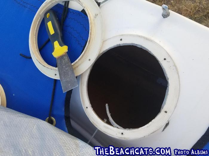

    Which reminds me any tips on removing old sealant for the old ports before I start with the new ones.

  • Quote or maybe even fine a short screw the right diameter that can go in the hole to hold something.

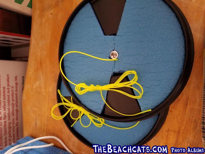

    Bingo! I replaced the ports on an H18 Magnum with white Viking ports. To secure against loss, use a foot long piece of thin line, I had some 2mm Spiderline. Just lightly hammer the end of the line to flatten it, then push an awl through the line, & "work" it a bit to open up the hole.
    then simply turn a small SS screw into that boss on the underside of the lid.
    tie the other end of the line to the middle of an 18"dowel, or plastic rod. You turn the rod on end & drop it into the hole. It will sit sideways, & is wider than the hole, so it prevents the lid from loss, though I also glued a circle of blue Styrofoam SM to the inside of the cap so it will float. A screw in that small boss is plenty strong.

  • removing old ports
    https://www.thebeachcats.com/gallery2/main.php?g2_view=core.DownloadItem&g2_itemId=128185&g2_serialNumber=4<br />

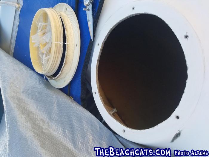

    Nice and Clean
    https://www.thebeachcats.com/gallery2/main.php?g2_view=core.DownloadItem&g2_itemId=128189&g2_serialNumber=4
    New lids with tether and floats
    https://www.thebeachcats.com/gallery2/main.php?g2_view=core.DownloadItem&g2_itemId=128193&g2_serialNumber=4

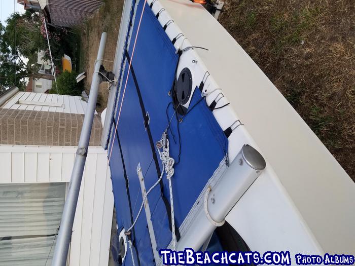

    New Tramp and Ports (not sure why it rotated it)
    https://www.thebeachcats.com/gallery2/main.php?g2_view=core.DownloadItem&g2_itemId=128181&g2_serialNumber=4
