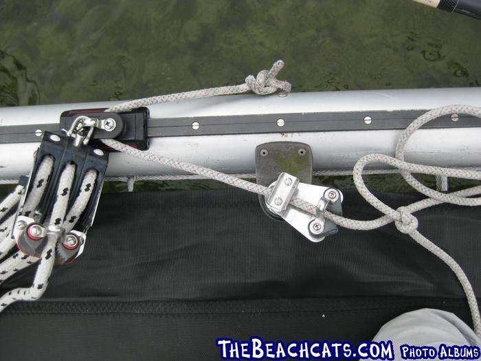

  • The main traveler on my 1983 Nacra 5.0 is a Ronstan 360 (swivel cleat mounted to the car).
    http://www.thebeachcats.com/gallery2/main.php?g2_view=core.DownloadItem&g2_itemId=127143&g2_serialNumber=4

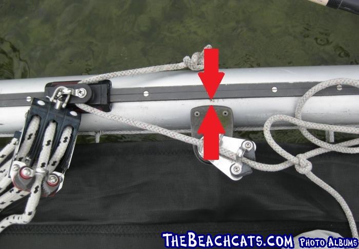

    As most all of these mine too has been bent and straightened a few times. Additionally I find it harder to use than a stationary centered swivel cleat arrangement like a Hobie 16 setup. My understanding is that some of the legacy Nacra's had a centered arrangement and I found a bracket that adapts the rear crossbar to such.
    http://www.thebeachcats.com/gallery2/main.php?g2_view=core.DownloadItem&g2_itemId=127146&g2_serialNumber=4
    Anyone know which Nacra came with this centered arrangement and do you have any photos? Also would like a photos the traveler car that it uses.

  • The early Nacras used the top photo system. I'm not exactly sure what year they changed, but the late '70s
    N5.2 used the top photo.
    I think it may have been all the boats that originally came with 1.25" mast ball, & the thinner DS rod. My '84 5.7 & the '88 5.0 both have the bottom photo system.
    If you have the fitting,I'm sure I have an extra) it might be possible to change out. You would have to drill out the SS rivets,(unless it is a small bolt?) to separate the original traveler parts, & remove the swivel cleat. You would then have to re-connect the car with the top part that the main block hooks onto. You cannot use an AL rivet there. AL is fine for mounting the fitting to the bar, that is what OE used. All that assumes your car/track is in good condition, you can't swap a Harken small boat car onto that track.

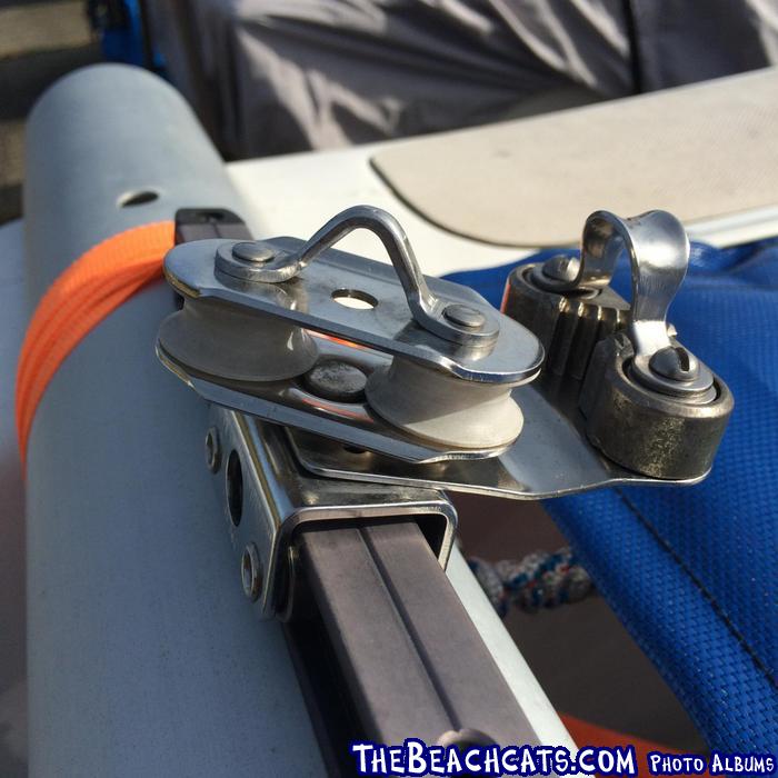

    Here is the car and it appears to be exactly what I need:
    http://www.mauripro.com/us/product/RONRC61910.html

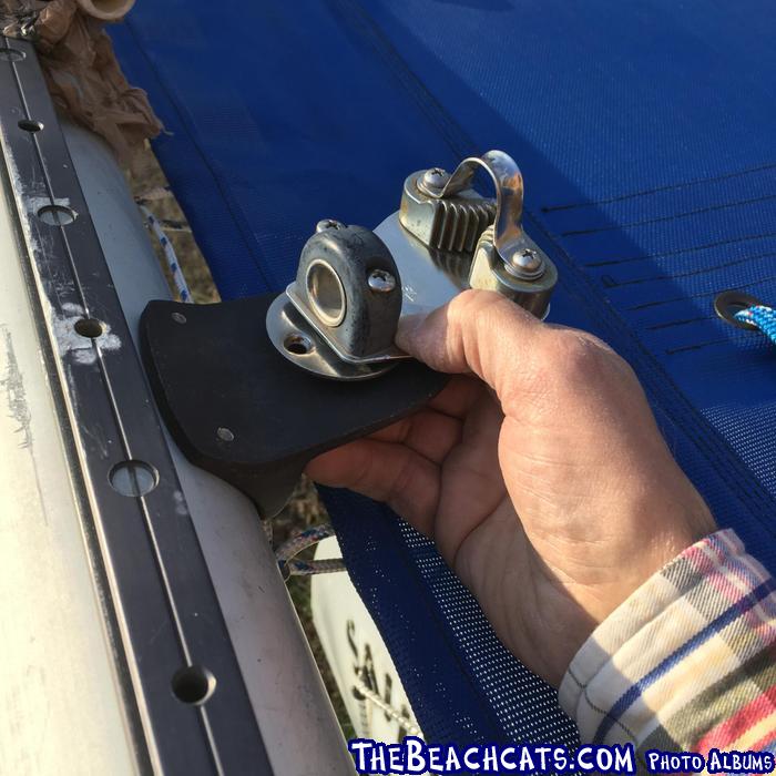

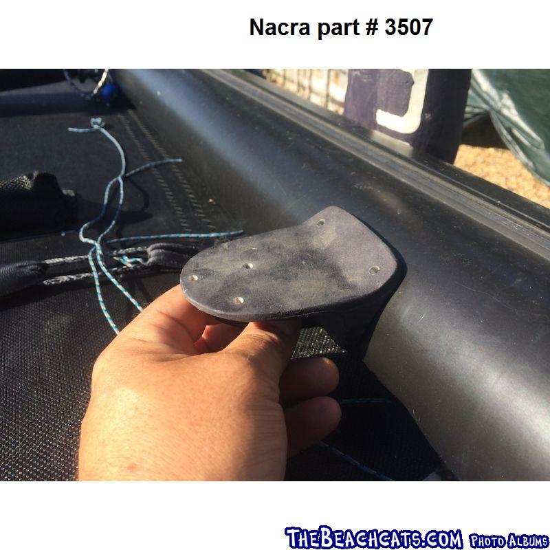

    Here is the adapter bracket and part number:
    http://www.thebeachcats.com/gallery2/main.php?g2_view=core.DownloadItem&g2_itemId=127153&g2_serialNumber=3
    AndinistaI didn't really notice a relevant improvement, the other setup worked just as well in my experience.
    For me the problem with the original arrangement is two fold. The cleat is much further from you so it's more difficult to get angle on for cleating/un-cleating. Second, with wear at the swivel plate the angle issue gets even worse. And lastly, I don't know how many more times the thing can stand being bent before I hear the coat hanger "clink" sound and have two pieces instead of one.

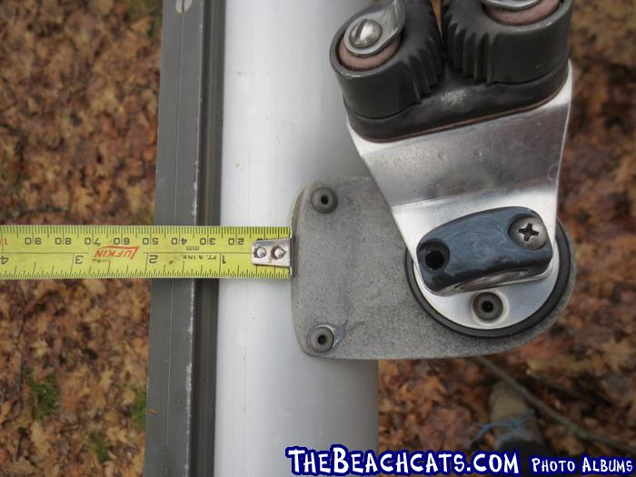

  • Edchris177This is the setup when they went to the 1.5" ball, at least '84 & beyond. the photo is a 5.7, the only difference the 5.0 uses a shorter Harken car.
    Ed, what is the dimension from the bottom of the track to the top of the adapter bracket?
    http://www.thebeachcats.com/gallery2/main.php?g2_view=core.DownloadItem&g2_itemId=127156&g2_serialNumber=3
  • this is the 5.7, but the beams are the same, so mounting should be the same. It's not great perspective, if you look straight down, from the track, the measurement is more like 1 1/2".
    The important thing is to mount the bracket so the flat surface of the bracket is 90* (perpendicular)to the top of the traveler track.
    http://www.thebeachcats.com/gallery2/main.php?g2_view=core.DownloadItem&g2_itemId=127158&g2_serialNumber=4

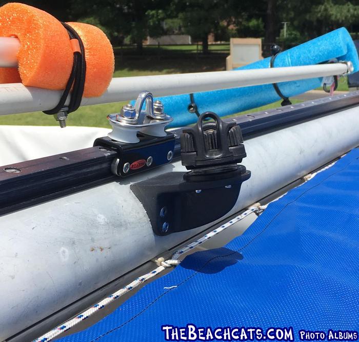

  • My conversion has become a reality, PTL:
    https://www.thebeachcats.com/gallery2/main.php?g2_view=core.DownloadItem&g2_itemId=128225&g2_serialNumber=4
    I went with the Ronstan 6 wheel car and a bracket/cleat setup the folks at Brisbane Catamaran Centre offered.
