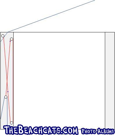

I use it very rarely. It is stored inside the rear beam, each end has a carabiner which is normally out of each beam end cap. When the crew uses it, she hooks the carabiner to the trap thimble, not to her harness. Before tacking she takes it out and hooks it to the side stay to have it handy for next tack.
The setup shown is complicated but the bungee is long enough to have a nice tension in any position and to take all the line back inside.

I did it mostly for the fun of doing it... Maybe for long distance sailing it's worth it, otherwise it's not really needed. -
