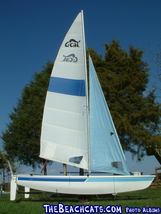

  • I had a fathead main off a Prindle 18-2 so I had my favorite sailmaker "The Irish Sail Lady" in St Augustine, FL take the top panel off and redo the 45 degree batten. Ended up with a great squaretop main for my G-Cat 5.7.
    Best sail I ever tried on that boat. It was a Hobie 18 killer.
    Brad in JAX
    Stiletto 27 (x2)
  • bradinjaxI had a fathead main off a Prindle 18-2 so I had my favorite sailmaker "The Irish Sail Lady" in St Augustine, FL take the top panel off and redo the 45 degree batten. Ended up with a great squaretop main for my G-Cat 5.7.
    i believe it
    those boats had similar sail shape - similar to Olympic tornado style i think
