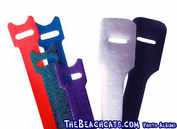

My solution to things swinging around in my face is to use those two-sided velcro wire wraps. One end has a hole so you can loop the tail through and keep it on the dog bone/rings. The rest is 4 to 6 inches long and easily wraps around the stay or the trap line itself if you have the bottom of the trap line under tension. Quick release and it stays put on the dog bone.
