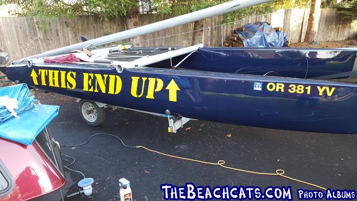

I was just looking at old images of my 5.2 jib and it does have the small battens in it. There were a couple of different jib block set ups that I have seen, but the way mine is still set up with is with a wire running from the main beam to the rear beam. Mine has had various types of closed cell hose line over that wire. The jib blocks are attached to that wire with a line usually running to the rear beam and through the strap that holds the wire and to a clam cleat. This set up gives you the ability to move the jib blocks for and aft, but not something you would do while racing. I've just added an image to my album that shows the deck from a distance. If it would be helpful I can take a closer image tomorrow in the daylight. I would measure the distance from the rear beam on my setup, but I doubt it is correct after all the work I did last fall.
If your jib is fluttering badly and you do have the small battens in place you need to figure out how to get the blocks slightly more forward.
Some of the newer setups have this jib wire running under the tramp.
