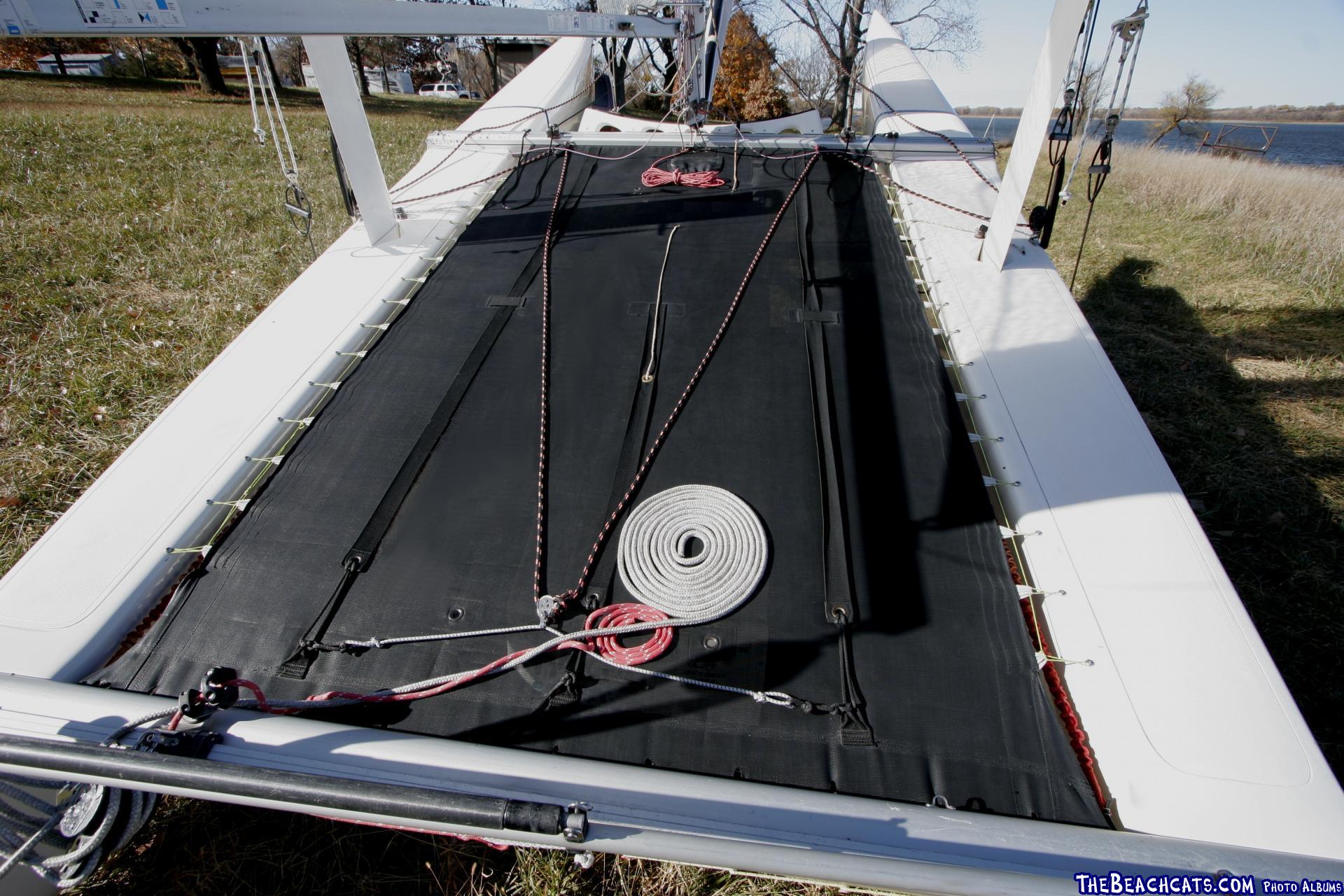

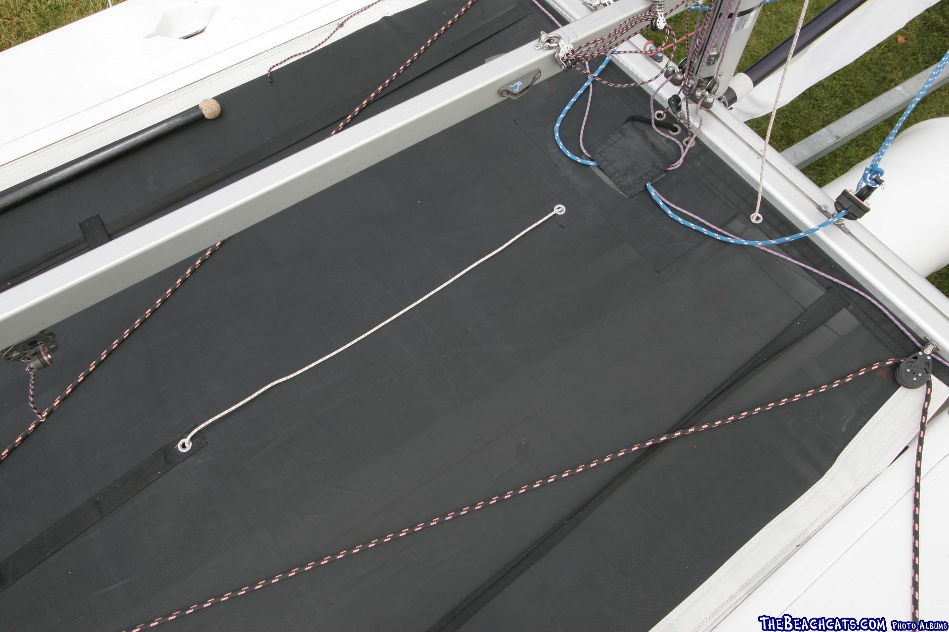

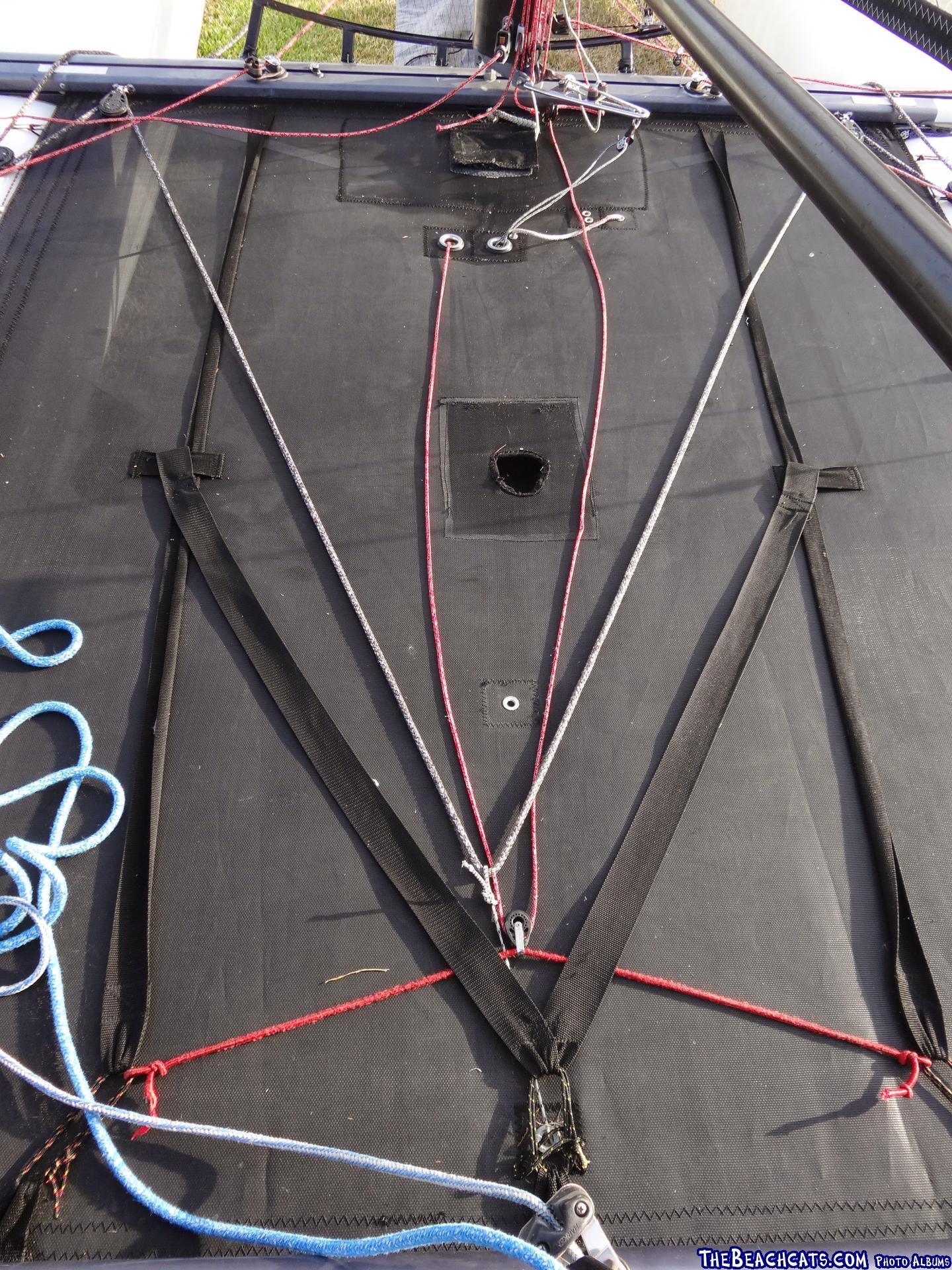

  • eric,
    here are 3 photos....the 1st is my current N20, the second is an N18 i owned and the 3rd is someone else's Infusion.
    http://www.thebeachcats.com/gallery2/main.php?g2_view=core.DownloadItem&g2_itemId=127170&g2_serialNumber=3
    http://www.thebeachcats.com/gallery2/main.php?g2_view=core.DownloadItem&g2_itemId=127171&g2_serialNumber=3
    http://www.thebeachcats.com/gallery2/main.php?g2_view=core.DownloadItem&g2_itemId=127175&g2_serialNumber=3
    i put a Ronstan (RF-5?)block on the mast to replace the cam cleat that was originally on the front crossbeam. i found that the halyard kept putting itself back into the cam cleat when i was trying to douse the spinnaker, which meant my crew was pulling it down while it was locking itself in the cleat...frustrating and possibly dangerous.
    i've set my halyard route up to minimize the lines on top of the tramp by running it underneath as it travels to the rear (going on top of the trap bungees below the tramp to keep it up and out of the water.) this is a bit unorthodox but it works to clean up the tramp.
    i tried to add a block and bungee under the tramp to pull it backward so it wouldn't slap in the water, but it twisted once and locked up so i removed it.
    i used the grommets that were there and added those in the center footstrap.
    i don't have the spinnaker sheet attached to the bungee/block in back as seen on the first photo.....another trial & error.
    cheers
    j
