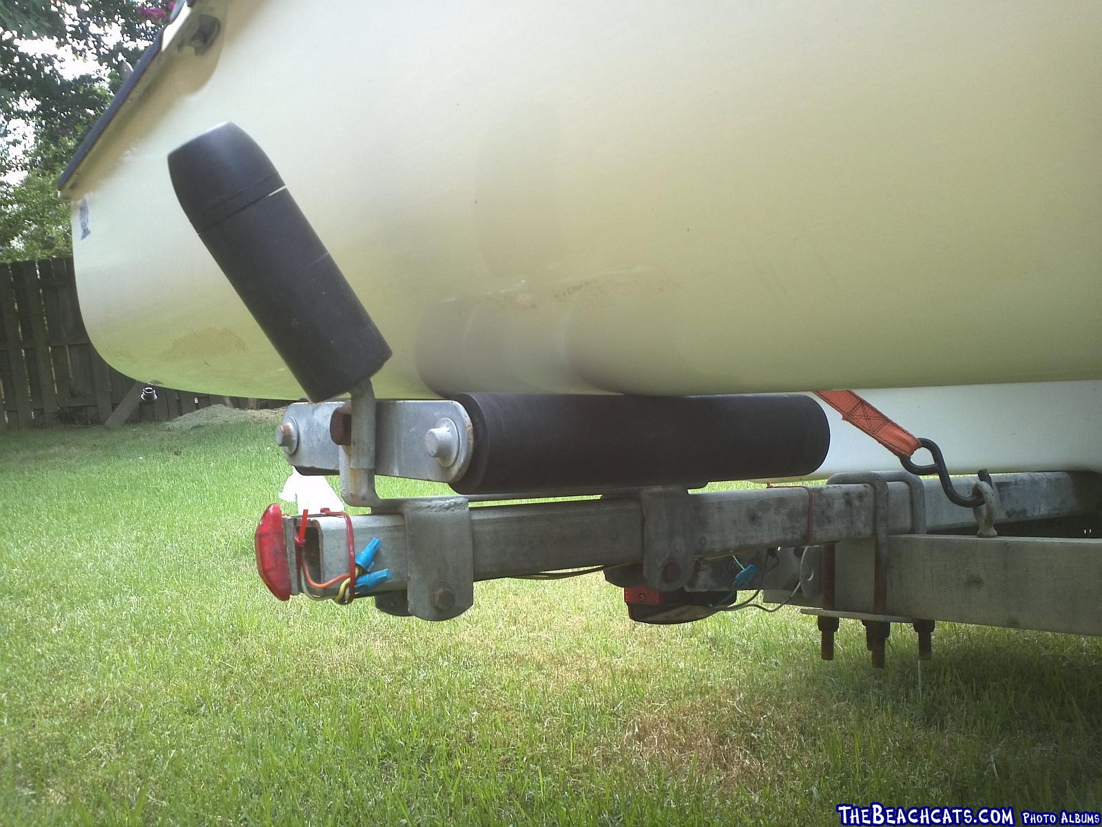

    Here is my quick and dirty side markers, been using them for three years now no problem, trailer is really lit up at night, I like being able to see the sides of the trailer in my rear view mirrors at night.
    You can see how the stacked galvanized arms might not be a good conductor for a ground, to be safe I ran a ground wire all the way to the main fore and aft trailer structure which is grounded from the vehicle.
