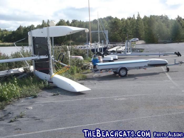

    The place where I keep my cat is mostly paved and I was thinking of ways to prevent this from happening again:
    http://www.thebeachcats.com/gallery2/main.php?g2_view=core.DownloadItem&g2_itemId=91101&g2_serialNumber=4
    There are two possibilities on how I would store the cat,
    a) keeping the cat and tying it on the trailer this time...
    b) keeping the cat on supports on the pavement and securing it somehow
    Option b would be the preferred method, as I would like to be using the beachdolly to move the cat, not with trailer and car.
    Do you tie down the trailer as well if you store your cat on it, or do you rely on the weight of the trailer to keep it down?
    Any ideas how to secure the cats?

  • i can definitely say that the weight of the trailer and sailbox will not keep a cat flat...

  • Quotei can definitely say that the weight of the trailer and sailbox will not keep a cat flat...
    http://www.flickr.com/pho…in/photostream/lightbox/
    j
    That's a crazy picture! I never would have thought about the need to tie down a boat attached to a trailer, but i guess it makes perfect sense. I've suddenly become more interested in this discussion... icon_eek
    Ouch! the first Nacra just looks sad that way. As a note, he was lucky the rudders were fully "up". If they are down,(think about this if you flip the Cat on the lawn) you can break the castings/blades as it goes over.

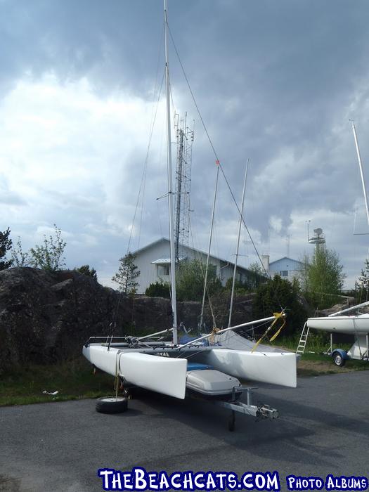

    It took me a while to answer, but wanted to have the sketches to clarify the idea. The drilled anchors could be one idea but since we dont have assigned locations for boats that could be difficult. I was also thinking of using 20 or 30 liter canisters or old car tyres as weight, but I think there would need be so many that they would be in the way most of the time.
    Concrete weights could be one idea, at least on the home port. One could use an old tyre as mold for concrete weight and it would also serve as protective bumber, so it would not hurt that much when hitting the weight with bare feet. Inside would be a garden hose for the tie down rope, making it easy to replace the rope if needed. Another advantage would be that there would not be anything sticking (a loop, bolt etc.) out that you could hurt yourself or the cat. A foam on the topside would make it even safer. The tyreweight would also be a bit easier to move around than a concrete slab if such would prove necceseary.

  • We use a similar, but larger, system for anchors at our club, Lac Deschenes Sailing Club, Ottawa, Canada. I would recommend a hole through the middle, big enough to put a steel fence post through. That way you can put the post in the middle, pry the thing upright, roll it to where you want it, and let it down under control. Then take your post and go do the others. Otherwise these things are gonna be hard to move.
  • archi can definitely say that the weight of the trailer and sailbox will not keep a cat flat...
    jEdited by arch on Apr 17, 2013 - 10:43 AM.
    a cat on a trailer with a cat (mast up) will defiantly topple with enough wind.
    mast down will survive much longer, but will still flip at some point (steel trailer is MUCH heavier than an aluminum one, so that is a big factor here)
    If you build concrete weights, why not use some chain instead of line. IMHO line running through the concrete will burn through a hose and then rub your line apart very quickly (your boat will be rocking and sawing through the hose in every storm

  • BigWhoop I would recommend a hole through the middle, big enough to put a steel fence post through. That way you can put the post in the middle, pry the thing upright, roll it to where you want it, and let it down under control.
    Thanks for the tip Big one, really made it easy to move the tyres around! I have two tyres now in use, third one is in garage drying up. I used old 16" 205-55 tyres from my car, filled with concrete and five masonry bricks broken into pieces, one tyre weighing 85 kg and second 90 kg. I put in an stainles steel eyebolt to attach the tiedowns.
