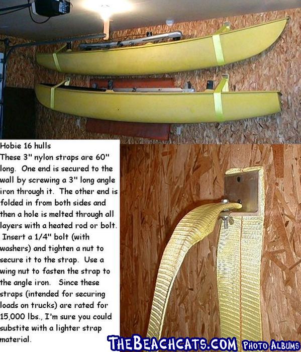

  • Here's how one clever member solved the space problem for winter storage. I know you mentioned leaving the frame attached, but since the boat is new to you it wouldn't hurt to disassemble it to inspect everything.
    http://www.thebeachcats.com/gallery2/main.php?g2_view=core.DownloadItem&g2_itemId=11246
    How To Create Your Signature
  • Thanks Damon, that would be perfect. I'm going to try something like that
