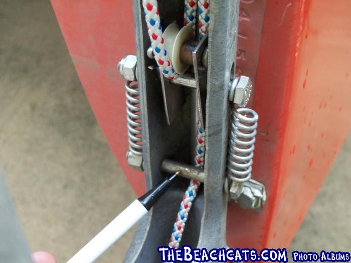

    locking pin is straight and springs are not stretched out....

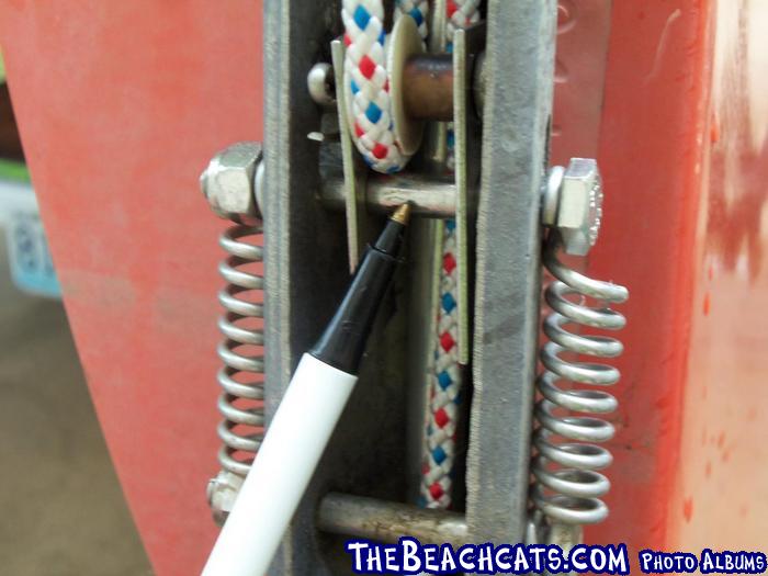

    the lock release mechanism is setup correctly with sheave and nylon spacer, when you pull on the "up" line, the tension lifts the lock-pin and frees the lock-bolt....

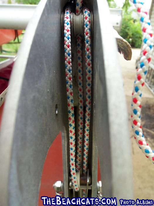

    the upper sheaves are in good condition and spin freely, notice the SS washers between sheaves?

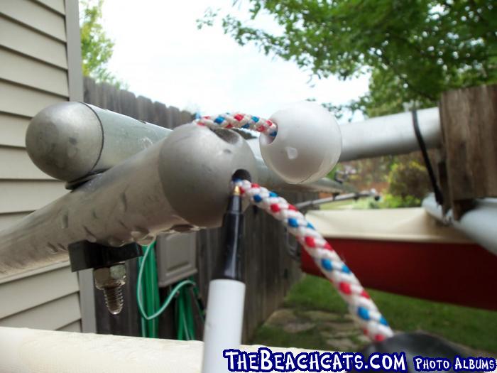

    the rudder lines are reaved correctly, one on either side of the tiller connector bolt, 1/4" aluminum tubing makes good "T" handles, balls work ok.....

    rudder lines are reaved in straight lines to their corresponding sheaves to eliminate binding....

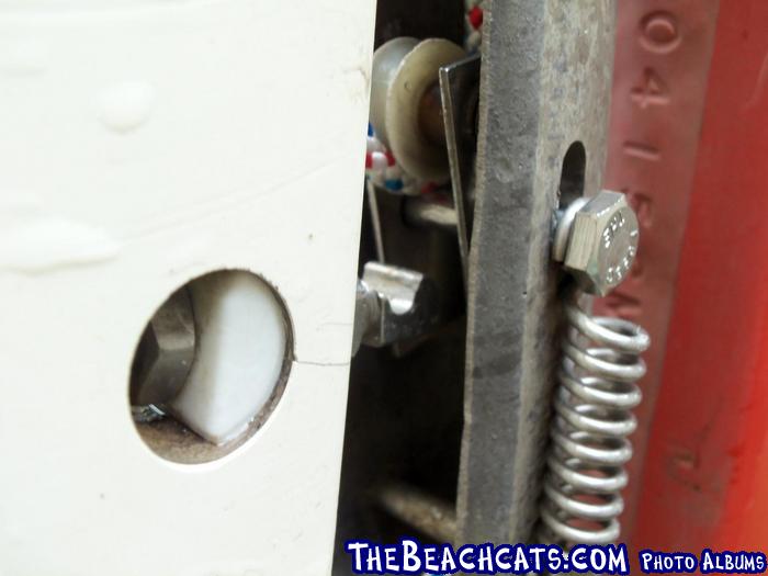

    locking bolt is straight, lip is not worn from incorrect alignment on locking pin and half-round load spreaders are in good shape...
