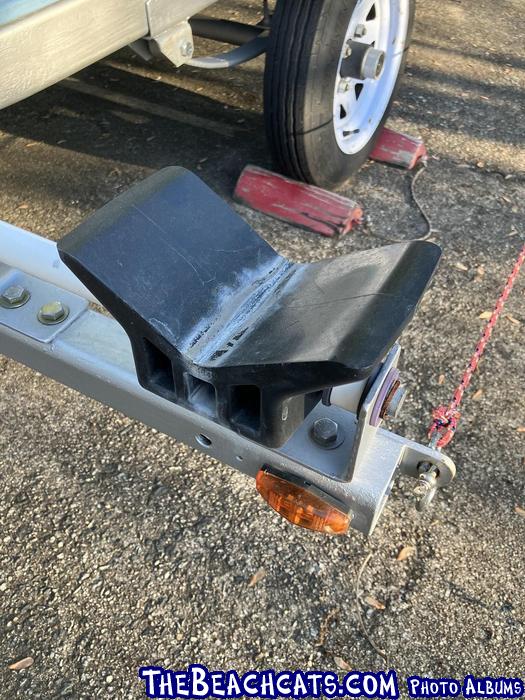

    I plan to replace them, but I want to do it in the most logical way possible for such a long drive. I recently joined my college's sailing club and at their facility is a Hobie 16 sitting on four bow stops instead of rollers.
    https://www.thebeachcats.com/gallery2/main.php?g2_view=core.DownloadItem&g2_itemId=137504&g2_serialNumber=3
    The point of contact for the bow stop is much larger than the rollers which should be easier on the hulls. The only issue would be getting it off the trailer, but it's not a heavy boat.
    Has anyone done this? Is this a viable option, or am I losing my mind?

    Those bow stops are better suited for a Hobie 16 or a Nacra 500, not for your more rounded hull, unless you find something with the right shape. You would need to lock rotation somehow, if they turn it will be messy. Perhaps a round bow stop. I would just replace the rollers for the daily use. and If you fear damaging the hull on the road, add some protection.
    Edited by Andinista on Feb 22, 2023 - 10:49 AM.
  • QuoteHas anyone done this? Is this a viable option, or am I losing my mind?
    not only is this not enough surface area, these bow stops don't last all that long and will mark up your boat with black streaks on the side

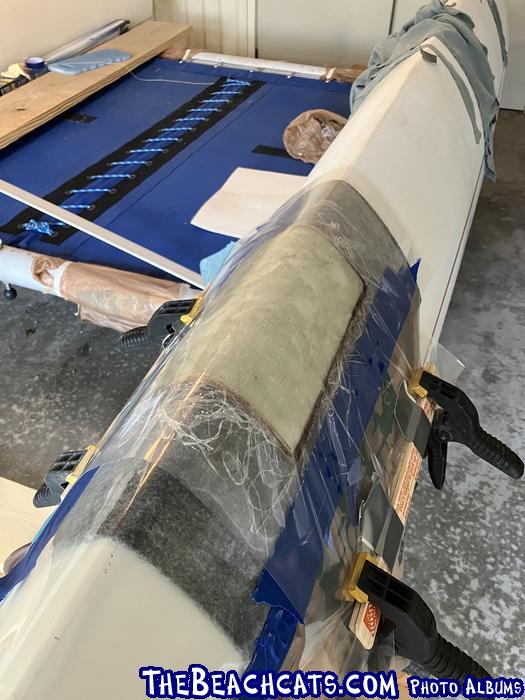

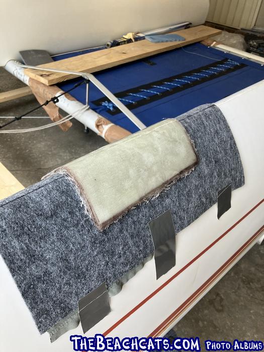

  • I've used a 4" bow stop in the front for years (Hobie 16 and Nacra 5.0) with no problems, rollers in the back with a piece of 1/4" cutting board between the boat and roller after loading. As mentioned above a black rubber version of the stop, like I'm using, will leave occasional small black streaks on your hull, but a non-marking version of the 4" bow stop is available,
    https://www.thebeachcats.com/gallery2/main.php?g2_view=core.DownloadItem&g2_itemId=137687&g2_serialNumber=4
    https://www.amazon.com/St…4-Bow-Stop/dp/B0000AXTD5
    Right now with my boat inverted for maintenance I'm making a custom set of cradles, "the ultimate"
    https://www.thebeachcats.com/gallery2/main.php?g2_view=core.DownloadItem&g2_itemId=137681&g2_serialNumber=4
    https://www.thebeachcats.com/gallery2/main.php?g2_view=core.DownloadItem&g2_itemId=137684&g2_serialNumber=4
  • I have been using the V-shaped bow stops on Franken's trailer for 9 years now. The biggest downside is getting the boat off the trailer by yourself. Take a spray bottle with soapy water and it slides much easier. I also have a block and tackle that I use to pull the boat off and on the trailer. I do agree that the black stops can mark the hull, as with Franken I don't care, but you can get the clear/yellow ones that do not mark the hulls. Many people will have the cradles forward and rollers aft. When they go to travel, they will place cradles over the rollers to distribute the load. Do keep in mind that if a hull sits on a wet bunk with carpet, the hull has a possibility to blister. This is a huge issue with keelboats and the pad stands. standing water is never good.
