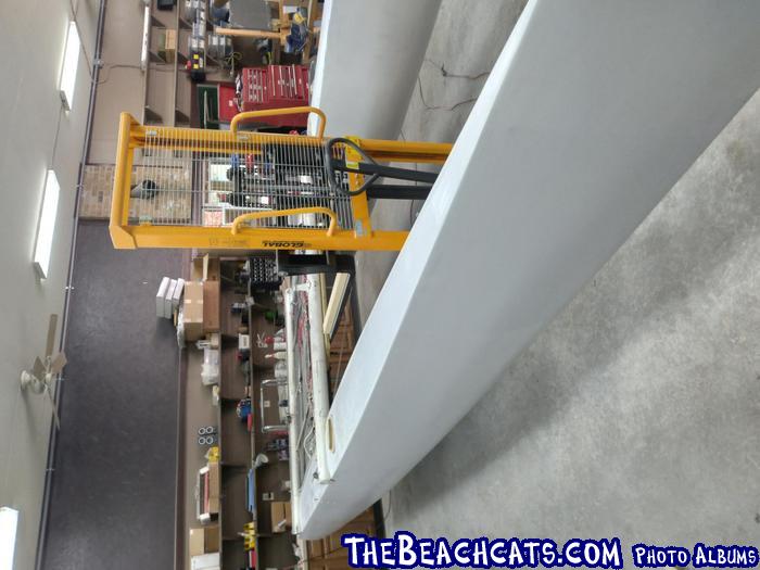

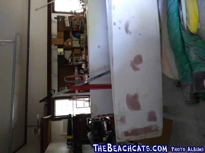

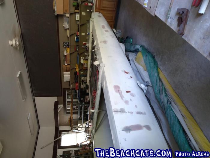

  • charlescarlis . . . And, lastly - we need pictures!
    After fairing several spots and sanding smooth with 240grit
    https://www.thebeachcats.com/gallery2/main.php?g2_view=core.DownloadItem&g2_itemId=136558&g2_serialNumber=4
    A different angle. you can also see all the ropes have been replaced
    https://www.thebeachcats.com/gallery2/main.php?g2_view=core.DownloadItem&g2_itemId=136562&g2_serialNumber=4
    Gotta do some additional sanding on the bottoms were the original owner did some lousy repairs and then sand down the fairing efforts on the opposite side. from there it is just barrier coat, prime, and paint. Last thing is to get the diamond wires replaced and back on the mast and then get the boat and trailer registered and she will be good to go!
