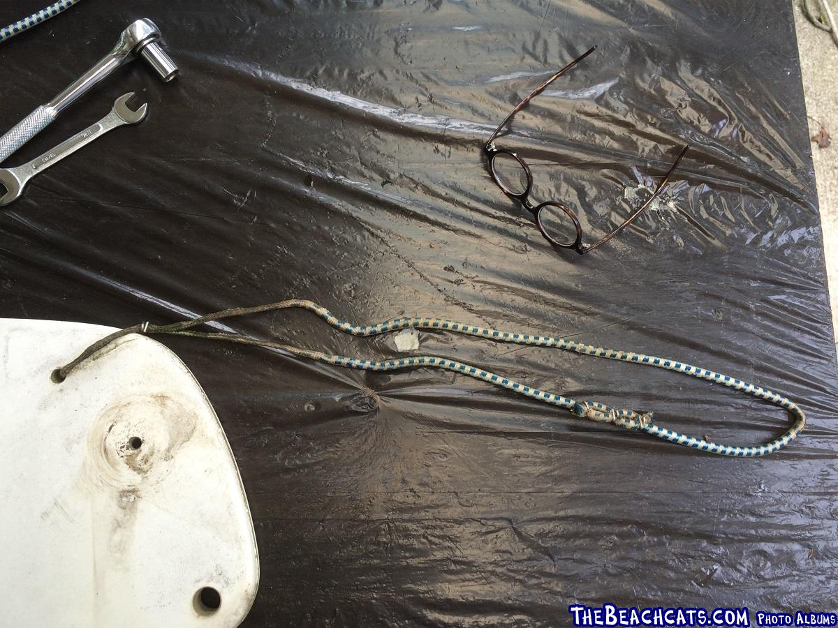

  • Now rebuilding/restoring the rudders on my 1983 5.0. The rudder hold up arangement is a bungee that runs through the tiller handle/tube. One end loops around a hole in the rudder while the other end loops around a clevis pin that the Pivmatic hinges on:
    http://www.thebeachcats.com/gallery2/main.php?g2_view=core.DownloadItem&g2_itemId=119553&g2_serialNumber=3
    The bungee is 1/4" diameter and appears to have had the rubber bands stripped out of it at the rudder attachment end. The entire loop is secured with hog/D rings. My questions are:
    Is this the standard/factory arrangement?
    The bungee has to hold the rudder up when not in the locked down/cleated position yet have enough length to allow it to lengthen w/o too much force or damage when the rudder is moved to the full down position. Is there a spec. for the bungee length?

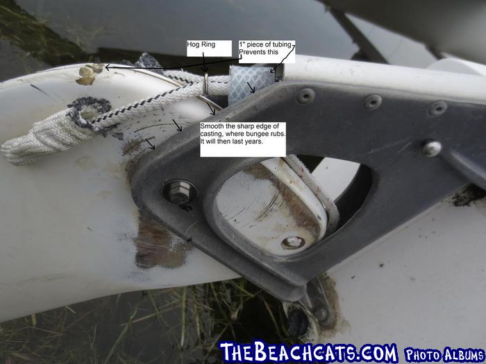

    Don't cut the bungee at first. Feed one end of the full length you buy though the tiller tube, & clamp a vice grip to it. Stretch it somewhat, & feed the remaining length through rudder & back up tiller tube. Grab that end with a second vice grip & tension to desired amount. Hog ring, then cut it.
    I have the exact length I use written down somewhere...but that length depends on how erect you want your rudders.
    The manual says to tie a line to the ends & stretch, I find vice grips easier, but of course if you undo them prematurely,you have to feed them again.
    Either way, with 5/16", it is easier to get the pivmatic pin through,(between the two bungees) if they are stretched. Use good quality bungee, & radius/poilish the edges of the casting where they rub. They will then last for years.
    Don't forget the short piece of tubing,(just an inch of garden hose or plastic tubing that prevents the rudder from hitting end of the tiller tube...you need to put it on as you feed the bungee through.

    Ed, your photo above is worth a thousand words. Having now had time to enlarge and examine it in detail, it appears as though the material going through the hole in the rudder is line, not bungee? Did you loop the bungee inside the tiller tube and tie a short piece of line from that loop to the rudder?

  • Quoteit appears as though the material going through the hole in the rudder is line, not bungee? Did you loop the bungee inside the tiller tube and tie a short piece of line from that loop to the rudder?
    That photo is when I first picked up the boat, & disassembled it for overhaul. All the lines were total crap, (the tramp was using a length of rotted yellow poly)
    This is todays setup.(I added full size photos to the N5.7 Album, along with downhaul) It is the 5.0 rudder, but the 5.7 is done the same way. I attempted to use a piece of abrasion sleeve, where the bungee goes through the rudder blade. It is WAY easier to just smooth the edge of the hole. Getting bungee through with sleeve was a bi*ch.
    http://www.thebeachcats.com/gallery2/main.php?g2_view=core.DownloadItem&g2_itemId=119563&g2_serialNumber=4

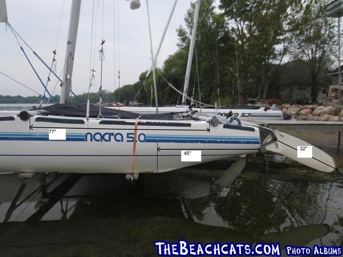

    QuoteI left my rudders limp and made a length of shock cord that has a loop for around the top of the rudder that hooks to the tramp lacing to keep them erect when on my lift.
    This photo is on the lift, today. I let them hang just a bit, so we have steering to round up in a confined space. With the lift cranked, they are over a foot off the water.

    In addition to reducing wear on the bungees, I think your rudder casting edge radiusing/polishing will help reduce wear/scratches/scrapes on the rudder to some degree. Even with plastic spacer shims there could be some contact under high load maneuvers like rounding up hard, being chased by surf or swells etc..
  • The plastic shims were mostly to take up any slop between the blade & casting. If you operate off a sand/gravel beach, you will still get score marks on the blades when grit gets caught between the blade & casting.
