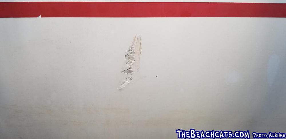

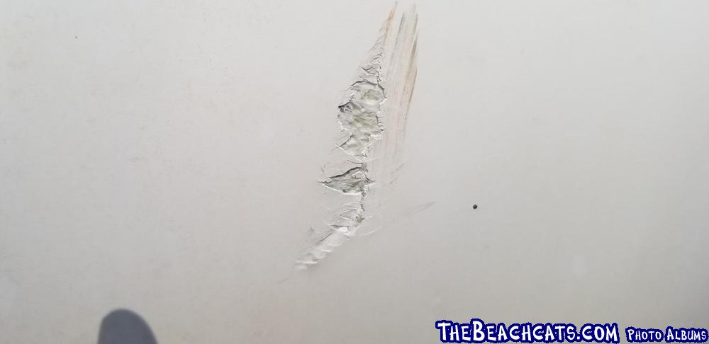

    I had a ladder fall over and hit the boat.
    https://www.thebeachcats.com/gallery2/main.php?g2_view=core.DownloadItem&g2_itemId=135635&g2_serialNumber=4
    https://www.thebeachcats.com/gallery2/main.php?g2_view=core.DownloadItem&g2_itemId=135638&g2_serialNumber=4
    What would be the best way to repair this?
    What tools do I need?

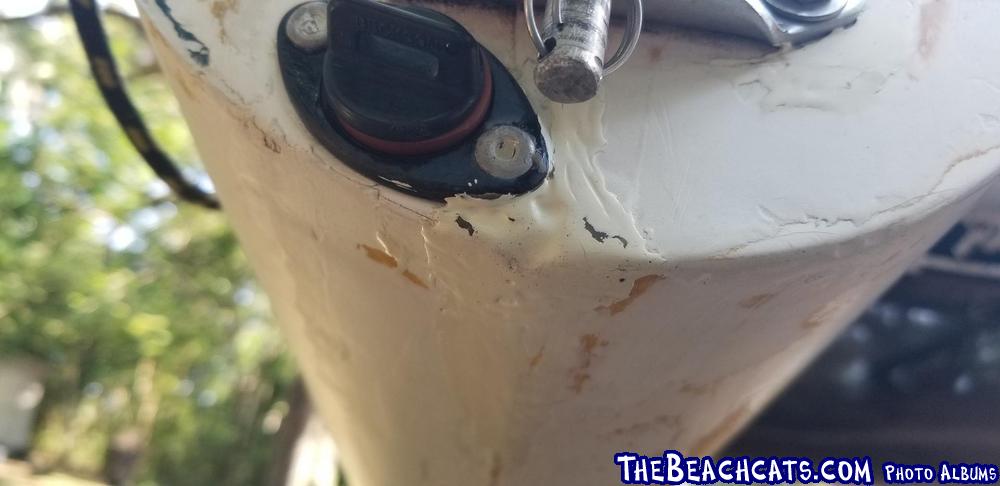

    Also have one small leak from the drain plug area. Does anyone know how to repair this? It leaks from just below the drain plug.

    Do you think it is necessary to cut the hull open and put in a backing plate? I don't think there is an actual puncture.

  • I think I am going to need to remove drain plug. Are the rivets usually just screwed into the fiber glass?
  • I would not cut a hole for those small bits of damage. I would sand the area and just lay up one or two layers of fiberglass cloth. My drain plugs are held in with wood screws.
    I wet down the area that I'm going to fiberglass with resin. Then put cloth over, and use a brush to work resin in from the top as well. A good video example is here:
    https://youtu.be/9jHUI0CiYbs
    I just use a brush and not a roller. I would use fiberglass cloth rather than the mat he shows. Also, you want to use epoxy resin, as polyester resin will attack the foam.

  • Thanks
    Do you think I can just use the epoxy + hardener+ filler material (instead of the cloth) for the damage on the side of the hull?
    There is cloth in the kit but also a filler. Says you can make it like peanut butter with the filler and spread it?
    How much would you sand?
    Does the area need to be perfectly smooth before applying the epoxy mix?
    Don't want to sand a hole in the hull
  • I assume the filler material is to make a thick paste with the epoxy. That is what I've been calling flox on my posts. You can do that if you don't need the strength of the cloth. Probably ok for those small repairs. I would sand with 60 grit, so it is not really that smooth but rough for adhesion. How much? Don't sand through the cloth but sanding off the gelcoat is ok.

  • You need to get the drain plug out and whatever all that white goop is to figure out what’s what. Not sure if previous owner made a mess with that goop or is covering some damage. It looks like it’s spread under the bottom of the hull, if there is damage there it needs a real fix.
  • How do you remove the drain plug?
  • and how do you put it back on after repairing?
  • They are typically held with 2 screws and some silicone sealant. You will have to drill the heads off those rivets and see if it will come out, I don’t know what that goop in the photo is. When done with repair go ahead and put a new plug housing.
  • Is the goop is silicone?
    I am sure this is a common goop
    The boat barely leaks it is a small drip from the drain
    I really do not wnat to remove the drain
    Will the boat need to be flipped to do this repair?
  • It’s super easy to do but if you don’t want to do it don’t do it, these are pretty minor things that could be left alone but you asked how to fix them and there is some reason the previous owner riveted the plug housing in place and smeared some white goop all over it, probably some sort of damage. If it’s not leaking just sail it

  • I think the drain plugs are always riveted in place.
    The boat has been repaired before.
    I never got the how to do it part?
  • The drain plug doesn't screw out from the socket?

  • The drain plug screw out but the entire thing is riveted onto the hull.
    Anyway I finished the repair. Was pretty easy.
    Used the west system 106 with epoxy and hardener.
    Hope it will work
