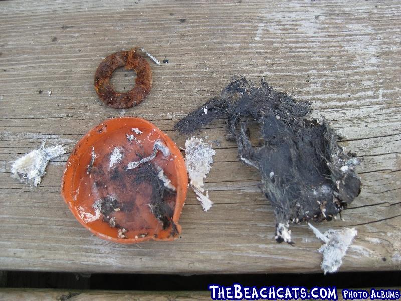

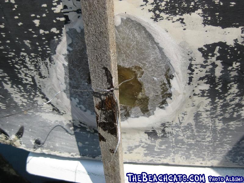

  • I had the exact same issue when I first brought my N5.7 home. Someone stuffed a plastic pop lid along with some goop into a finger sized hole.
    Light pressurization & soapy water found it.
    I ground out the damage, made a “taco” out of a few layers of cloth,(with a bit of line so I could insert it into the hull then pull flush).

  • Yikes, some people are idiots! Here are Edchris177's pics:
    https://www.thebeachcats.com/gallery2/main.php?g2_view=core.DownloadItem&g2_itemId=76637&g2_serialNumber=3
    https://www.thebeachcats.com/gallery2/main.php?g2_view=core.DownloadItem&g2_itemId=76638&g2_serialNumber=3
