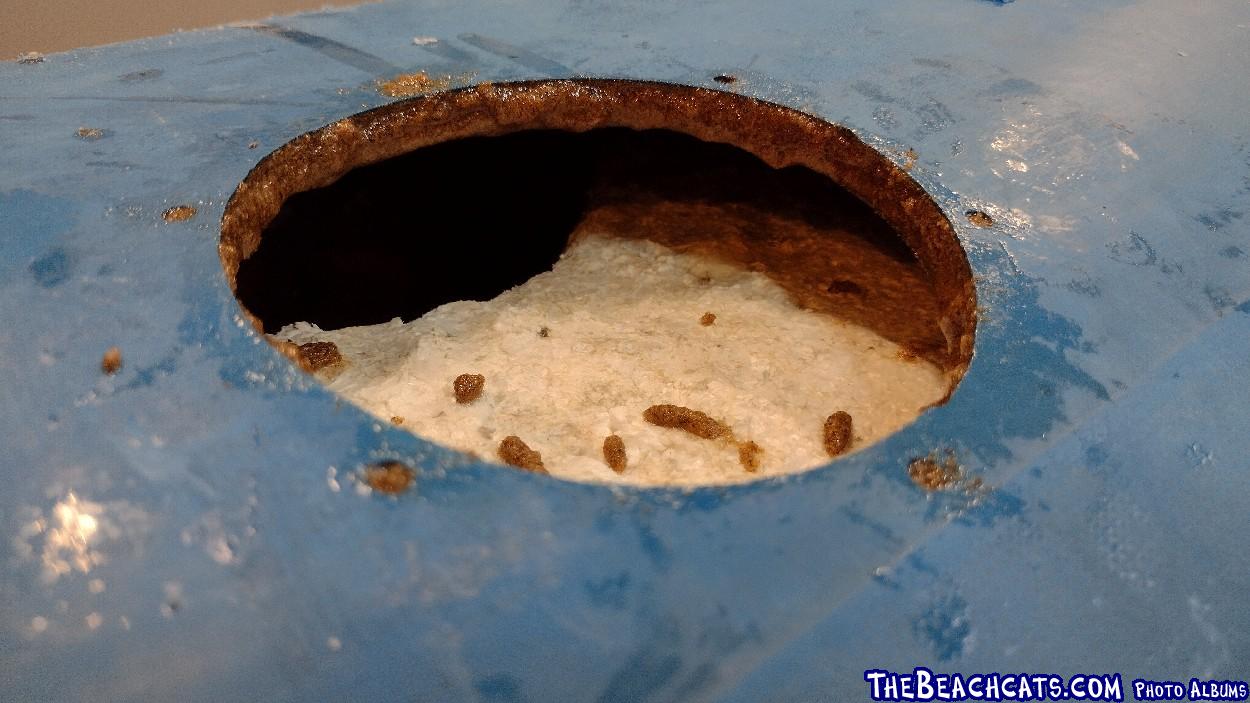

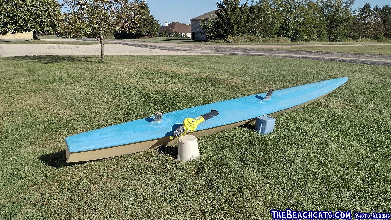

  • A quick update, with pics to follow. I got my 4" hatches and cut holes in the hulls. There is water in there. Super humid and the inside surfaces were damp. They are in the sun with a leaf blower shooting air in the 100 lb hull. I just found my other leaf blower and will set up both when I can.

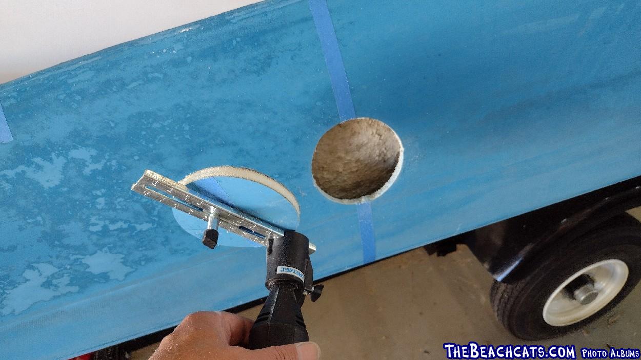

  • I used my nifty dremel attachment to cut the holes. I practiced on some scrap luann ply to get the setting right.
    https://www.thebeachcats.com/gallery2/main.php?g2_view=core.DownloadItem&g2_itemId=135613&g2_serialNumber=3
    Hatch slid in:
    https://www.thebeachcats.com/gallery2/main.php?g2_view=core.DownloadItem&g2_itemId=135614&g2_serialNumber=3

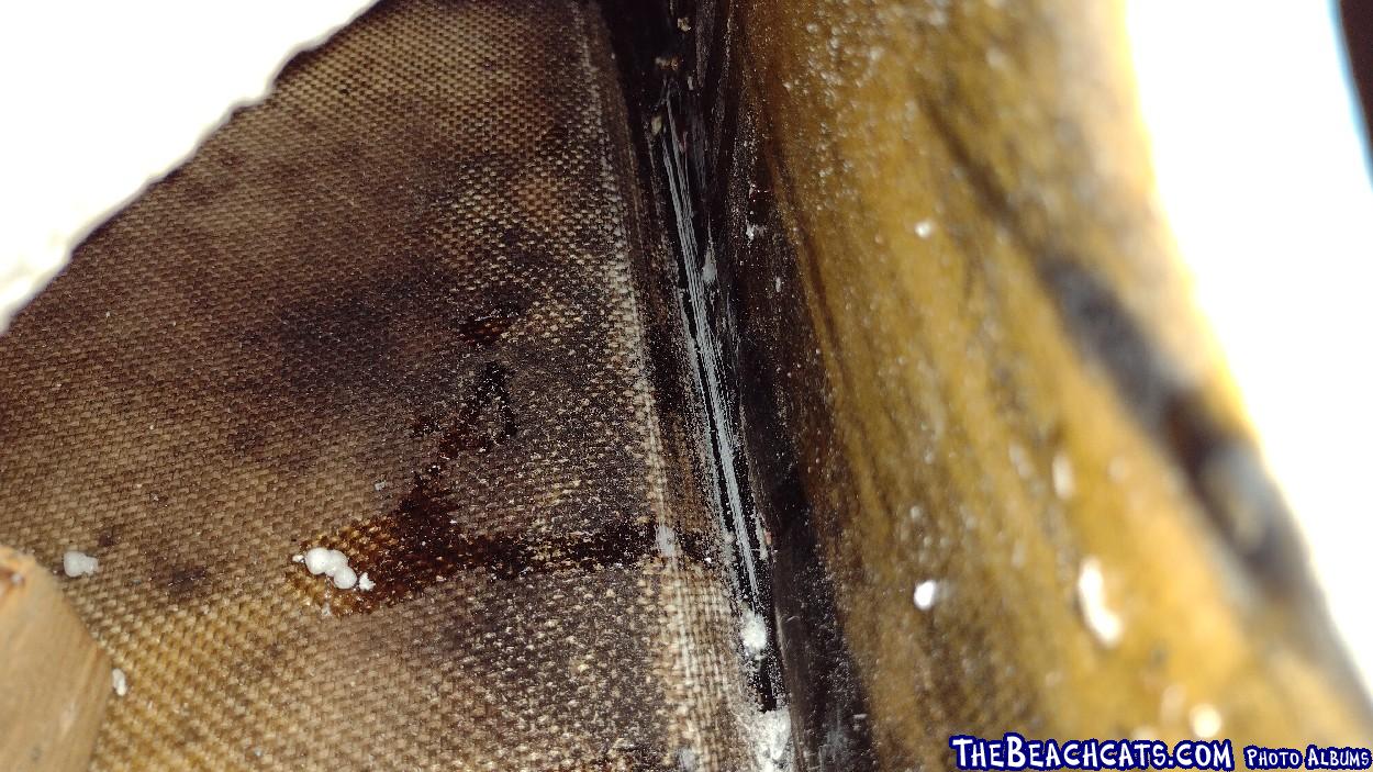

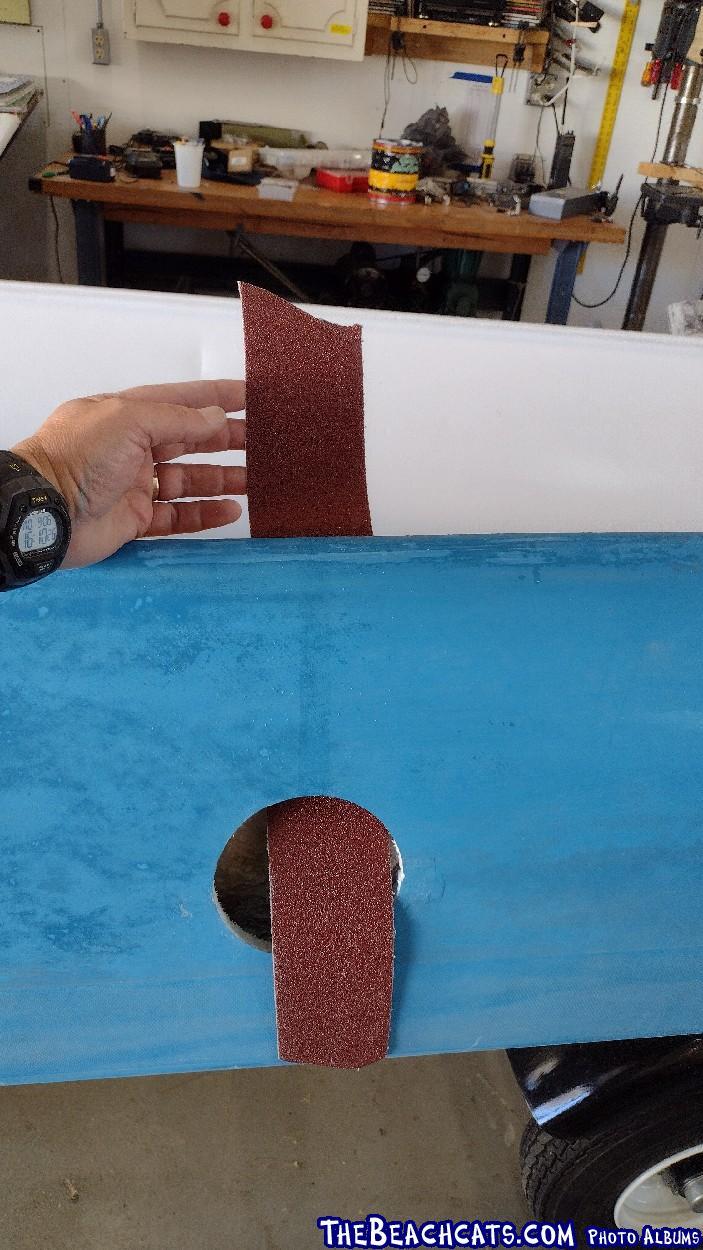

    I found a major disbond on this hull. I installed the hatch to be centered on it. Here's a video of the disbond. It had been "fixed" with plumber's putty.
    https://youtu.be/ChIBtVZi0H0
    I sanded out the seam.
    https://www.thebeachcats.com/gallery2/main.php?g2_view=core.DownloadItem&g2_itemId=135615&g2_serialNumber=3
    It was wet inside. I stuck the hull out in the sun and ran the leaf blower in it.
    https://www.thebeachcats.com/gallery2/main.php?g2_view=core.DownloadItem&g2_itemId=135616&g2_serialNumber=3

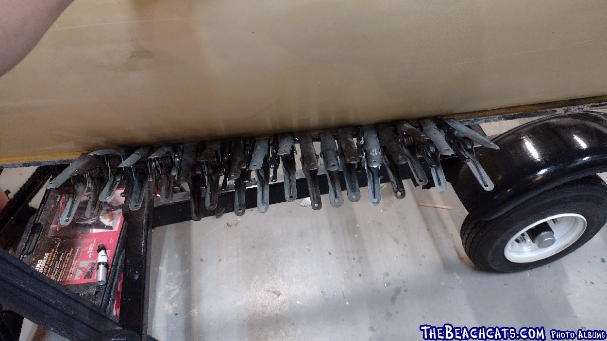

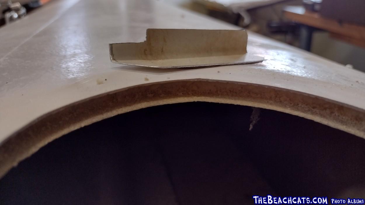

  • The seam is bonding. I worked epoxy into the seam, both inside and outside, and clamped the crap out of it.
    https://www.thebeachcats.com/gallery2/main.php?g2_view=core.DownloadItem&g2_itemId=135620&g2_serialNumber=3
    I'm going to fair that seam inside with some flox, and lay a ply across as well. I think it will be good.

  • Here is a view inside after a bit of sanding. Hard to get my arm in there, sort of wish I had 5" inspection ports.
    https://www.thebeachcats.com/gallery2/main.php?g2_view=core.DownloadItem&g2_itemId=135625&g2_serialNumber=3
    You can see the nice epoxy fillet at the joint. I'm pretty happy with this so far. I think I'll fill in the joint a little with some flox and glass it, just to ensure strength. I'm also going to leak test this hull, using the little shop vac and my modified adapter with the holes in it. Plus I'll tape over the inspection port hole, assuming the tape will be weaker than the hull.

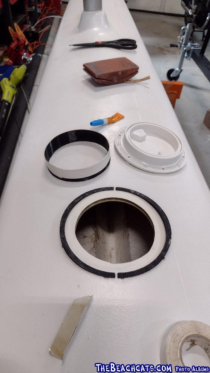

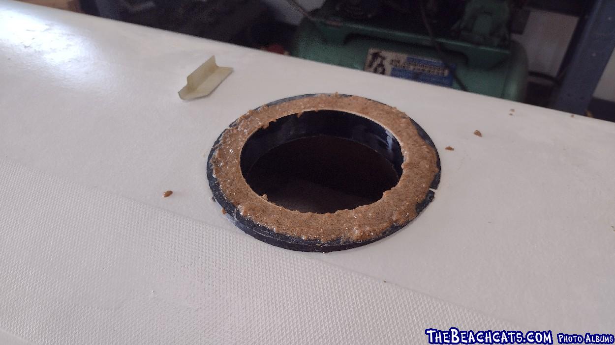

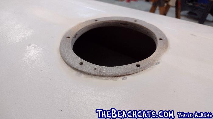

  • Here I've scraped some of the foam out around the perimeter of the hole. This is so I can fill the space with flox. Will make the hole stronger, plus we want to be able to screw down to it.
    https://www.thebeachcats.com/gallery2/main.php?g2_view=core.DownloadItem&g2_itemId=135651&g2_serialNumber=3

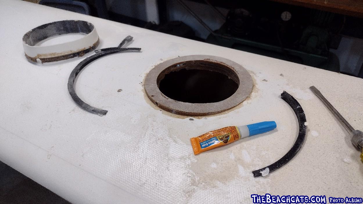

    I designed and printed some tools to help with the floxing. The two half circle tools are glued down with superglue in a few spots. I made it in two pieces because my printer was not big enough. This will actually make it easier to remove, so it's good for that reason. The circular part with the white electrical tape on it is to hold the flox inside the hole, plus give me a dam to keep the flox from going into the hull.
    https://www.thebeachcats.com/gallery2/main.php?g2_view=core.DownloadItem&g2_itemId=135652&g2_serialNumber=3
    Here it is all floxed up and curing.
    https://www.thebeachcats.com/gallery2/main.php?g2_view=core.DownloadItem&g2_itemId=135653&g2_serialNumber=3

  • I went over and did a little sanding, then popped the forms off. There are a couple of voids but overall it looks good.
    https://www.thebeachcats.com/gallery2/main.php?g2_view=core.DownloadItem&g2_itemId=135673&g2_serialNumber=3

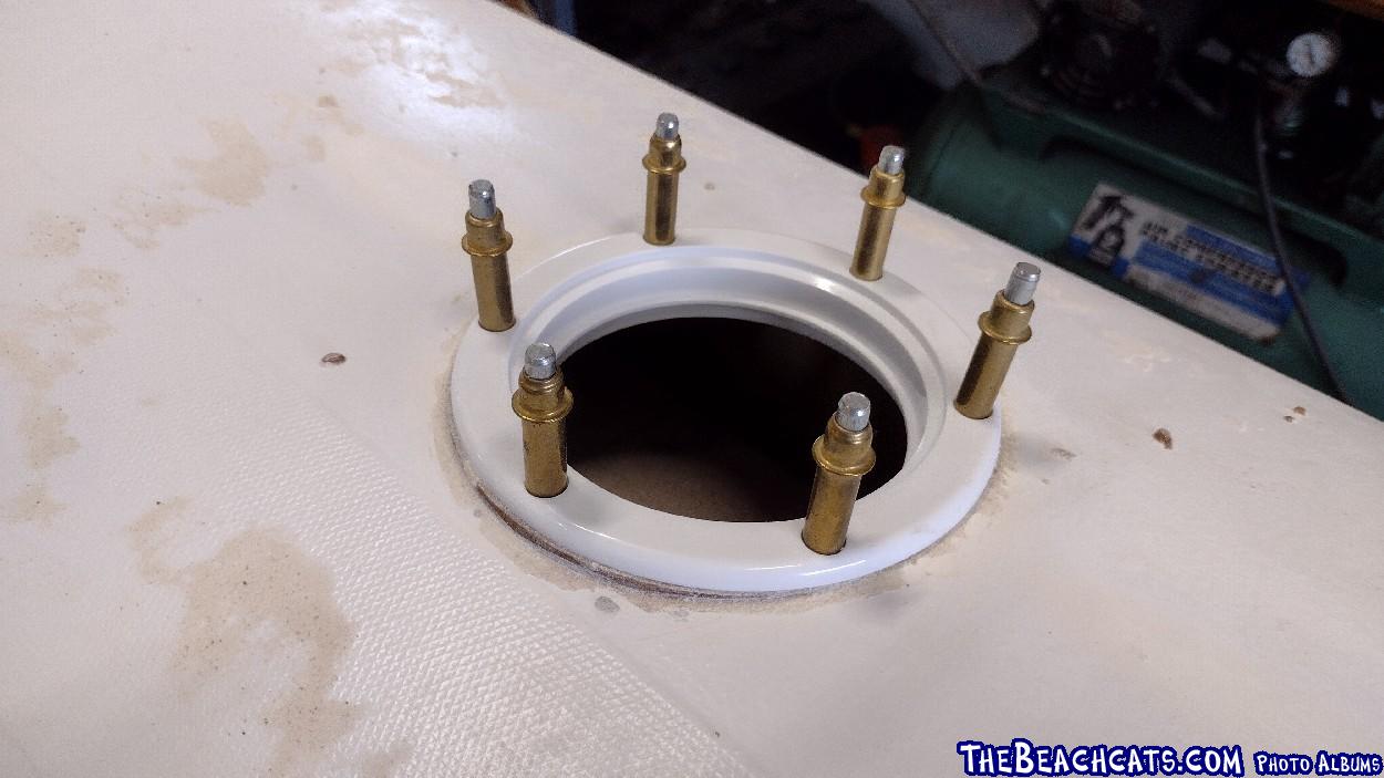

  • On the first hull I tried to get flox in place of the foam core that I removed, and I also tried to cast the top at the same time. Bad idea. Works better to get the flox between the hull glass layers first. The mounting holes were premature here. It's better to make the flox thick enought that it won't run, and inject it into place. After it dries, sand it and move onto the next phase.
    https://www.thebeachcats.com/gallery2/main.php?g2_view=core.DownloadItem&g2_itemId=135739&g2_serialNumber=3
    Here is the drilling process.
    https://www.thebeachcats.com/gallery2/main.php?g2_view=core.DownloadItem&g2_itemId=135737&g2_serialNumber=3
    Finished hatch install fairing. Just need to paint and screw it on.
    https://www.thebeachcats.com/gallery2/main.php?g2_view=core.DownloadItem&g2_itemId=135732&g2_serialNumber=4
    I've got the other hull port mount sanded flat. I made a big sanding block out of plywood so I could make it flat. I just need to sand the extra flox out of the hole so the hatch will go in, drill the holes, then paint the hull.

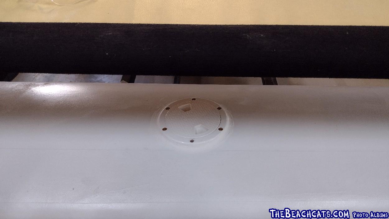

  • Good idea. I think with the flox between the layers, and even the ring bolted in, that will also be adding structure. I've placed my hatches under the tramp, so they will never be stepped on. I'm assuming the loads there are lower than just in front of the pylons.
    I do worry about how much weight I'm adding. Just like in aviation, weight is the enemy. I plan to weigh the hulls again after this project is complete.

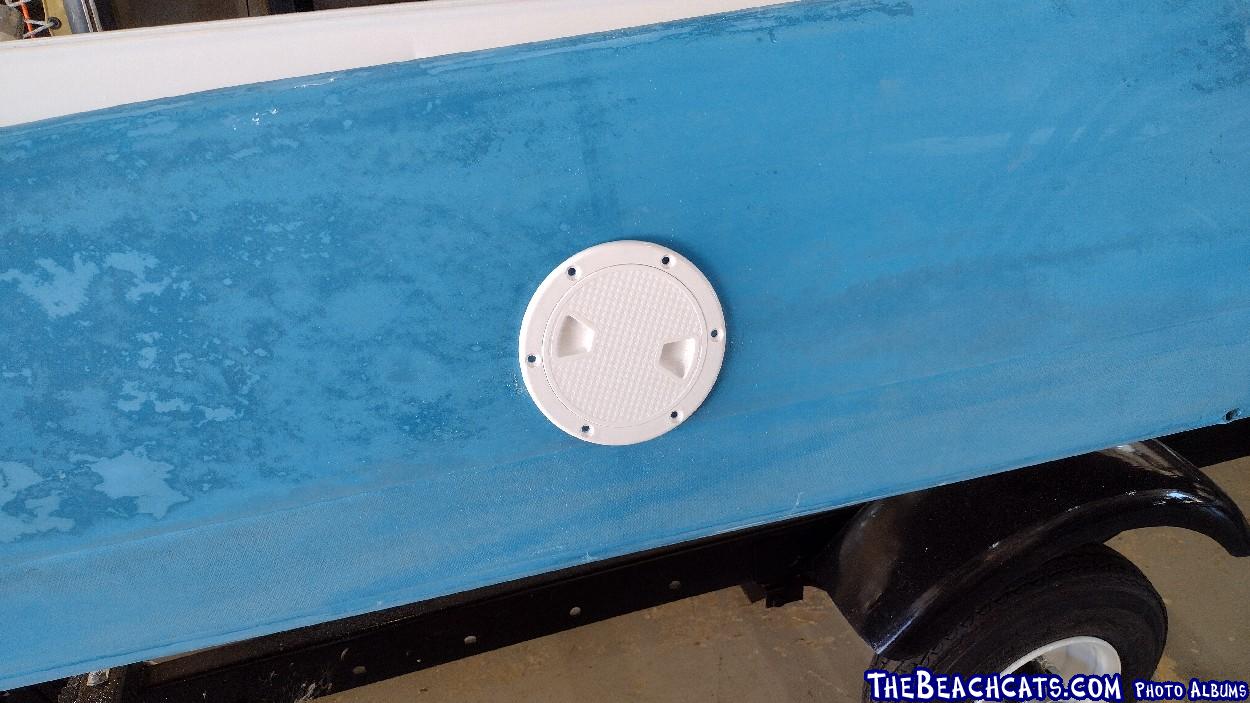

  • Here is one of the finished hatches.
    https://www.thebeachcats.com/gallery2/main.php?g2_view=core.DownloadItem&g2_itemId=135769&g2_serialNumber=3

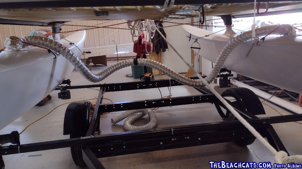

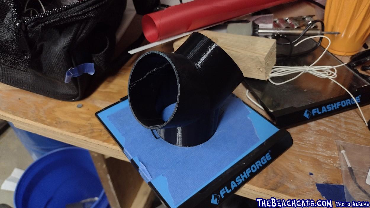

  • I designed and printed out a splitter for my leaf blower.
    https://www.thebeachcats.com/gallery2/main.php?g2_view=core.DownloadItem&g2_itemId=135829&g2_serialNumber=3
    Bought some ducting and ran it to each hatch.
    https://www.thebeachcats.com/gallery2/main.php?g2_view=core.DownloadItem&g2_itemId=135830&g2_serialNumber=3
