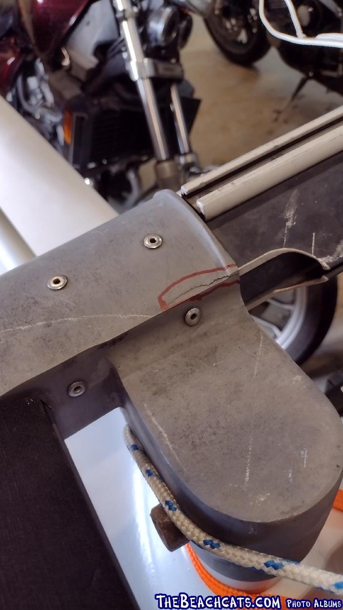

  • Hey all,
    I noticed this after sailing today. Should I replace right away or over the winter?

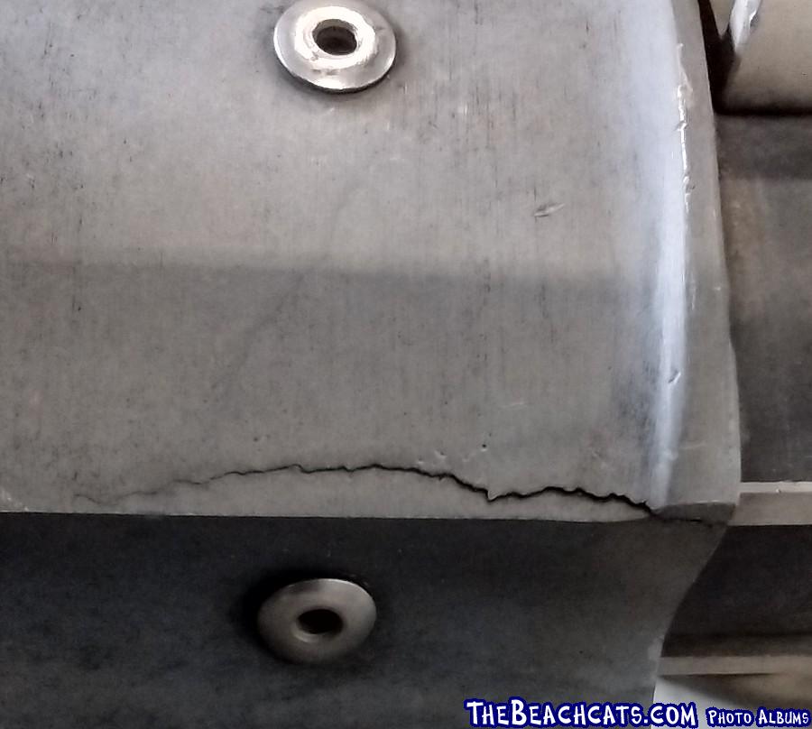

    Here is a closeup, before I circled it with red marker.
    https://www.thebeachcats.com/gallery2/main.php?g2_view=core.DownloadItem&g2_itemId=135511&g2_serialNumber=3

  • I'd replace that right away and while I was at i would glue all the corner posts and rails for stiffess
    I just did mine this year and my sons 2 years ago. Amazing difference. I used eest systems epoxy

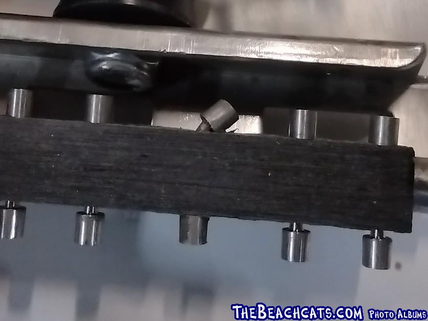

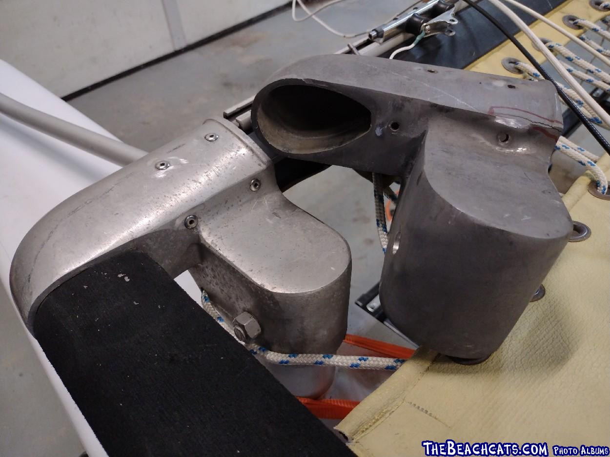

  • I chickened out on the bonding. Mostly because I don't know what is going to break next. Partly because of time. I have an airplane to finish.
    It seems Hobie drills holes by hand, using the force. The good thing about this is the old and new holes totally didn't line up, so I just drilled new holes in the crossbeam. I've restored a 1946 Cessna C140 before, and they had good tooling at Cessna. I could drill out wing parts from one airplane and it would rivet right up to parts from another airplane.
    https://www.thebeachcats.com/gallery2/main.php?g2_view=core.DownloadItem&g2_itemId=135542&g2_serialNumber=3
    I took a look at the traveler while I had the casting off, and it had a bent roller. So, I put the other one on.
    https://www.thebeachcats.com/gallery2/main.php?g2_view=core.DownloadItem&g2_itemId=135543&g2_serialNumber=3

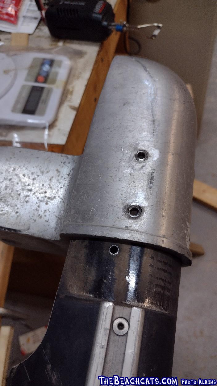

    Done and ready to sail again. Unfortunately wind seems cancelled for the labor day holiday.
    https://www.thebeachcats.com/gallery2/main.php?g2_view=core.DownloadItem&g2_itemId=135547&g2_serialNumber=3
    So has anybody ever welded a casting before? Would be good to have a spare part if needed.

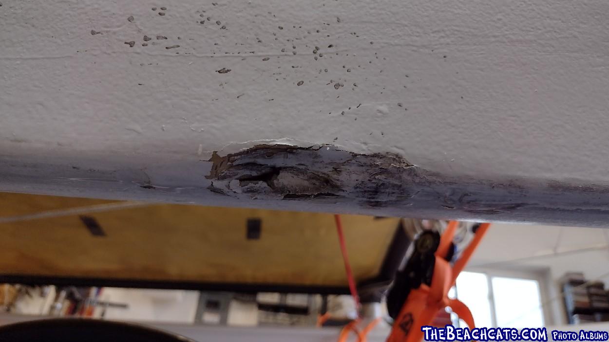

  • As mentioned in the "Bondo" thread, we found one of the hulls had a hole in the bottom and had been patched with Bondo. That failed today. I am pretty glad we didn't glue the trampoline frame to the pylons, I would have been screwed. I'll fix this hull most likely, but also have a spare starboard hull that I can swap in.
    Here is the hole in the bottom:
    https://www.thebeachcats.com/gallery2/main.php?g2_view=core.DownloadItem&g2_itemId=135597&g2_serialNumber=3
