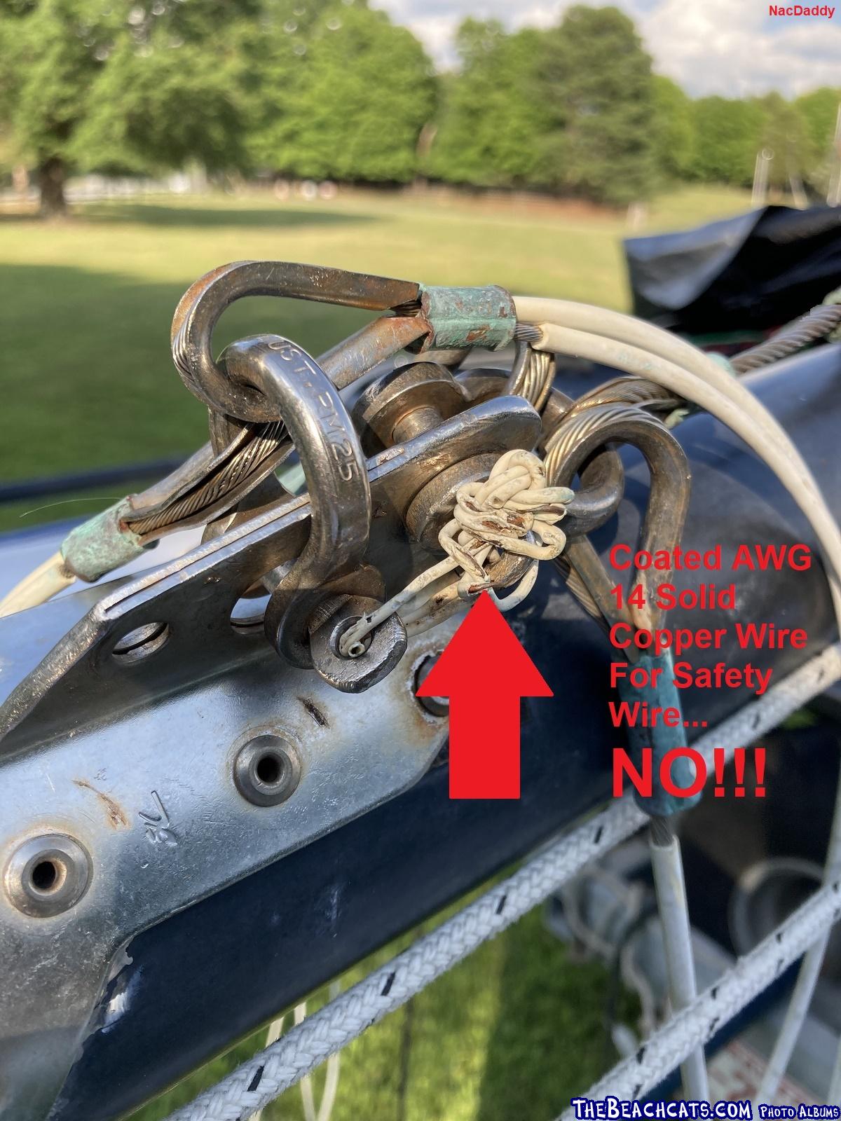

  • Here's my latest WTF moment/find.
    https://www.thebeachcats.com/gallery2/main.php?g2_view=core.DownloadItem&g2_itemId=135527&g2_serialNumber=3
    Coated AWG 14 solid copper wire as safety wire. Please do not do this. Yes, maybe in a pinch temporarily, but not as a permanent installation. At least who ever did this had safety wire holes in the shackle pin heads and knew that backout restraint was necessary. Many of the shackles I come across these days don't have the holes and you must drill them yourself (yes, even the name brand stuff). I see many folks these days with no safety wire anywhere and I stay as far away from them as possible for obvious reasons. Here is the correct wire (you can buy it many other places) and technique. I use 0.032" diameter wire some folks use 0.041" diameter.

  • My H16 came with electrical wire everywhere, including in place of a ring or cotter pin on pins that hold the shrouds. Pretty scary. That's all gone now.

    Yep, right out of the Hobie 16 manual (and every other Hobie manual I've ever seen). Mr. Alter knew what to do and it's proven a safe practice for decades. Not sure why anyone would say it's not necessary. They don't put holes in shackle pin heads for fun, it's for safety. Besides it just takes a minute and cost pennies.
    https://www.thebeachcats.com/gallery2/main.php?g2_view=core.DownloadItem&g2_itemId=135583&g2_serialNumber=4
  • That photo should be a lesson in how NOT to use lock wire.
    No one with any experience in aviation would do such an amateur job.
    That meat hook end is just waiting to stab holes in your sail, or your flesh.
