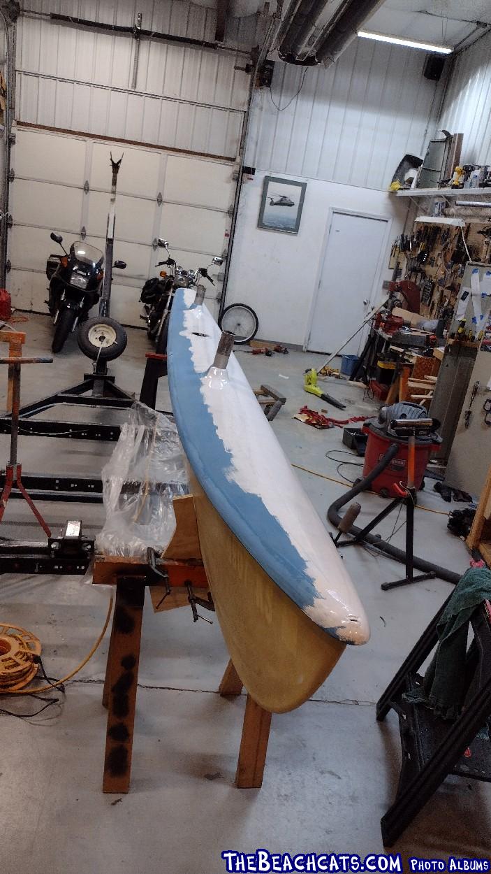

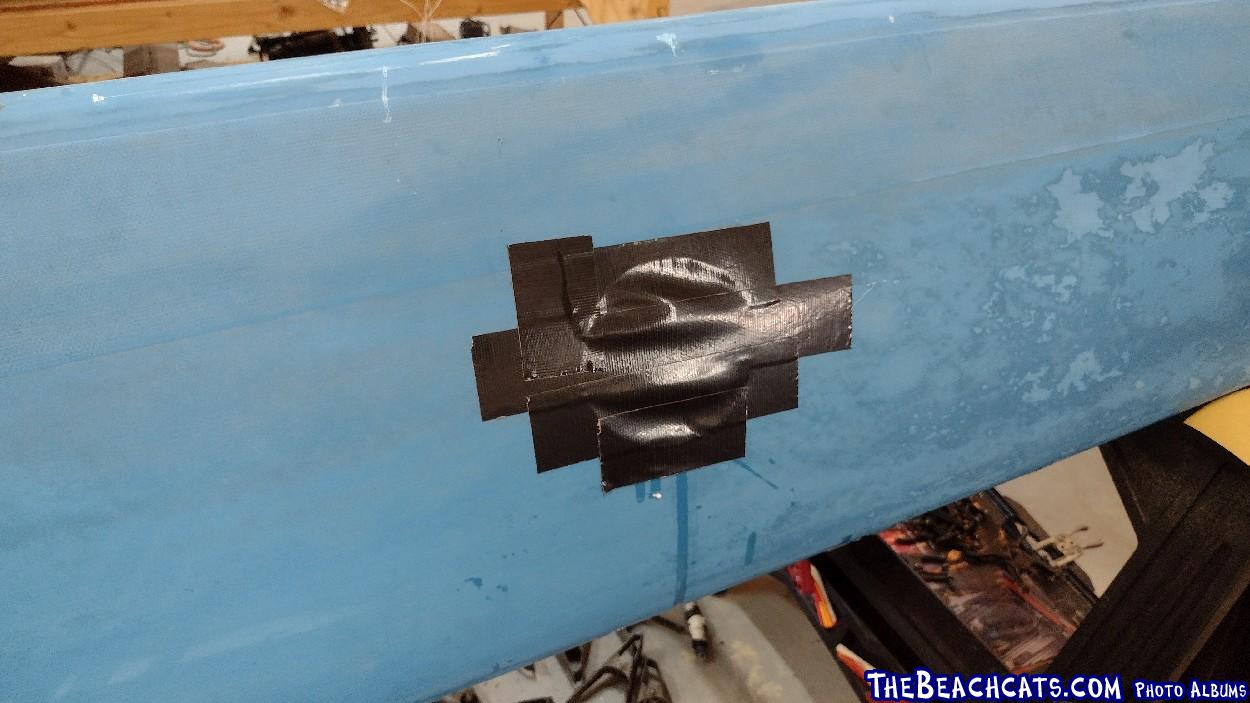

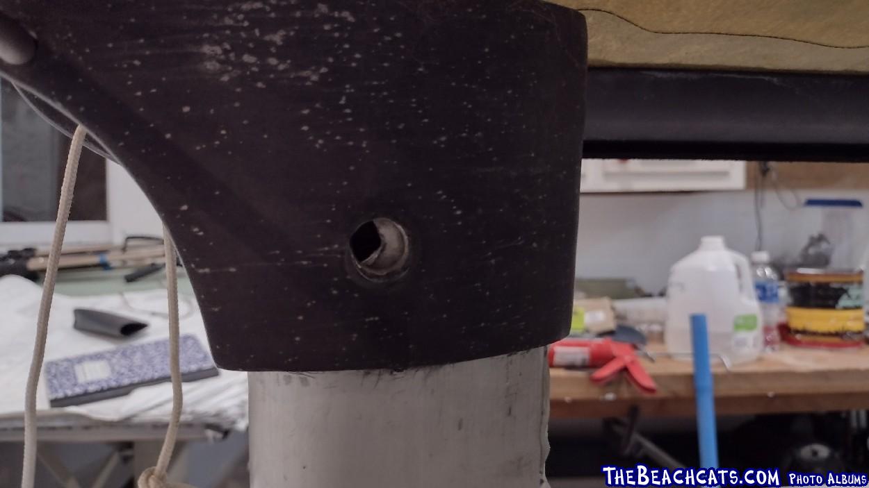

One of the good things about putting hatches on the boat is it lets you add a fuse for a hull pressure test. I taped over the hole, figuring the tape should fail before the hull. If the hull failed first, then it's probably toast anyway. I also used my little shop vac, instead of the big one, and didn't plug the hose in all the way. You really don't need much pressure.
And hey - I found a leak!
https://youtu.be/FCjPAok_XLI

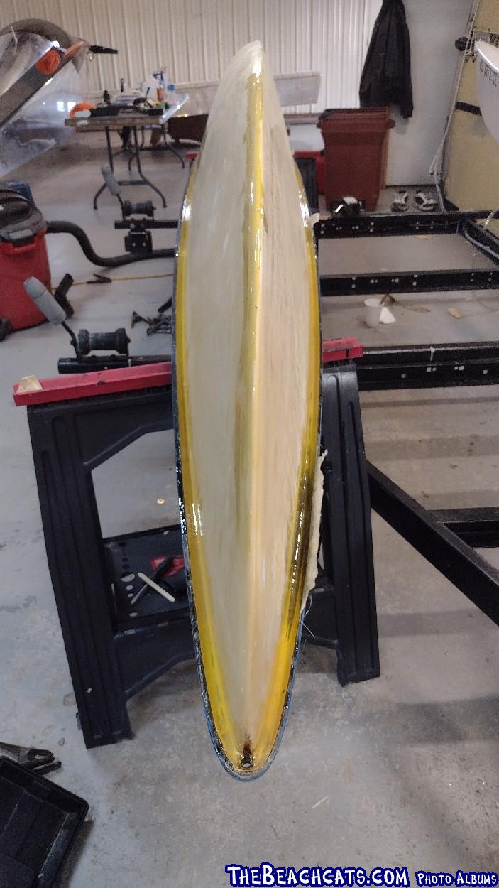

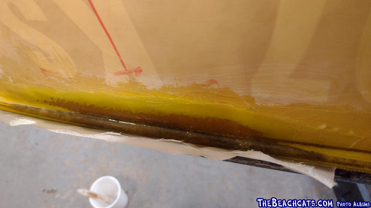

When I took off all the silicone, and sanded out the cracked gelcoat, the glass looks like it had a void from the beginning (1978).
I put about 5 plies of 2oz cloth on, 3 on a straight cut and 2 on a 45 degree bias. I made each one a little shorter.
I actually took off all the silicone, sanded out the cracks in the gelcoat, and flooded them all with some resin.
Next I'll do another leak check, then wet sand & paint.
Also, no leaks from my repair that I ended up documenting on the ventilation hatch thread. I think that repair is pretty solid.

I did another leak check and found a couple of small ones under the lip. This is just like looking for oil leaks on engines - get the big ones first, then the medium ones, then the small ones. I've ground out the gelcoat in the two leaky areas and have laminated a few plies under the lip. This hull should be good.

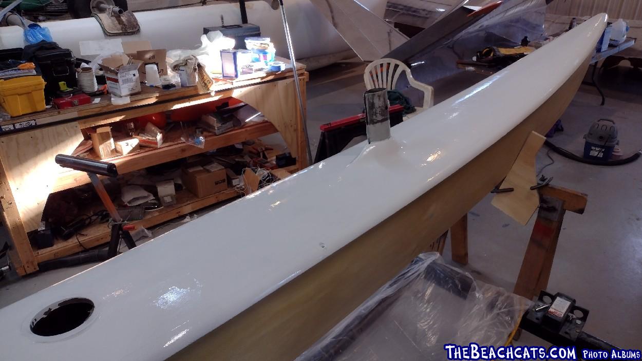

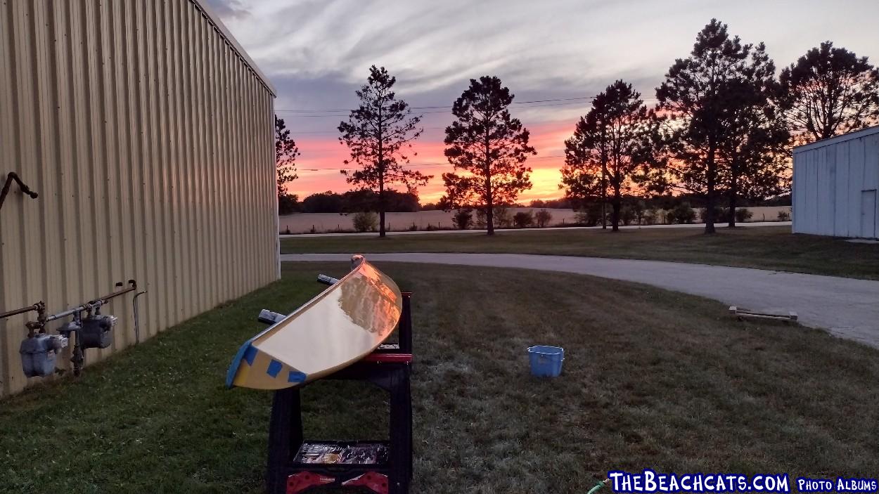

Repairs complete. Wet sanding:
Paint progress:
Top now has two coats.
As I get closer to project completion, wind has been repealed again. Yesterday the wind was awesome.
