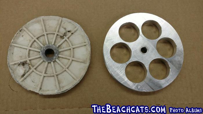

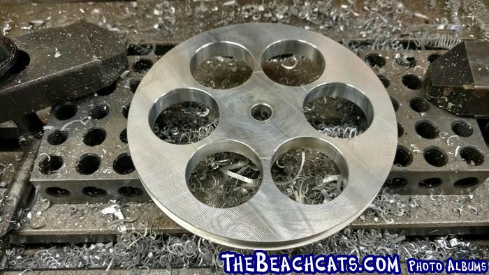

  • I found these pictures in our albums, and on the Hobie forums. I wonder if user in812 is still here or not.
    https://www.thebeachcats.com/gallery2/main.php?g2_view=core.DownloadItem&g2_itemId=130238&g2_serialNumber=4
    https://www.thebeachcats.com/gallery2/main.php?g2_view=core.DownloadItem&g2_itemId=130234&g2_serialNumber=4
    May be a good off season project. The problem with an old one is it is likely worn out or brittle from age. I am not sure I'd make one out of aluminum. Nylon or phenolic would probably work and be lighter.
