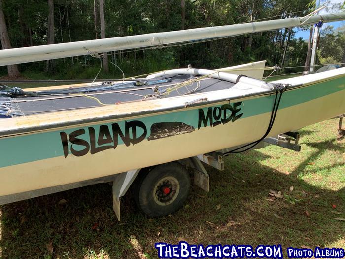

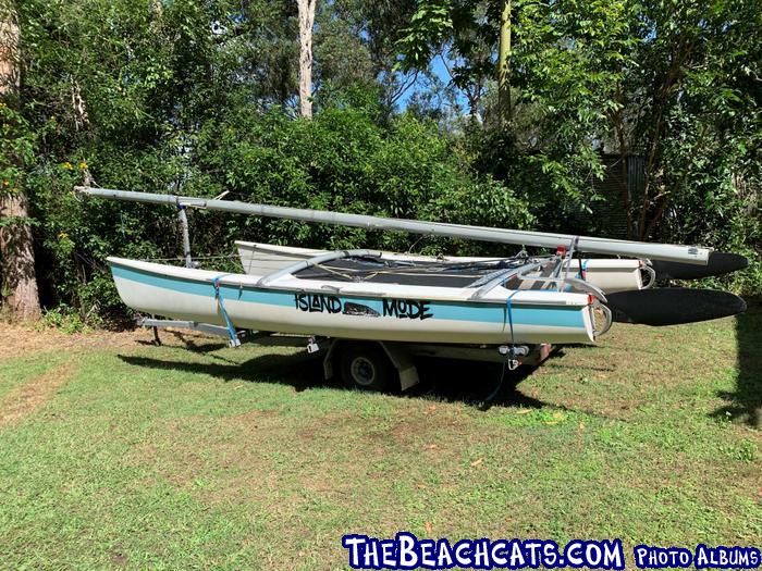

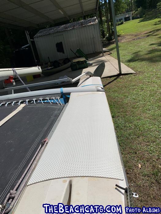

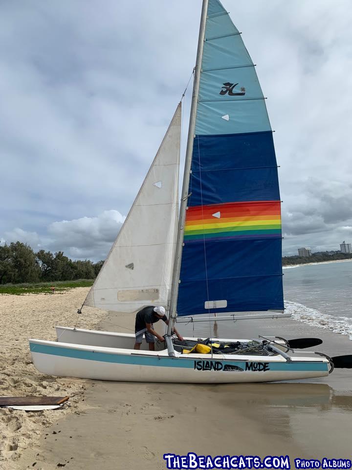

    QuoteHobie 18 approx 2000 model with broken rudder for sale. Good tralier , hulls , sails , everything in good condition except broken rudder and rudder casting on one side. Comes with all the gear too. There is two trapezes and one harness.
    This has come up for 2k (AUD), any thoughts/opinions, obviously it's had a repaired soft spot, which he's repaired by injected resin and then covering.
