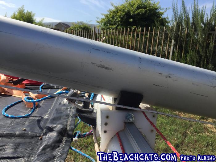

For a mast saddle, I got a 4 x 6 sch 40 Saddle Tee. The saddle carries the mast and the hub was cut to the radius of the rear crossbar. I positioned the mast on the saddle and held it on the crossbar to mark where to cut the 1-inch notch for the traveler rail. I don't have a picture of it, but here is one from the FlexPVC site to give you an ideal

Andinista- that is Well engineered/built solution!
