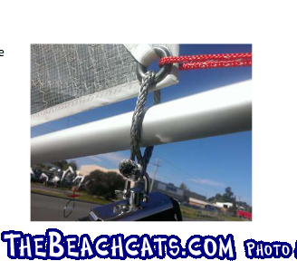

  • i have upgraded my blocks on most of my cats
    h18 i went from stock to a harken 7:1 rachomatic then to an 8:1
    on my mystere i went from a 8:1 to 9 and occasionally a 10:1 (via dyneema stropes)
    all with no issue.
    currently my boats i added a dynema strope to spread the load (actually to get the blocks directly above the beam)
    https://www.thebeachcats.com/gallery2/main.php?g2_view=core.DownloadItem&g2_itemId=127659&g2_serialNumber=3&g2_GALLERYSID=7ac8650f674bb06170090e742038b1ff
    don't need much more than this:
    https://www.thebeachcats.com/gallery2/main.php?g2_view=core.DownloadItem&g2_itemId=133587&g2_serialNumber=3

    MN3 - PERFECT photo! That's what I was talking about. The Hobie boom is a rectangular cross section and the outhaul car inside the boom takes up some space towards the end of it. With my current EP made sail, it seemed as if I couldn't get enough outhaul on it before it would run into the stop (I think). Adding a soft shackle/strope at the end makes sense and gets the block out farther on the boom, improving leverage of the main sheet.

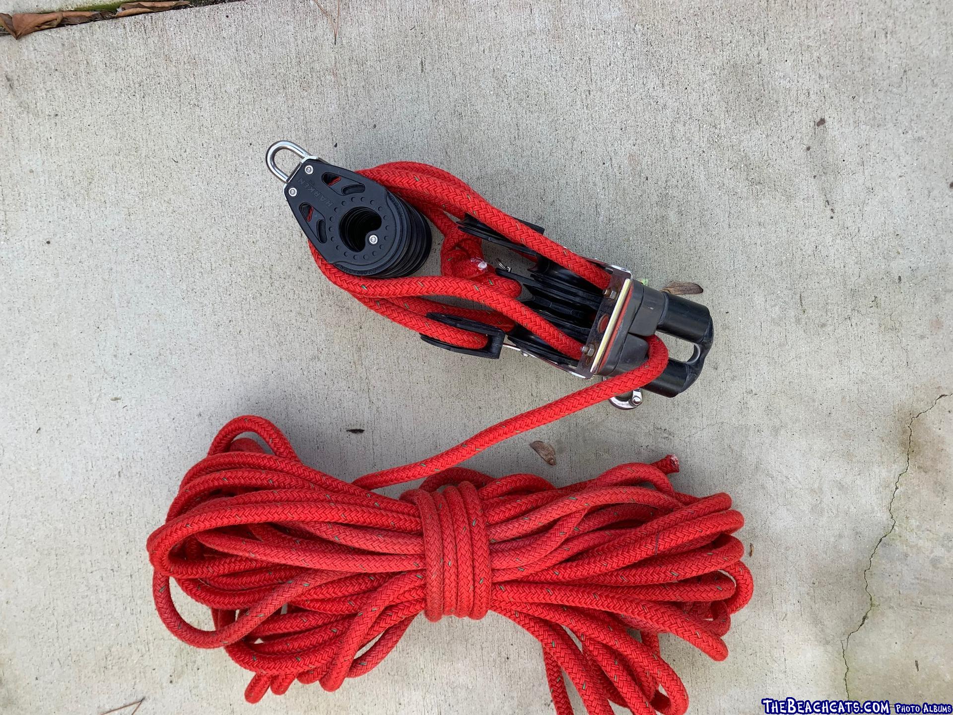

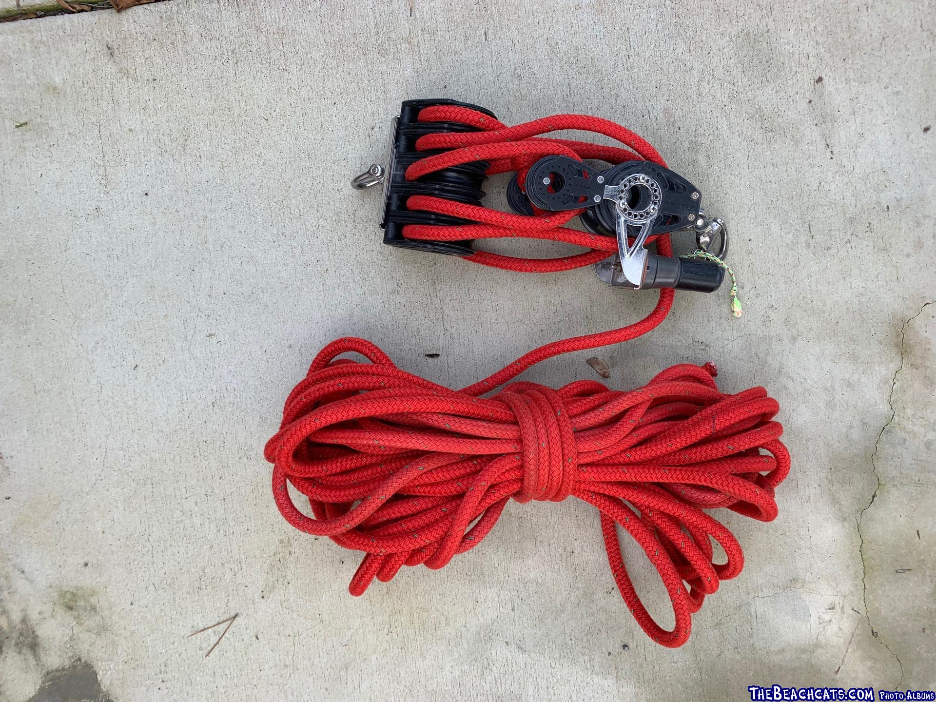

  • I just send MN3 my pictures. Glad to hear you got them reeved, sorry to hear it took so long. My friend who bought my 12:1 originally had hand sketches from someone at Harken that he worked with to figure it out.

  • https://www.thebeachcats.com/gallery2/main.php?g2_view=core.DownloadItem&g2_itemId=133634&g2_serialNumber=3
    https://www.thebeachcats.com/gallery2/main.php?g2_view=core.DownloadItem&g2_itemId=133635&g2_serialNumber=3
    looks to me you could remove that entire cleat assembly and replace with a stock cleat. use some nylon washers or composite ones and build up a fairlead with an eyestrap and avoid all those issues
