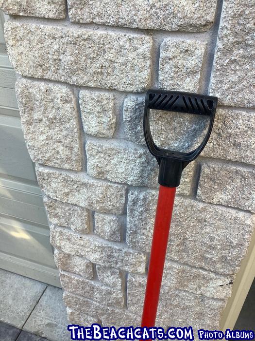

  • You can probably cobble something together out of PVC conduit & appropriate cement, but it might be easier to attach the end of a premade handle.
    Many cheaply built garden tools, or snow shovel,(probably not common in Sarasota), have a plastic D handle which could be used.
    This is on a cheap shovel,it would fit the Arriba shaft almost perfectly.
    https://www.thebeachcats.com/gallery2/main.php?g2_view=core.DownloadItem&g2_itemId=133386&g2_serialNumber=4
    Edited by Edchris177 on Aug 01, 2020 - 09:19 AM.

  • Edchris177You can probably cobble something together out of PVC conduit & appropriate cement, but it might be easier to attach the end of a premade handle.
    This is on a cheap shovel, it would fit the Arriba shaft almost perfectly.
    https://www.thebeachcats.com/gallery2/main.php?g2_view=core.DownloadItem&g2_itemId=133386&g2_serialNumber=4Edited by Edchris177 on Aug 01, 2020 - 09:19 AM.
    +1

    That particular handle is very lightweight moulded ABS and is strongly designed. Throwing your tiller extension overboard is never a wise practice due to the excess wear on all parts while it constantly banging around, being hard to reclaim when you need it, and the senseless drag created if you are racing. When I am sitting on the back rail steering I have both the crossbar and the extension in the same hand. You could even put adhesive velcro on both pieces to have them passively attach in this position.
