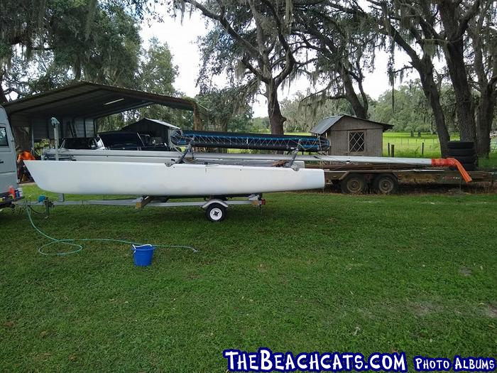

  • I tow my Prindle 18-2 with a Sprinter van, not the high top but the medium version with 5'10" headroom in the back. Still it is very high. First thing I would note is that I am always careful to make sure where the base of the mast is located in relation to where the back of the van is during a tight turn. Next is that raising the base of the mast over the top of the van means the top of the mast is much lower to the ground so bumps may be a problem. Bottom line is I have been simply getting the base of the mast as close to the back of the Sprinter as I can without a close turning radius causing issues and putting red/orange plastic that flaps in the wind on the top of the mast.
    https://www.thebeachcats.com/gallery2/main.php?g2_view=core.DownloadItem&g2_itemId=132122&g2_serialNumber=4

  • https://www.thebeachcats.com/gallery2/main.php?g2_view=core.DownloadItem&g2_itemId=132122&g2_serialNumber=4
    this is a realllllly dangerous way to transport a boat
    as mentioned above: " in FL and GA nothing can extend more than 5 ft behind the back edge of the trailer"
    and much more importantly:
    " I have had 2 rear windows on tow vehicles punched out. Once by a hard brake that caused a load shift and the other by someone running into the back of the mast on the trailer and pushing the mast forward. Yes, also through his windshield."
    we had a person killed by a mast that ended up going through a windshield on our beach - different situation than described above but it certainly could kill anyone that was behind you if they got rammed into your mast via being rear-ended.
    As mentioned above by Dana, we have a sprinter van on our beach, owner had a g-cat 5.0 (killed via lighting), now sails a supercat 17. the trailer yoke was extended and he drives with the mast at a higher angle.
