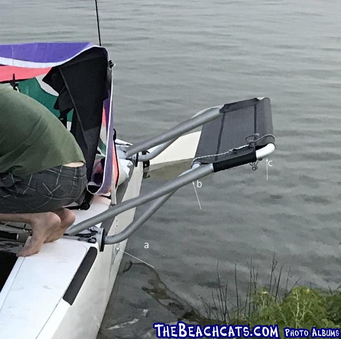

I have suffered a failure of one of my 6.0 NA wing seats. It failed right at the point of which the seat comes out of the crossbar. I had it repaired. Alum welder inserted 1"x3" alum roundstock at the point of failure and rewelded it. It looked good, but failed again in the same place.
Looking forward, after getting it repaired I'd like to further reinforce it. I think adding 4 additional tubes one at each corner from the seat to the cross bar is my best course of action. Can anyone confirm it would be suitable to drill the cross bars for pinning?
Any thoughts on this subject matter would be appreciated.

Please add some pics as a reference and i will comment and show examples of what the fabricator did to minimize these issues on my wings -

Sorry for the confusion and thanks for the help in advance. The break is at 'A'. and im looking to add a tube from 'B' to my brothers big toe on that cross bar I mean. That would be one brace and I would add 3 more at the other 3 mounts. 2 per side...
Make sense?

yes makes sense
I have photoshoped in an alum tube from B to A so i can better picture what your saying and how it looks
yes i think this would help reduce the stress/wear/failure at that bend in "a" in the future (but how will you mount it? - this needs to be a very secure and reinforced connection or you will wear on the beam and worm holes into it )
on my wings , i had alum compression tubes welded into my beam where the bolt goes through (this is where my wings pivot up and in for transport) drilled 1 size bigger than the bolt, then i ordered delrin inserts/bushings/sleeves from mcmaster car. these isolate the bolt so there is no wear and no rust possible.
https://www.mcmaster.com/bushings (ps i am not 100% certain this is the actual bushing i used but looks like it)
- Registered: Mar 19, 2004
- Last visit: Sep 03, 2025
- Posts: 968
A brace from the top of the wing to the crossbar would certainly stiffen up the wing, but it’s going to be a bit cumbersome and make installing/removing the wings less convenient. Doesn’t seem like you have too many options at this point, unless your fabricator can make an entire replacement wing tube section from a thicker wall tube.

Your wings look stout! I like the hiking strap. That's a good thought on wallowing out the crossbeam. Ill try and come up with something. As for the cumbersomeness, I'm not too worried about that. They're already pretty difficult to install. Pinning or bolting the extra brace will be the easy part. Thanks for the help guys. I'll report back with the results.

I’m thinking 1/8” wire rope on a turn buckle that you would tension on installation. From b or c to cross beam. -
- Registered: Jun 18, 2019
- Last visit: Oct 20, 2019
- Posts: 13
Solid strut would get loose as soon as the pins “wallered” out a little and it be tough to tension them initially anyway. -

I was thinking about some vecrtran - but not sure where on the beam to secure it -

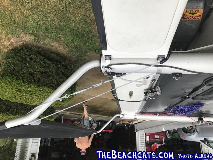

another idea for you:
look at my wing on the beam end
fabricator designed this to be a beam 1/2 cover (cup) that is pinned into place
meaning: when the wings are folded down from transport position: the 1/2 cover fits over the top 1/2 (give or take) of the beam (very good fit). i then put a simple pin in it (a 7"ish ss pin with an eye on one side) that gets secured with a little bungee loop (that is through the eye)
so you could weld or even bolt (so it can swing) an arm from "B" that the other side ("a") "cups" your beam.
a small hole drilled horizontally through this cup and your beam can be bolted (loosely) or pinned as mine is \
this would give you the needed support on the arm's "a" point" (and add less flex in the entire seat setup)
my setup the weigh pushes the cup onto the beam so there is little or no wear at this location
your setup would have lots of "pull" on it at the bolt/pin so i would still consider using a sleeve like i show above to spread out loads (rust isn't really an issue since most don't leave the wings out all the time unless stored outside mast up)
Edited by MN3 on Aug 02, 2019 - 04:17 PM. -

looks good except that hook
it will not be your friend if you stuff your boat and get an arm or leg (or face) in there
i would use line to lash it vs hardware, but i like where you went with this -
- Registered: Aug 10, 2010
- Last visit: Jan 07, 2022
- Posts: 356
I actually crimped that hook. so its captive around the cable. Just need to loosen turnbuckle all the way to remove.
I thought about using some Dyneema or something instead, but I've never worked with it. Next set of trapeze wires will be synthetic for sure. For education's sake.
