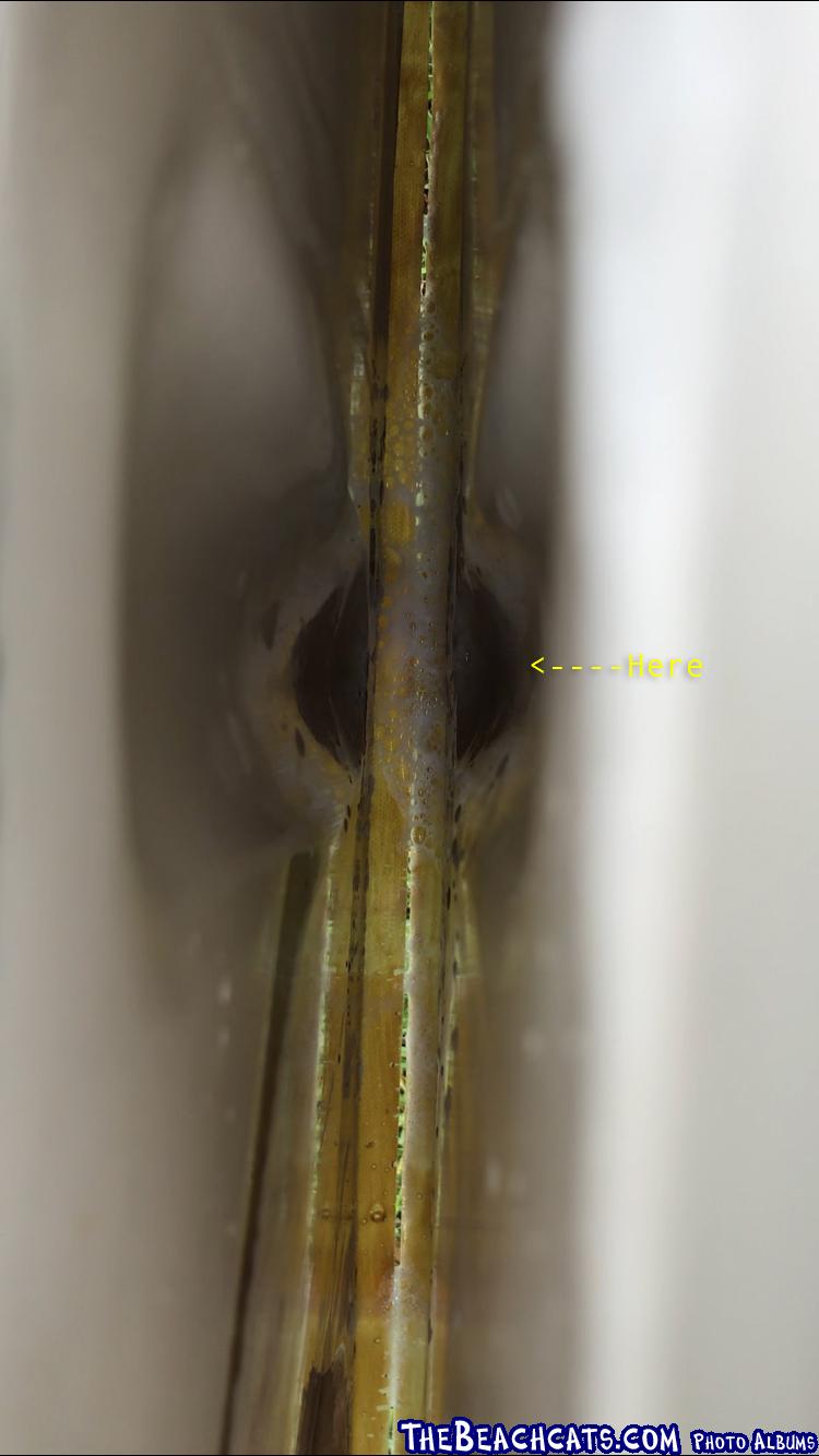

  • it's not in the "back" of the well
    it is on the side (towards the inside of the boat)
    looking down the well it is about 4" above the bottom lip (which has a gasket on it)
    it is in a curved area of the well (i assume these curves are there for added strenght - the well walls are crazy thin like Sam mentioned above)
    the curve area has a "bowl" shape to it (think of a 1/2 baseball) and it is inside the curve - that is where the real challenge is to sanding it is out of reach and in a spot that a flat item wont be able to get to
    This image is looking down - the yellow strip in the middle is the gasket with a bunch of soap suds on it (this is from a phone video i shot while checking for leaks)
    https://www.thebeachcats.com/gallery2/main.php?g2_view=core.DownloadItem&g2_itemId=131803&g2_serialNumber=3
