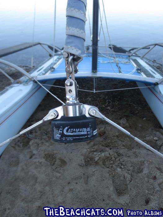

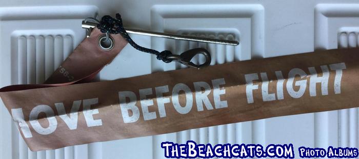

    Fast forward I now have a 4” bit of spyder line tied to a snap on one end, the other attached to a4” pin, the same one I use to secure the mast to the ball when stepping mast. Insert the pin into a hole in the tang of the drum, then snap the clip onto a bridal wire. Takes 3 seconds, & the drum is locked.

    no chance of a wind storm vibrating it out?
  • Quoteno chance of a wind storm vibrating it out?
    If it comes out, my Cat, & probably the house are also gone!
    The pin goes into the hole just above where the bridals attach to the drum. The clip goes on to one of the bridals. The line is shorter than the pin, therefore prevents the pin from coming all the way out. I invented this because with the Cat sitting on a lift, I cannot reach up to the clew to tie a safety line. I could stand on one hull. lean out & just reach it, but that was a precarious operation, & when i had the 10' wide Mystere, impossible. I also use it on the N5.7
